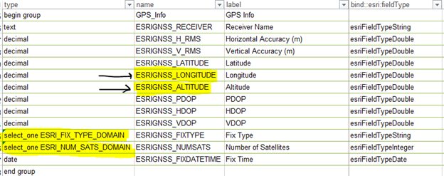

Next set of steps will require that you create the following fields within your survey. I have started by using “begin group” followed by a series of fields that are contained within the File GDB (please see the first screenshot below) created during the High Accuracy setup. There are a few different ways to achieve this, but I liked pulling the alias and field names from the python script and pasting “as values” within the required {name} with their respective {label} columns of your form.
PLEASE be sure to set the {bind::esri.fieldType} as shown above and for each of the text questions set the {bind::esri:fieldLength} to 75.

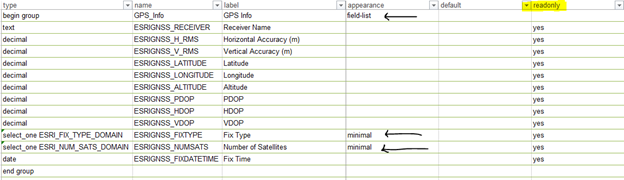

Within the second screen shot you can see that I have made these questions read only as I do not want the personal filling out the survey form to alter the GPS metadata.
PLEASE pay attention to the two highlighted fields that have arrows pointing at them as they will play a MAJOR role in using the High Accuracy GPS data from the GNSS receiver to plot your Survey Form’s location. This will be achieved within the custom URL schema that will pass the values of these two fields within a “center” command.

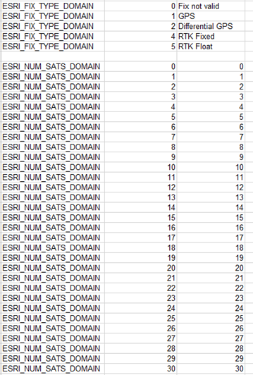

Also note, there are two “select_one” questions that will need to be setup on your choices tab also. Please see the third screenshot below for the setup of the “select_one” choices for both questions.

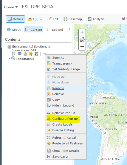

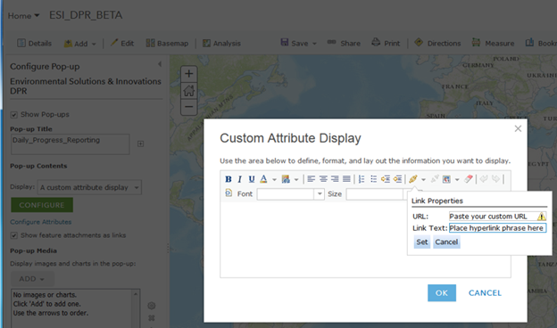

Once you update the above custom URL to contain your survey form id, then you will need to enable a custom pop-up window within the web map for the “dummy” hosted feature data set layer. Within the following example you will see that I have a layer that is being used for Daily Progress Reporting (DPR). You will need to click on the three dots, then select {Configure Pop-up}.

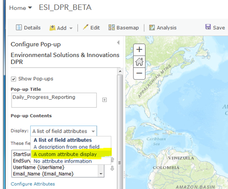

NOTE: within the {Configure Attributes}; I typically turn off all attributes if I have used a previous feature class that contains data fields. There are times that I have allowed users to enter some information and pass it into my form through further manipulation of the custom URL.
Next you will need to select “A custom attribute display” under the {Pop-up Contents} section and then click on the {CONFIGURE} button.
Within the new dialog window named {Custom Attribute Display} click within the white area below the Font, then you will see the gold chain (hyperlink icon) become available, click on the arrow next to it for the next dialog box. You will want to copy and paste your updated custom URL within the empty box next to the word {URL:} Then you will want to add some text within the empty box next to the words {Link Text}. Then press OK, OK and then save your web map.

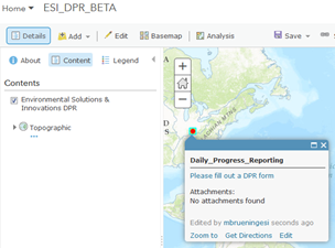

Now when you go into the Collector app web map; there could be a need to refresh the web map within Collector, there will be the ability to drop a dummy point. Submit the point, then click back onto the point, and the pop-up will have the {Link Text} that will open your related Survey123 Form while pushing the High Accuracy GPS data into your form.
