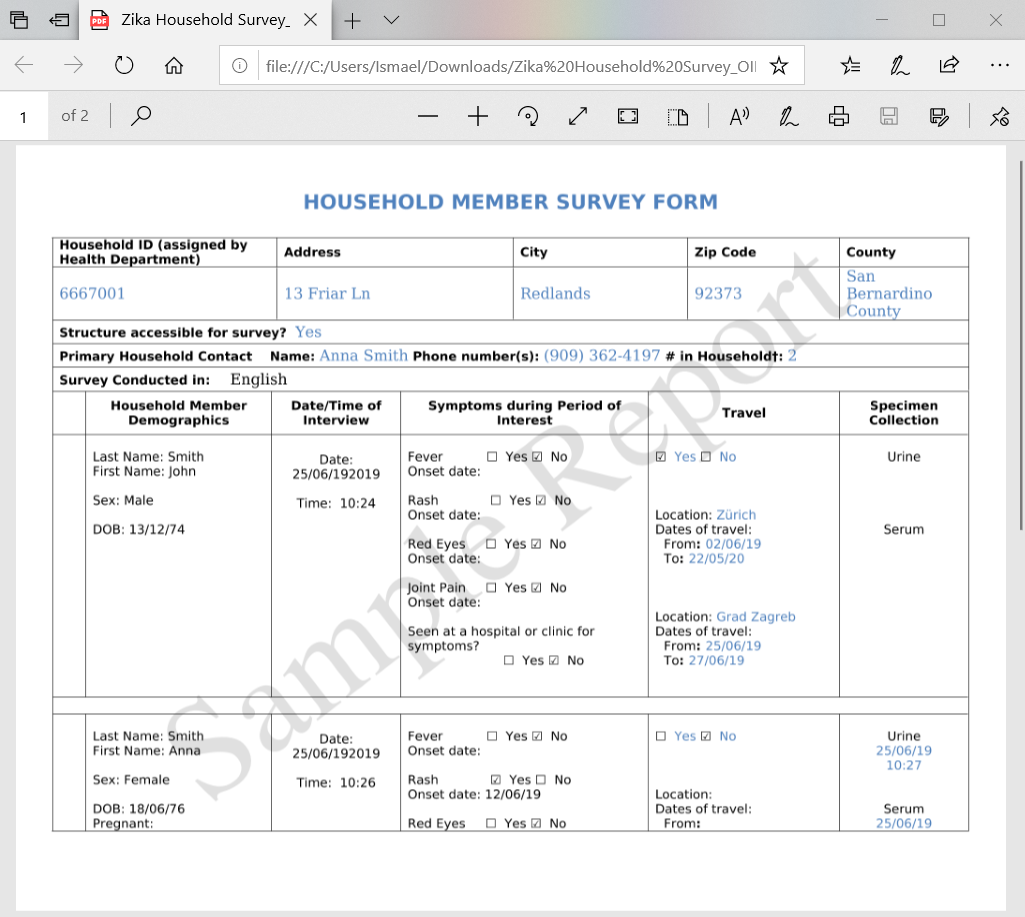

Many of you requested that we add a new preview option so you can generate test reports for free. Authoring good report templates is an iterative process and it is common to generate many test reports before a template is ready. The report preview output consists of a watermarked PDF file. Here is an example:
This new option to generate a preview of the report is only available to the owner of the survey. Once generated, the download of your report preview will start automatically in your web browser.
Please note that selecting content in report PDF previews is disabled.

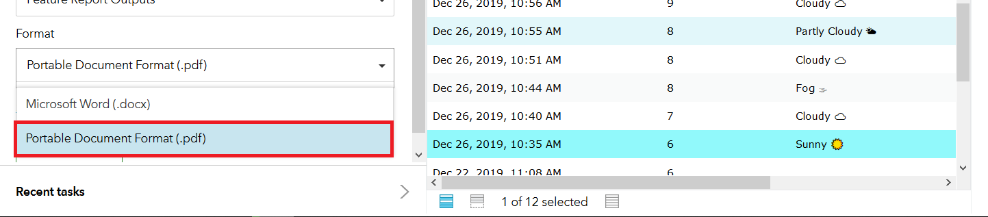

PDF support added to Survey123 Reports
You can now save your Survey123 reports in PDF format. A new Format drop down has been added, as shown below, so you can choose PDF as your output.
If you plan to generate reports in PDF format, it is highly recommended that you embed fonts within your Microsoft Word template as described in the Embed fonts in Word or PowerPoint - Office Support help topic. If you do not embed the fonts, your report outputs may not look exactly the same as your template.

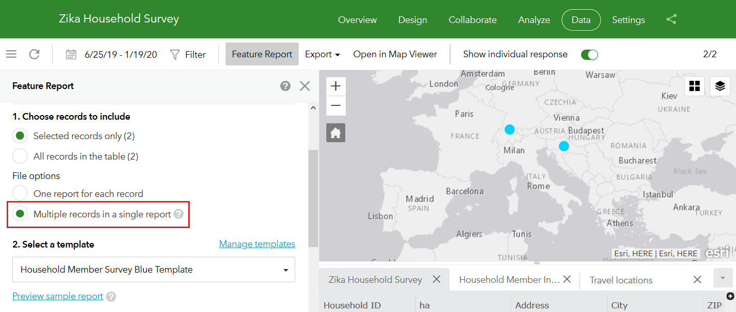

Merge multiple reports into a single file
When creating reports in bulk, you can now also choose to merge all reports into a single file. If the collection of feature reports you want to merge is larger than 512Mb we will automatically split your job into multiple files.
