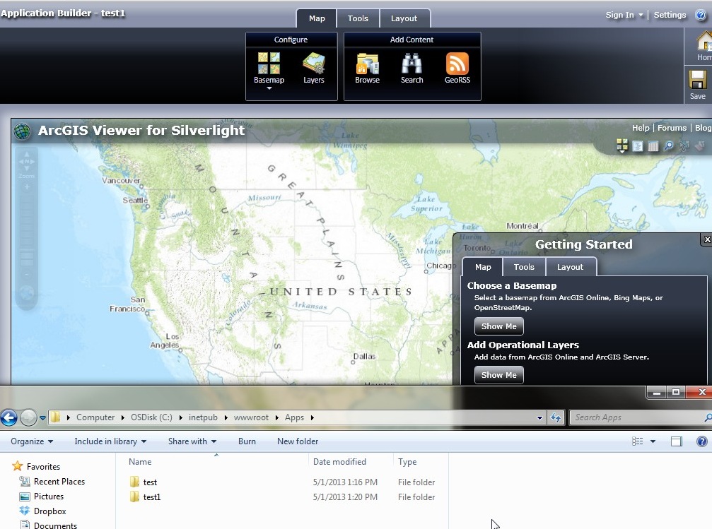

- On Computer B, create a dummy application in the Application Builder and name it "test1" as in our example below.
- Deploy and save the application.
