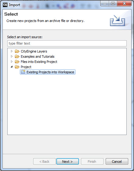

1. Go to File > Import...2. Select Project > Existing Projects into Workspace.

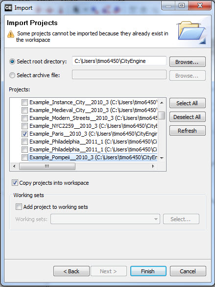

3. Select the root directory and then select the project to be imported.
You can also choose the option to copy the project data over. If this option is not selected, the project content will be linked into the workspace.
Once the import process completes, the projects folder will display in the navigator for the current workspace. If it does not show, you may need to refresh the worksapce (File > Refresh Workspace).
