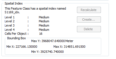

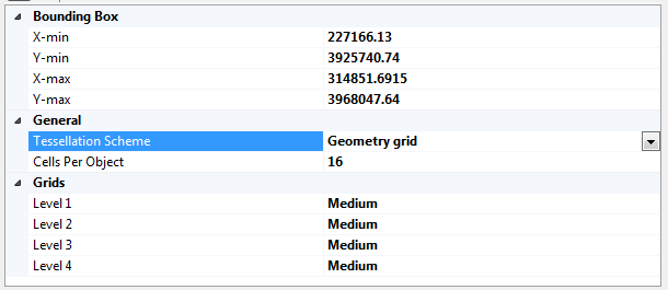

Out of the box, ArcGIS creates a spatial index with 16 Cells Per Object with all four levels set to Medium Grid Levels.
Notice how the storage type is Goemetry, which some of you are discovering is the "New" ESRI default storage format.
