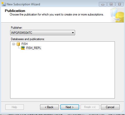

Select the Local SQL Server that hosts the FISH database as the Publisher. You should then see this:

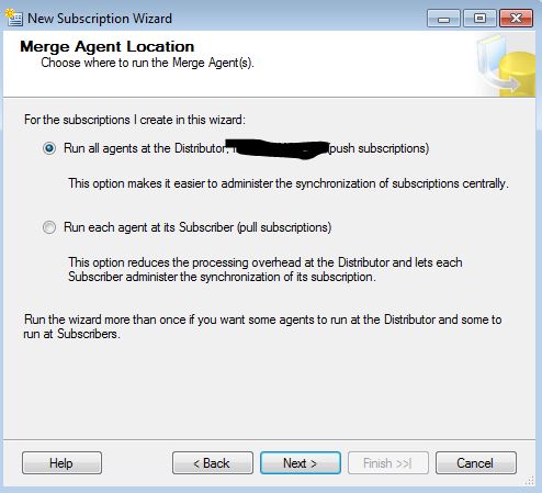

I prefer to run all agents at the Distributor as this a) keeps the overhead on my server that has the capacity to do so and b) makes managing many subscriptions a lot easier (one interface).

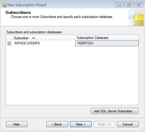

Select the Subscription Database as the one you created on the remote server to host the replicated feature class.

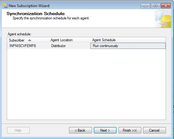

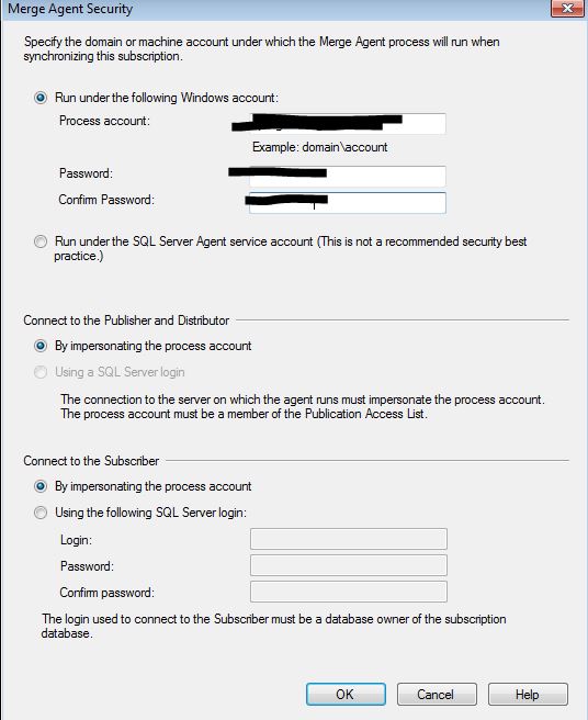

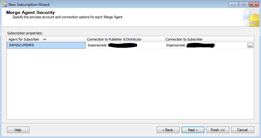

In the Agent Security, you SHOULD use the SAME domain account you used to create the Publisher Agent. Good luck with another security model....and set the agent schedule to run continuously.
