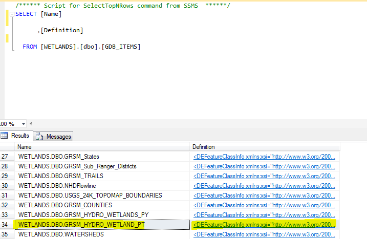

There's a quicker and easier way to resolve this issue. I spend a lot of time editing metadata in its native XML (faster, and I can automate things easier), so why not edit a feature class definition, which is also in XML? Feature class definitions live in a XML column (Definition) in the GDB_ITEMS table.
Click on the xml in the definition column, and you'll see the raw schema for the feature class. Look for the name of the attribute that allegedly won't let you delete it:
