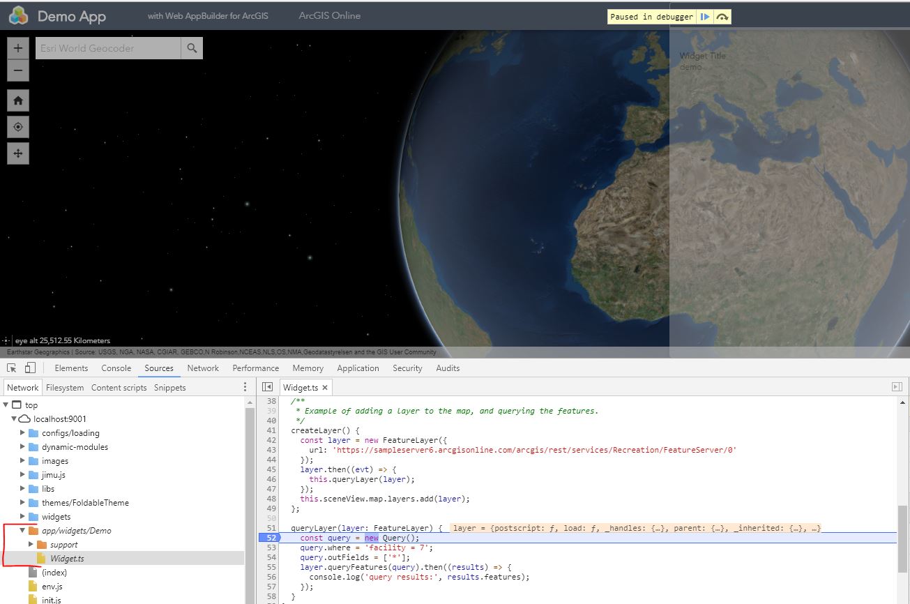

I found it's easiest if you set "inlineSources" and "inlineSourceMap" in your "tsconfig.json" file to true. If not, the path of the sourcemap is often wrong. The TS source shows as a separate file from your main widgets file:
Huh?
