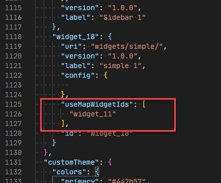

Since the JS API Widget interacts with a Map View, your Experience Builder widget will need the infrastructure to reference a Map View widget within the same Experience app. The easiest way to do this is to create an Experience, add your widget, then go to the config for your working app (server\src\public\apps\Z\resources\config) and set "useMapWidgetIds": ["widget_ZZ"], in the widget config.

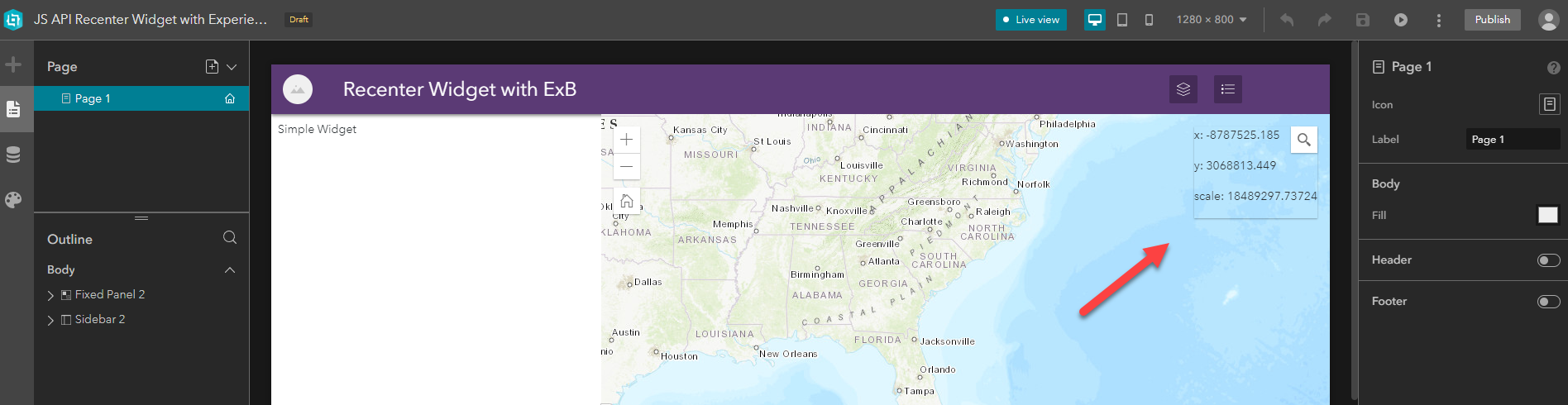

<SPAN class="keyword token">import</SPAN> <SPAN class="punctuation token">{</SPAN> JimuMapViewComponent<SPAN class="punctuation token">,</SPAN> JimuMapView <SPAN class="punctuation token">}</SPAN> <SPAN class="keyword token">from</SPAN> <SPAN class="string token">"jimu-arcgis"</SPAN><SPAN class="punctuation token">;</SPAN><SPAN class="line-numbers-rows"><SPAN></SPAN></SPAN>If successful, you'll see the info box in the top-right corner of the map when you add your widget to an Experience (and configure it manually to reference a map):
