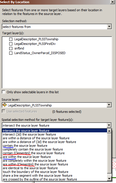

Although DE-9IM is the basis for 2D spatial predicates/relations in many geometry libraries and geospatial applications, there are two overlay types for the Select Layer By Location tool where Esri's default implementation differs from Clementini: Contains, Within. In both cases, the default or unqualified overlay type implies Esri's definition (blue underline) while the Clementini definition (red underline) is handled through qualifiers.
So how does the Esri definition of Contains and Within differ from the Clementini definition? Forgoing mathematical notation and illustration matrices, the difference boils down to how boundaries of geometries are handled. For example, geometry a that is entirely on the boundary of geometry b is considered within geometry b using Esri's definition but not within geometry b using Clementini's definition. Let's create simple polygon and line features to demonstrate:

Executing the Select Layer By Location tool using both definitions of Within:
>>> arcpy.SelectLayerByLocation_management("line", "WITHIN", "polygon")
<Result 'line'>
>>> arcpy.GetCount_management("line")
<Result '1'>
>>> arcpy.SelectLayerByLocation_management("line", "WITHIN_CLEMENTINI", "polygon")
<Result 'line'>
<Result '0'>So far, so good. Beyond the fact that Esri's default definitions of Contains and Within differ from most other geometry libraries and geospatial applications, including the OGC simple feature standards, at least the results match the sparse documentation available online.

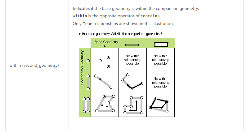

Confused yet? Just wait, the fun really starts when we dive into the ArcPy Geometry Classes because the documentation goes from weak to really weak. The only references to OGC in the ArcPy Geometry Classes documentation are for the WKB and WKT properties, and there are no references to DE-9IM or Clementini. Let's take a look at the documentation for the within method:
So, the geometry is within another geometry if it is within that geometry. Got it. Oh wait, are they asking me whether a geometry is within another geometry? Although none of the illustrations captures a situation that differentiates the Esri and Clementini definitions, the lack of any reference to OGC, DE-9IM, or Clementini makes one think it is Esri's definition being used. Let's check:
>>> line.within(polygon)
False
Ouch, that smarts. It is pretty clear there is a lack of consistency with how certain spatial operators are implemented in various parts of Esri's software, but the worst part is the documentation doesn't even point it out. Users are left to infer, and likely incorrectly at times, how the software works instead of being informed about how it works. Caveat utilitor.
