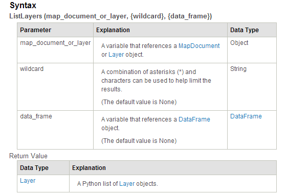

Let's get a couple examples on deck. I will start with a Syntax screenshot from the ListLayers function of the arcpy.mapping module, and

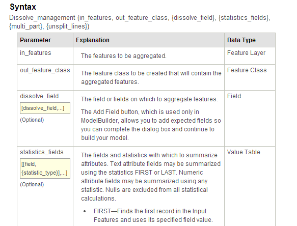

follow it up with a partial screenshot of the Syntax for the Dissolve tool in ArcGIS Desktop.

I posted the Syntax screenshot from the ListLayers function first because 'Data Type' in the ArcPy section is consistent with what a vast majority of people think when discussing programming/scripting and data types. For example, the data type for the map_document_or_layer parameter is listed as Object, and the explanation column states it needs to be a variable with a reference to a MapDocument or Layer object. The wildcard parameter is listed as being a String, and the data_frame parameter is listed as being an arcpy.mapping DataFrame object.
It is interesting to note the data_frame parameter has a specific data type given while the map_document_or_layer parameter has a generic Object data type given. My guess is that since the former parameter accepts a single object type while the latter accepts two different object types, someone made a judgment call to go with the more generic Object data type instead of listing all of the applicable object types in the Data Type column. Fair enough.
As mentioned above, the formatting style for Syntax is identical between the ArcPy and Tool reference sections of the ArcGIS Help, right down to the column headings. Whereas 'Data Type' in the ArcPy section is consistent with general programming usage, 'Data Type' in the Tool reference section means something a bit different, a bit muddled in my opinion. For users just starting out with Python and ArcPy scripting, looking at the Dissolve Syntax table might lead them to believe the in_features parameter accepts a Feature Layer object and the out_feature_class parameter accepts a Feature Class object. Unfortunately, they would be wrong, or wrong enough to be confused. Let's see if some sample code gives any clarification.

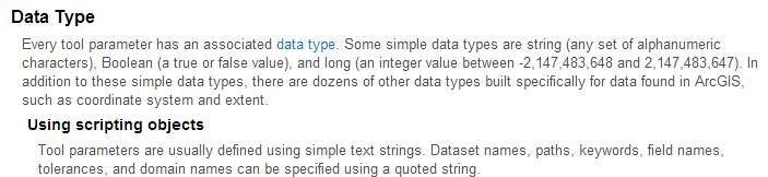

That's interesting, every parameter in the sample code is a string or list of strings. If the out_feature_class parameter has a data type of Feature Class, why would the sample code be passing it a string? Are we missing something? Maybe the Understanding tool syntax help page has some answers. Looking at Data Type:
The first paragraph makes sense, i.e., there are simple data types like strings and integers and more complex data types like arcpy objects. The second paragraph is where things get interesting: "Tool parameters are usually defined using simple text strings." Huh, so parameters have data types but all data types are 'usually defined using simple text strings.' A string is a string but so is a Feature Class. Interesting. If one follows the data type link visible in the screenshot above, a bit more explanation can be found in the Data types for geoprocessing tool parameters page.
