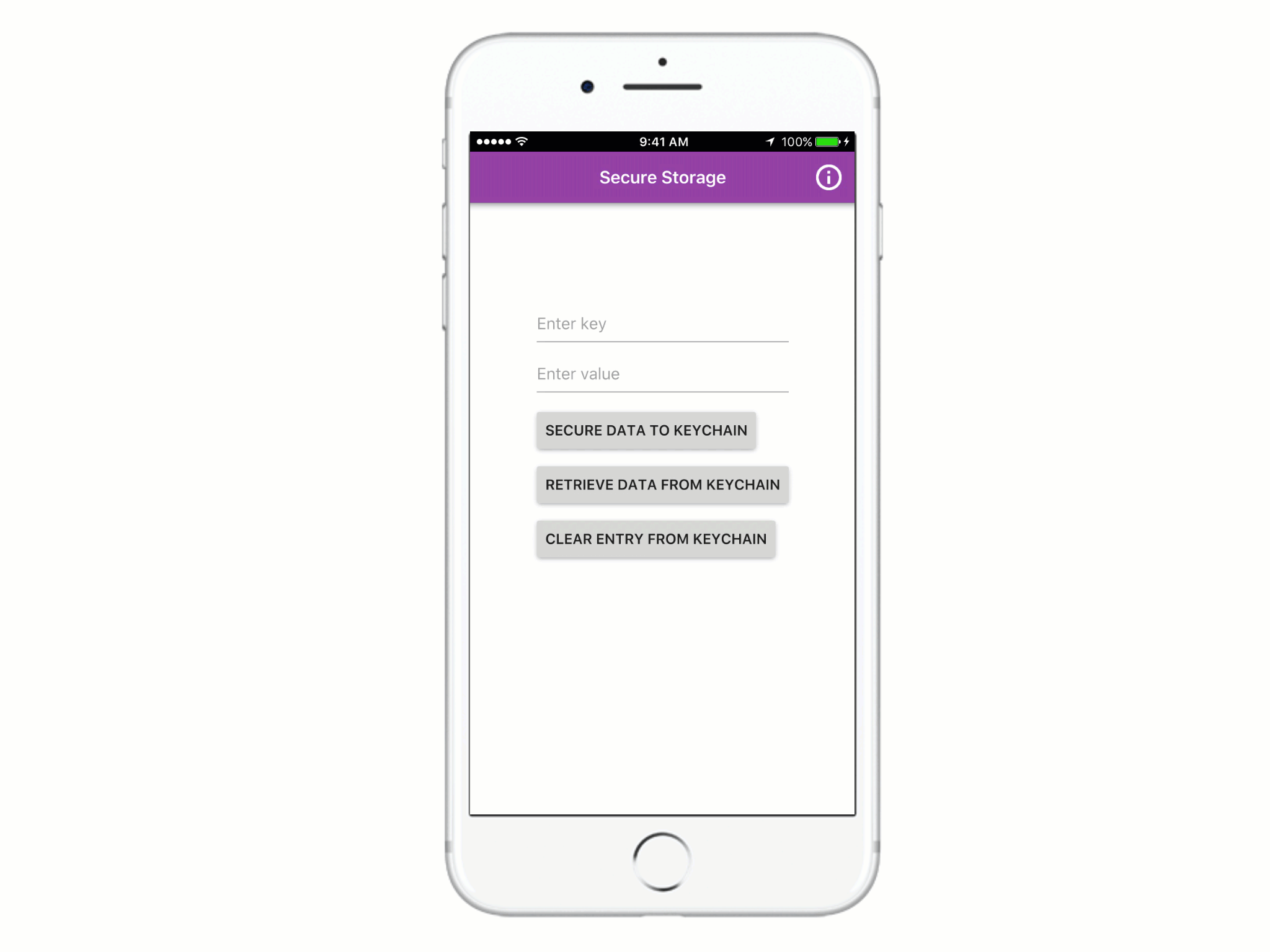

We have provided a sample to help you learn how to use Secure Storage plugin. It is available in AppStudio Desktop 2.1 via "New App" dialog:
- Open AppStudio Desktop
- Click on the New App button
- Search and select Secure Storage sample
- Click on the Create Button
