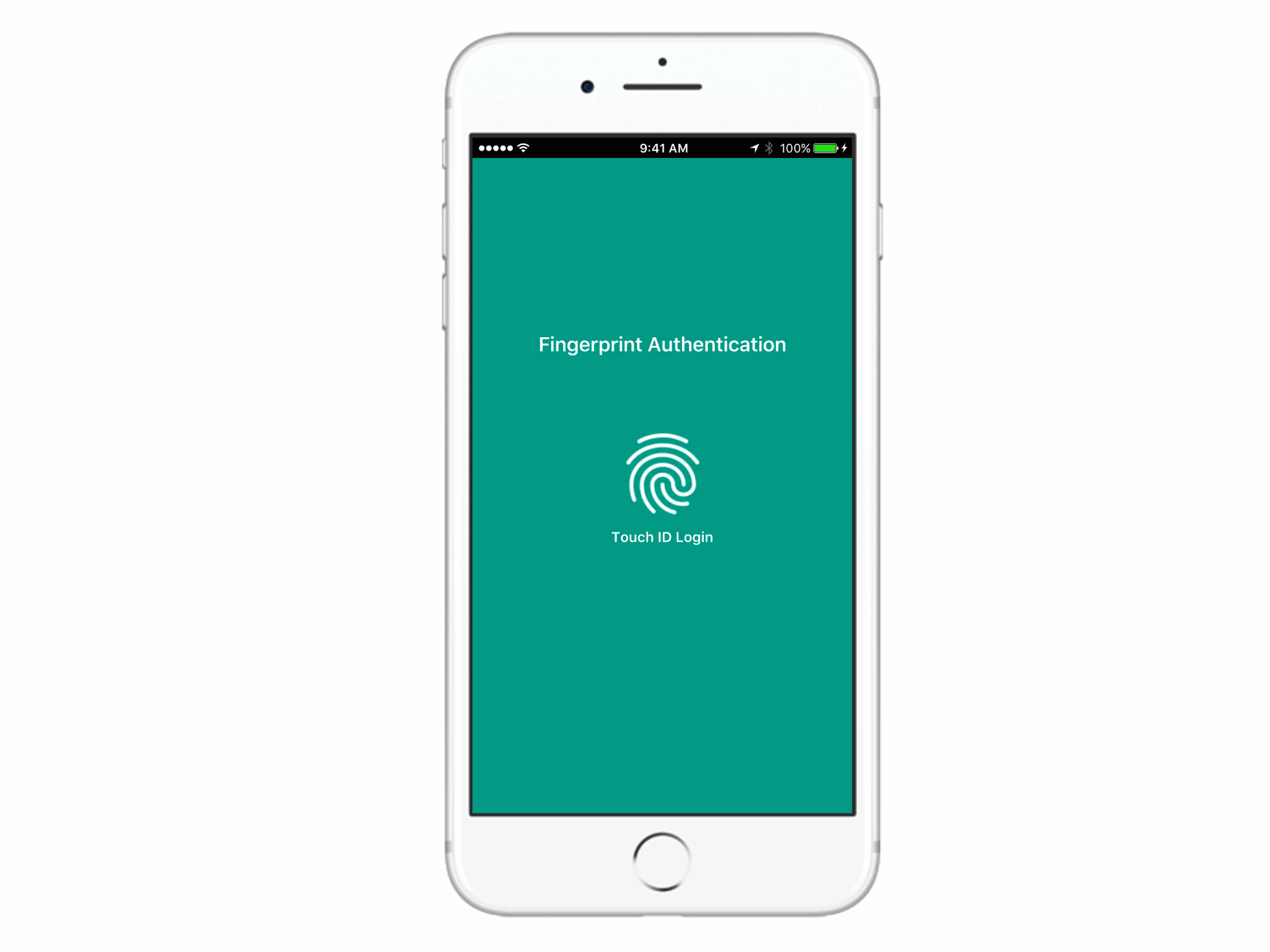

How to implement fingerprint authentication
This step - by - step tutorial will get your familiarized with BiometricAuthenticator and help you get you started with the fingerprint authentication.

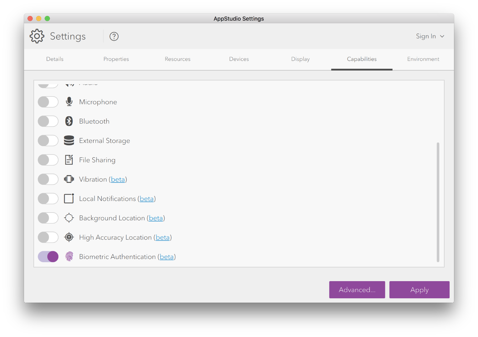

Enable Biometric Authentication capability, to do this:
Open Desktop > Select your app > Click on Settings > Capabilities > Enable Biometric Authentication

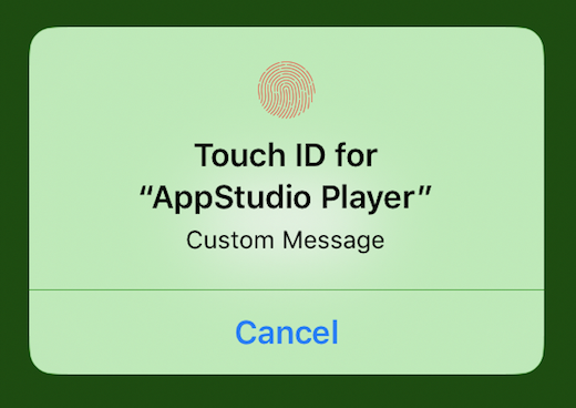

Add a custom message on the fingerprint dialog
Button {
anchors.centerIn: parent
text: "Touch ID"
onClicked: {
BiometricAuthenticator.message = qsTr("Custom Message")
BiometricAuthenticator.authenticate()
}<SPAN class="line-numbers-rows"><SPAN></SPAN><SPAN></SPAN><SPAN></SPAN><SPAN></SPAN><SPAN></SPAN><SPAN></SPAN><SPAN></SPAN><SPAN></SPAN><SPAN></SPAN></SPAN>Step 6
Display fingerprint status message with the BiometricAuthenticator signals. When a fingerprint is successfully authenticated, the accept signal will emit and “Success” text will print out. When fingerprint fails to authenticate, the reject signal will emit and print out "Fail"
