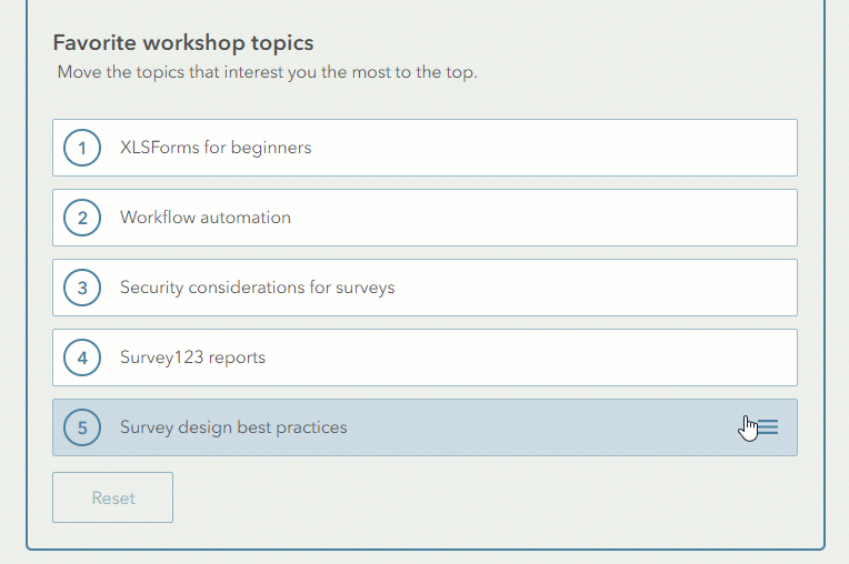

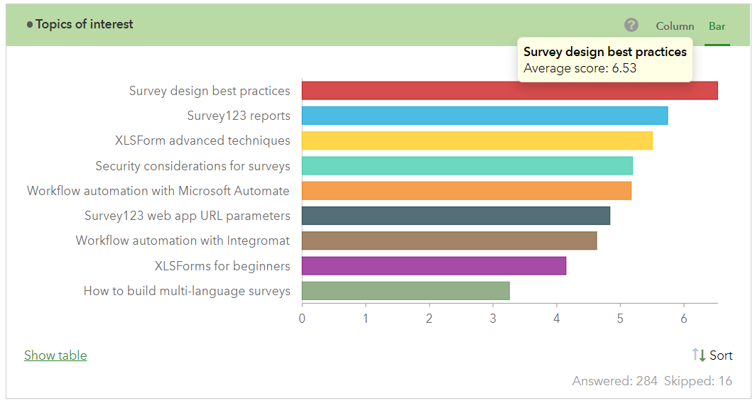

Ranking question
The new ranking question lets you add sortable lists to your smart forms. This question type is ideal when you want users to compare choices and place them in order of preference. In the animation below we created a list of candidate topics for a Survey123 workshop and asked respondents to sort the topics in order of preference. By simply dragging elements in the list, their position can be changed.
Choices in the ranking question get a score based on the position chosen by the respondent. You can visualize the results on the Survey123 website. If using Survey123 Connect, you can also store the score given to each choice through an XLSForm expression.
You can add ranking questions to your surveys in the Survey123 web designer as well as in Connect. To learn more details about the Ranking question, see https://community.esri.com/groups/survey123/blog/2020/10/16/survey123-tricks-of-the-trade-ranking-question-and-choice-randomization.

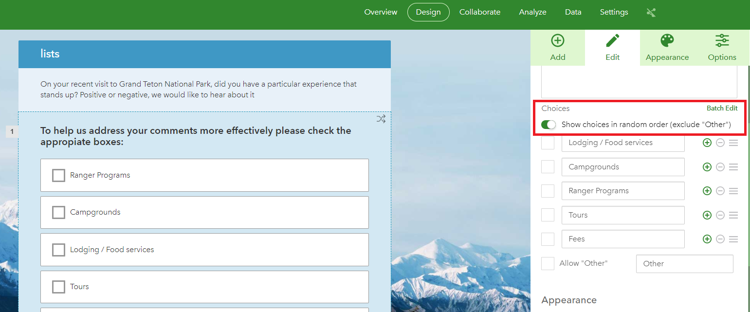

Choice randomization
With this update, you can now present choices in a list in random order. This is important in situations where you want to reduce the bias that may be introduced by having the choices in a fixed order. You can randomize choice order in dropdown, checklists, horizontal and vertical lists as well as in the new ranking question type. The next screenshot demonstrates how you can randomize the order of choices in Survey123 web designer.
The example below shows the XLSForm syntax to enable randomization for the new rank question. You can also use randomize=true in the parameters column for select_one and select_multiple questions.
type name label parameters
| rank topics | topics_ranked | Favorite topics | randomize=true |

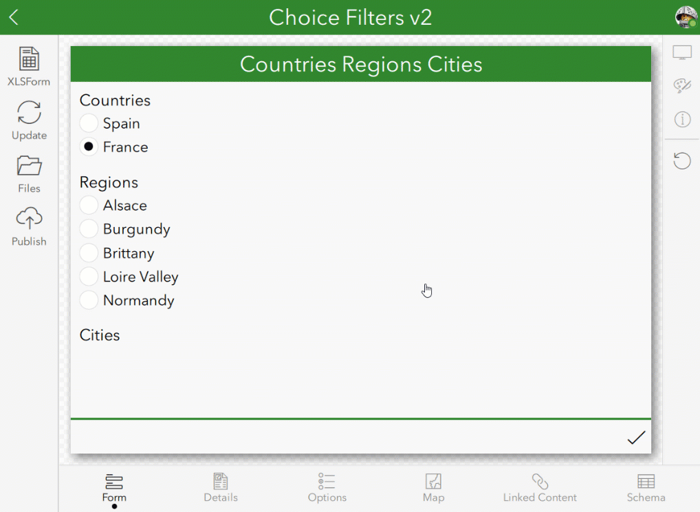

Choice filters
A choice filter is an advanced smart form authoring technique that allows you to control the content of a list based on previous responses in your form. Choice filters can be defined through XLSForm syntax in Survey123 Connect. The example below shows how three lists can be chained together: Countries, Regions and Cities. Note that the list of regions is controlled by the country choice, and the list of cities is always filtered for the selected region.
Choice filters are extremely useful when working with very long lists. They help speed up loading time in your forms and simplify the user experience.
While you may already be familiar with choice filters, this release introduces key enhancements making this capability more powerful than before. Starting with this release you can:
- Apply choice filters to checklists (select_multiple questions).
- Apply complex XLSForm expressions to your choice filters.
To learn more about choice filters and the new features introduced in this release, check out https://community.esri.com/groups/survey123/blog/2020/10/16/survey123-tricks-of-the-trade-choice-filters.

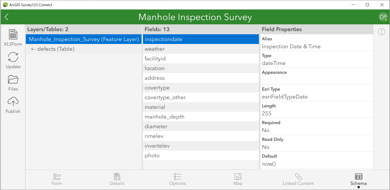

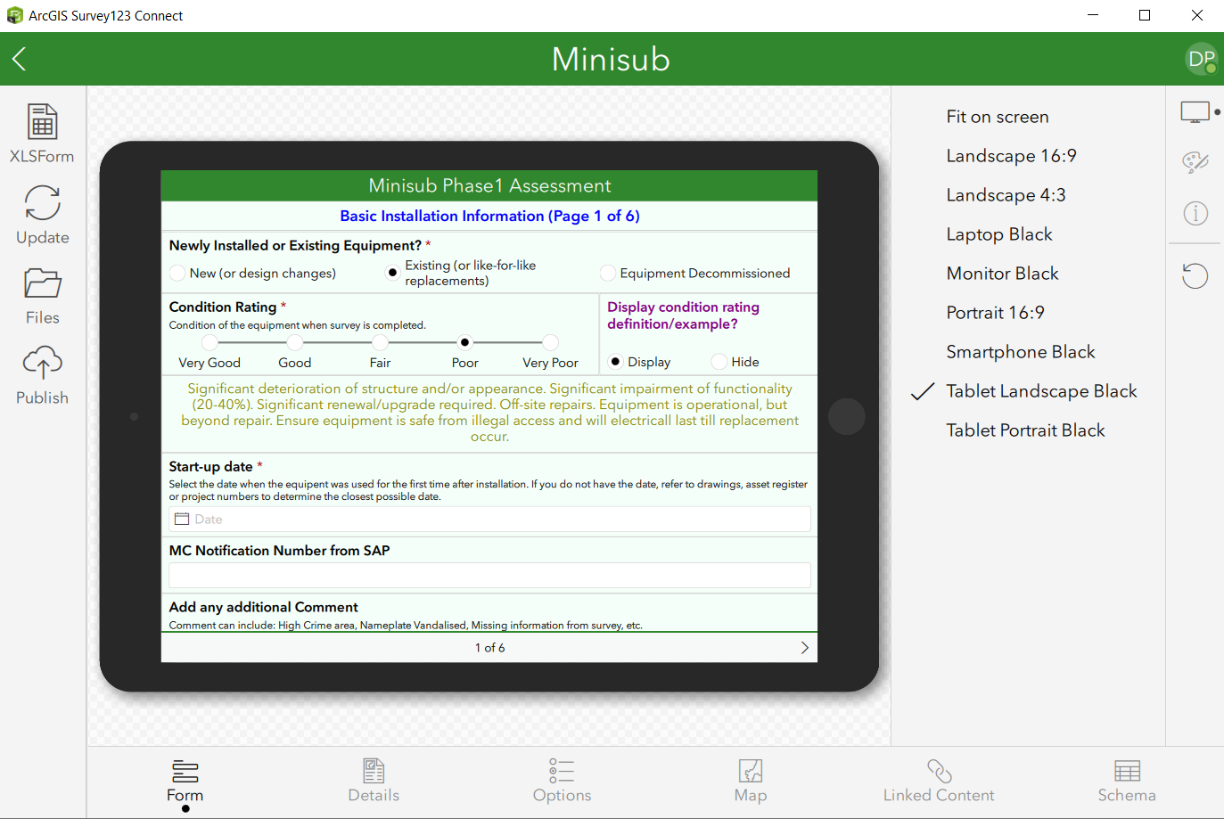

Refreshed Survey123 Connect UI
The latest build number for Survey123 Connect is 3.11.123. You can download it directly from the Microsoft Store. It is also available for Mac and Linux. You will notice right away that with this new release the look and feel of Connect has changed. We have rearranged the location of some toolbars and redesigned some dialogs, but the fundamentals of Connect remain untouched. You will get used to the new look pretty quickly. Do not be afraid of the transition.
This new layout design is the foundation to some additional features in Survey123 Connect for the near future, so you will see some more work coming up in the next releases of Survey123. In this update, I want to highlight the new redesigned Schema preview dialog (shown below). It is much cleaner than before and accommodates some issues (BUG-000133196) you reported in past dealing with long field and layer names.

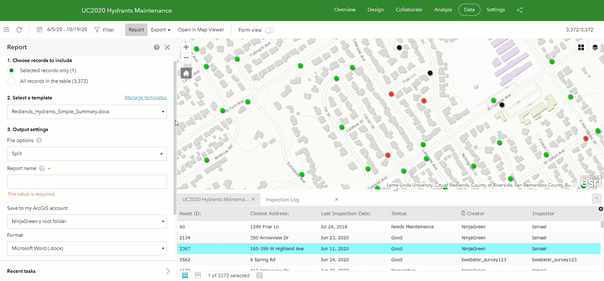

Survey123 Reports
Survey123 includes powerful report capabilities. You can create your own custom reports on top of Survey123 data and generate high quality DOCX and PDF documents that include tables, maps, photos and much more. To learn more about Survey123 reports, see Report templates—ArcGIS Survey123 | Documentation or the https://community.esri.com/groups/survey123/blog/2019/07/23/understanding-survey123-feature-reports and https://community.esri.com/groups/survey123/blog/2020/08/26/survey123-tricks-of-the-trade-summary-sections-in-reports blog posts.

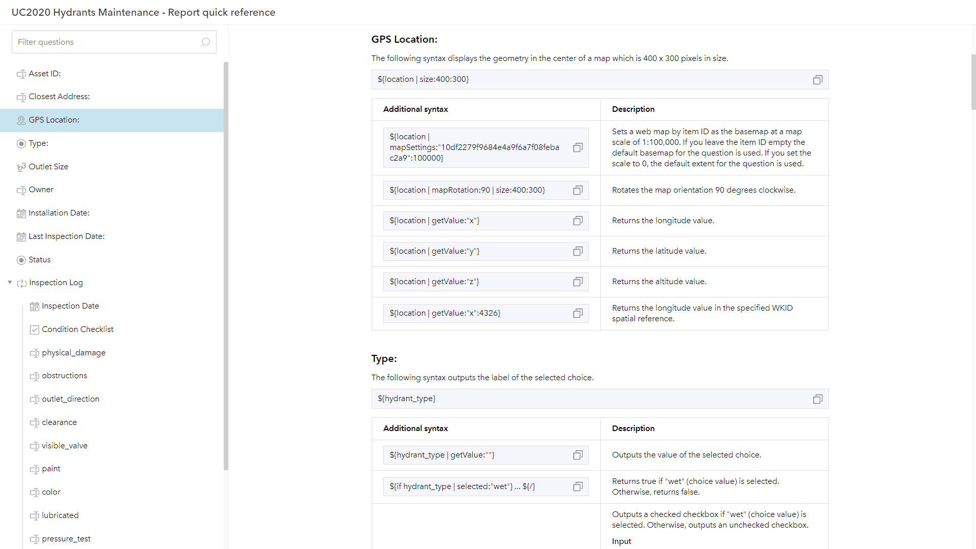

New online report syntax quick reference
Survey123 report templates are created in Microsoft Word. In this release, we have built an new experience to help you learn the exact syntax you need to apply in your report templates to extract information from your survey records. The animation below shows how you can access this new online quick reference guide.
Expanded Survey123 report syntax
As you will note, the Survey123 quick reference is not a generic help document. It is a live document listing all your survey questions and the syntax you can use to format and modify these questions in your report. Every survey has its own quick reference. You can easily look for specific questions within your survey using the panel on the left, and then learn how you can bring data from that question into your report using the panel on the right. You can also copy report template expressions right from the quick reference and paste it into your template.
In the screenshot below, for example, I selected the GPS Location question in the left panel. The reference lists all the different expressions that can be applied to this question.
If you look carefully at the screenshot above, you will note that the quick reference shows a new map rotation option for the GPS location question. This is new in this release. Combined with variable substitution, this allows you to insert a map into a report and rotate it using an angle from a record's attribute.
For example, the following expression inserts a map in a report, using the geometry from the location question. The map will be rotated using the value from the directionOfTravel attribute.
${location| mapRotation:directionOfTravel}
The following expression also shows a new capability in this release: You can now insert an image into a report from a URL.
${$image | src:imageUrl | size:0:0:longSideSize:longSideSize}
