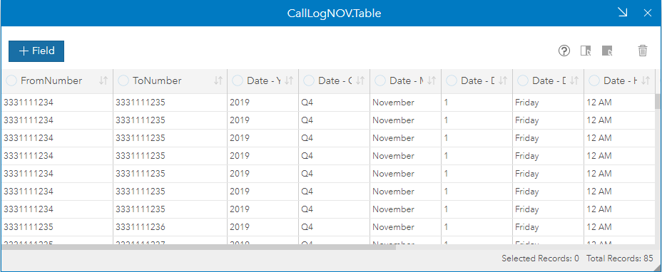

Let's start with something simple: the call log table. In this case, we have combined the call logs from everyone in the suspected syndicate into a single table. Here we have two critical columns—the number that dialed the call (i.e. the Owner), and the number that the call was placed to.
A call log table indicating From and To numbers

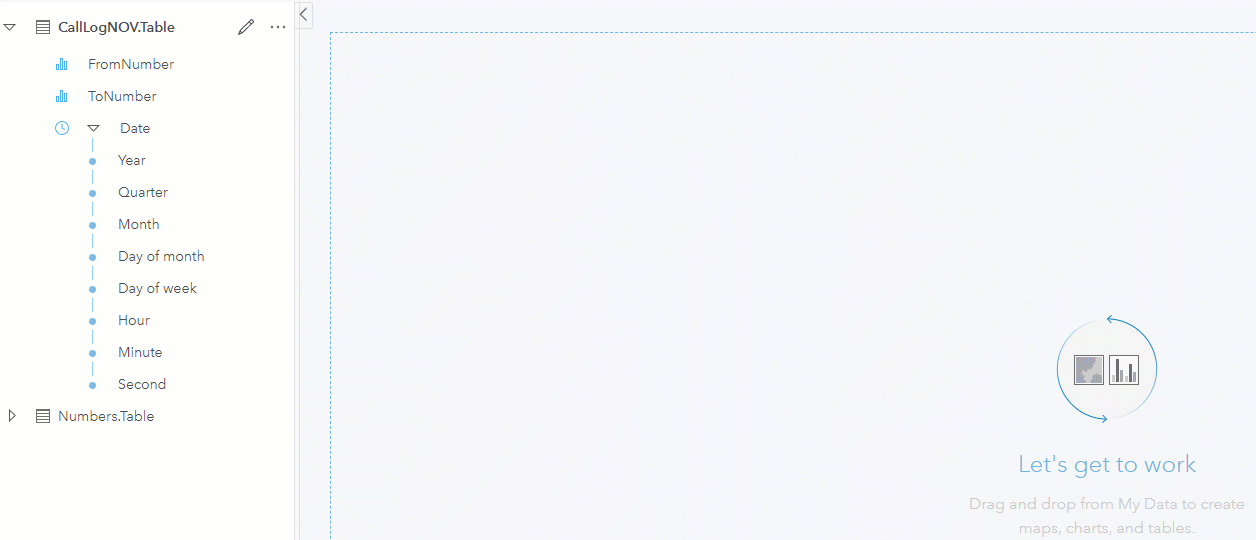

In ArcGIS Insights:
- Select two fields, in this case the From phone number and the the To phone number
- Drag them into the work space

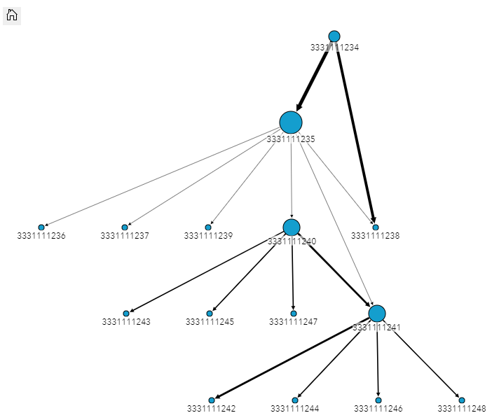

- Hover over Chart and drop the data on Link Chart. If you don't see the Link Chart option, you may need to change your field types to String.
- In the layer options, hold down the shift key and select both nodes. This presents the option to Merge nodes
- Then select a Directed flow and a Hierarchical layout

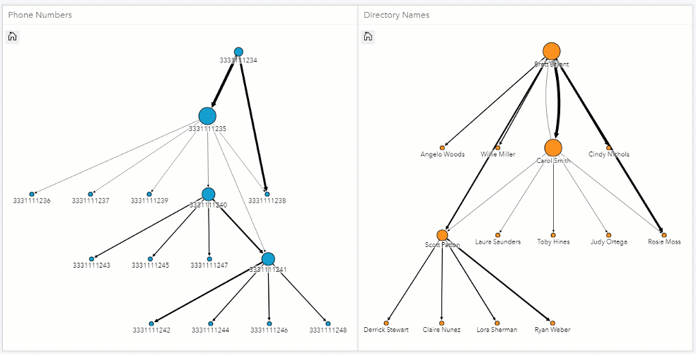

The From and To numbers can be quickly added to a link chart to outline the structure of the calls
The chart below is already impressive. We see structure in the call logs, with certain numbers having more influence than others. For example, phone number (331) 111-1234 seems to be at the head of the organization, but phone number (333) 111-1235 makes connections to everyone else.
The resulting link chart from just the call logs

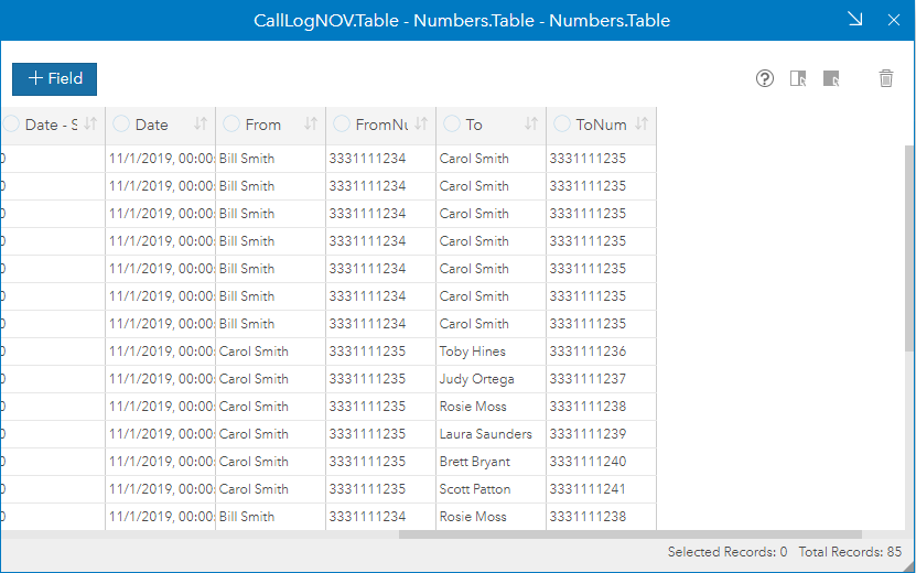

Our next step is to pair the From and To numbers with those numbers' owners in the directory so we can ultimately say "Bill called Carol" rather than "(333) 111-11234 called (333) 111-1235."

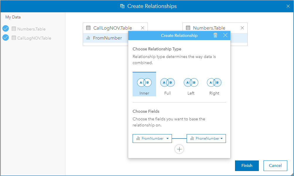

In the Insights Create Relationships window, select the Call Log table, then select the number directory. In this first step, join the FromNumber field to the phone number field in the directory. As a result, a new field will be added to our call records indicating who made the call.
Join the From number to the directory to get the name of the person who placed the call
Now we repeat the process above, but using the output of the last join. This time, we are going to join the ToNumber to the phone number in the directory.
Join the To number to the directory to get the name of the person who received the call
The result is below, a new table containing the FromNumber, To Number, Caller, and Recipient in the call logs. Immediately, this table is more human-readable. But what happens if we take these names and make a new link chart?
The resulting master join table, containing To and From names
In the window below, we follow the same steps as the first link chart, adding the data, merging the nodes, and selecting a hierarchical layout. Immediately our crime syndicate is laid out before us, showing a structure of call logs in an easy to digest format.
The new link chart containing human readable names and accounting for owners with multiple phone numbers

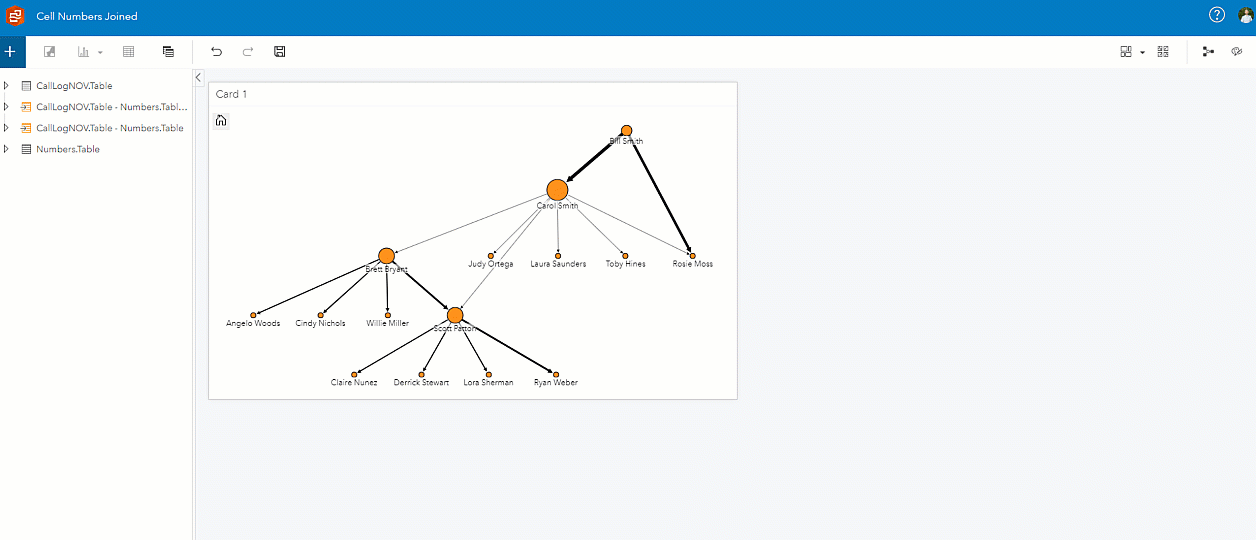

Import future investigations into the same model
[DEEP BREATH]
That was a lot. But the beauty of ArcGIS Insights is that you never have to do it again! By flipping to the model view, you have the option to import new data. This means when you get a new bag full of phones, you just need to import the new call logs and the new directory. The link chart will automatically be generated. While this example only uses a handful of records, you could import massive datasets and achieve the same results.
