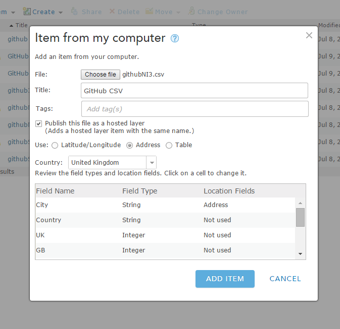

The script outputs a CSV which was then uploaded into ArcGIS Online content pane using a developer account. When uploading the CSV we can set the city column to be geocoded. This allows us to take the address of the city and turn it into a latitude and longitude, in turn allowing us to map the data.
The process asks if you want to review (probably worth while as some points can end up astray). Once this was done, I gained a Feature Service of the data (a REST end point we can get our data from). From here I took this into a Esri Leaflet map (one of Esri's GitHub projects!). The main bulk of the mapping is outlined in the JavaScript code below:

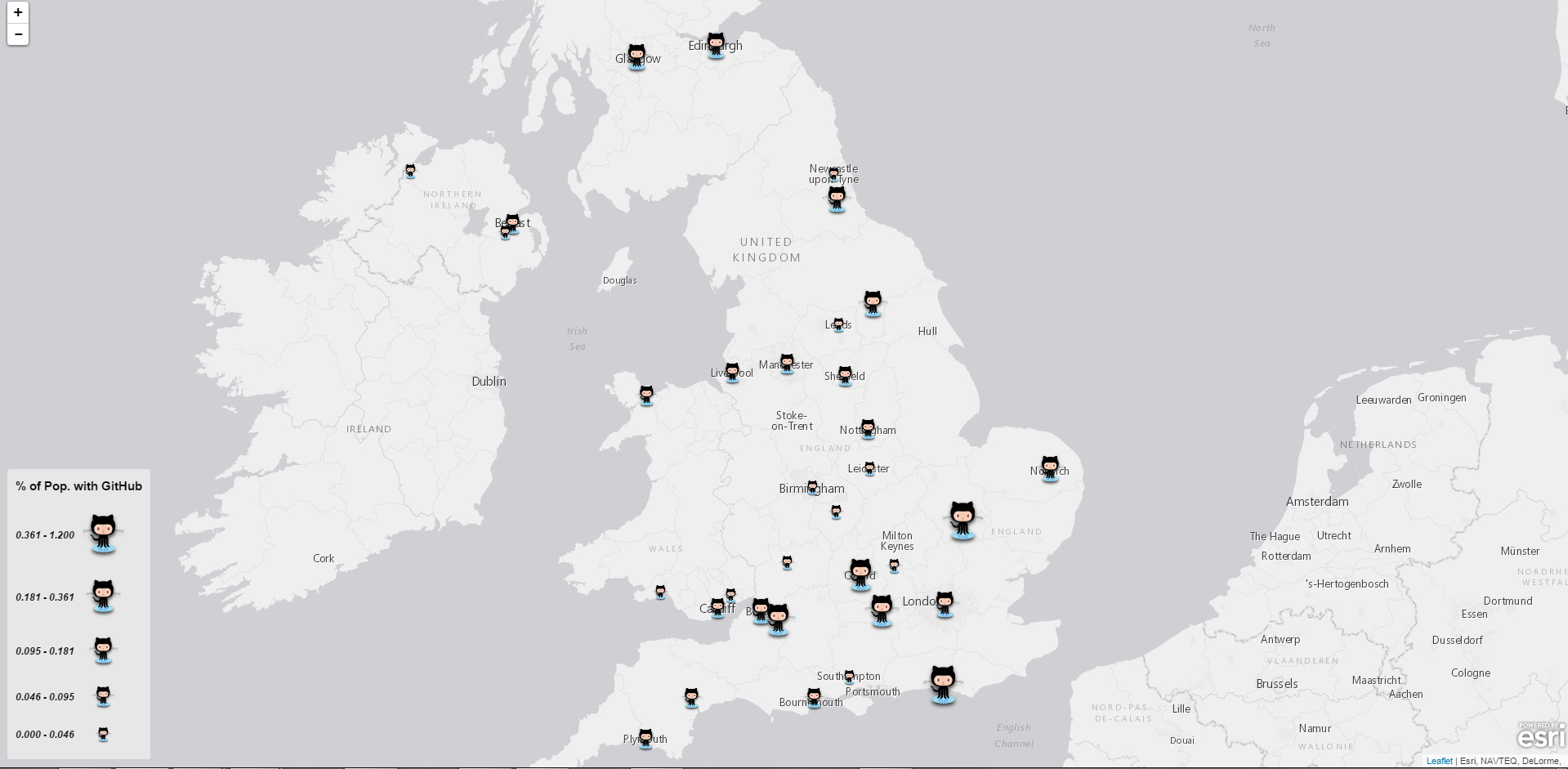

}).addTo(map);Screenshot and Live Demo
A screenshot of the map can be seen below, a live demo can be seen here.
