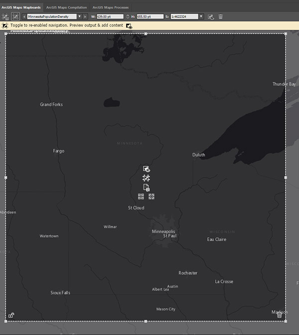

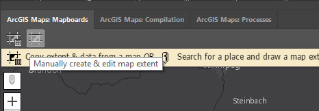

Once you have opened Illustrator and logged into the M4CC extension, zoom to your desired extent, and draw your Mapboard. To do this, click on the Mapboard tool in the upper-left of the Mapboards tab, and draw a box around the area you want to map.
Click on the Mapboard tool in the upper-left of the Mapboards tab
For this map, I'm making a choropleth map of population density in Minnesota. Really quick, a choropleth map uses color saturation and/or hue to indicate a statistic's value or intensity within usually-adjacent polygons - or as some non-mappers might call them - color-coded maps.

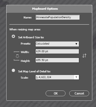

Once you've drawn your mapboard over the extent that you want to map, you'll be prompted to give your mapboard a name in the Mapboard Options dialog. You'll also be able to specify your map's size here. I've named mine "MinnesotaPopulationDensity" and I left the scale and size as they were.
TIP - Whatever you name your mapboard will also be the name of your downloaded Illustrator file. If your mapboard name is identical to an AI file in the same file location where you will download your map, then you will be prompted to give your mapboard a new name.
Name your mapboard.
Full mapboard extent over Minnesota

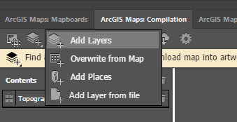

Click the Search and Add Content button, and select Add Layers from the menu

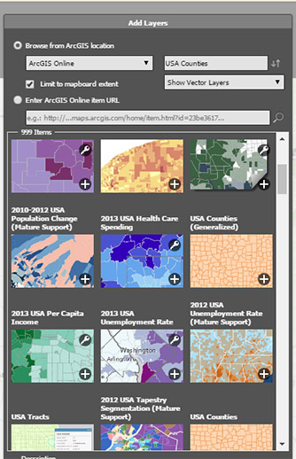

In the Add Layers dialog choose "ArcGIS Online" from the Browse Location dropdown, and type "USA Counties" in the search box next to it. You can also filter to "Show Vector Layers" from the data type dropdown beneath the search box. Then click on the plus ("+") icon in the "USA Counties (Generalized)" layer from the list of data layers that appear. This will add the layer to your map. Note - You may need to scroll a little to get to this layer.
Add the "USA Counties (Generalized)" layer to your map

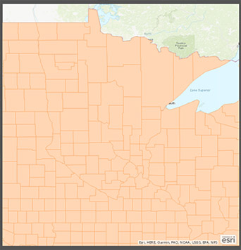

Compilation window preview after adding the "USA Counties (Generalized)" layer

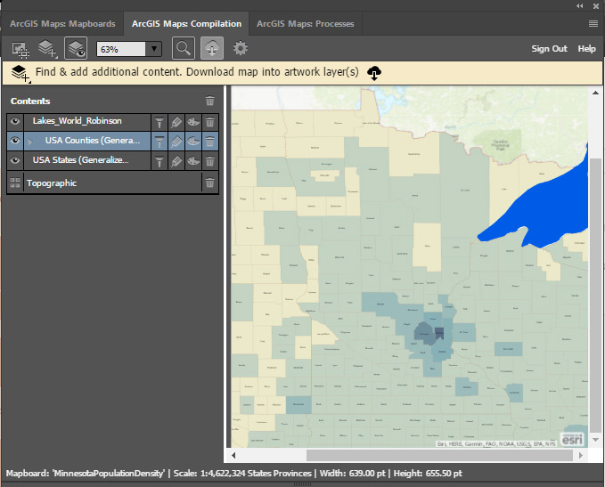

Click OK. Your map should look something like this:

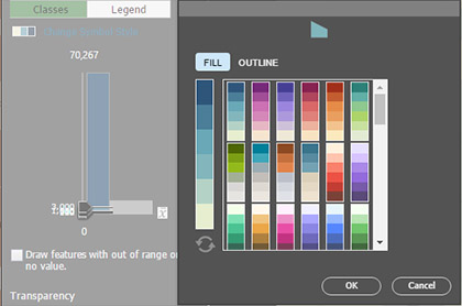

TIP - If you would like to update the colors of the choropleth, you can choose among several gorgeous ArcGIS Online color palettes by clicking Change Symbol Style. For this map, make sure you are choosing a sequential (a sequence of light-to-dark) color scheme and that the lighter color represents the category with the smallest values.

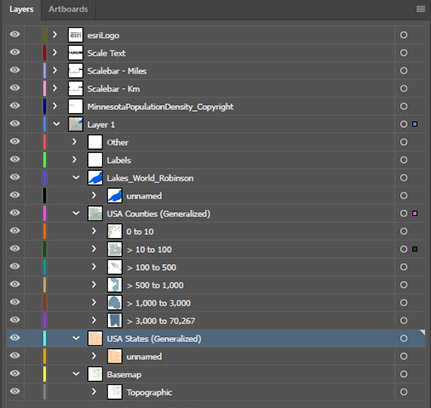

- Build a legend based upon the categories that you built in the Compilation window. These categories are conveniently preserved in the layer structure:
