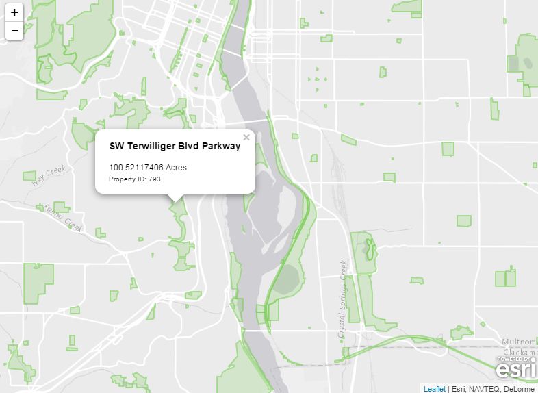

You may not have noticed, but while you were editing your JavaScript files, you should have seen some messages in your terminal about a bundle.js file being created. That's because the npm scripts we wrote earlier are set up to watch for any changes in these JavaScript files and to recompile the them into single bundle.js file your application needs. If you open your browser to localhost:8080 *crosses fingers* you should seem something like this.
Congratulations! You just set up a very simple development environment to build your Esri-Leaflet applications. As you add more modules or organize your code, just edit the watch script in package.json as needed and keep on coding.
