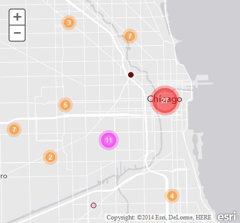

I made a similar blog post not too long ago, but thought I might share this here. Clustering of point data is a pretty neat way of being able to deal with displaying large amounts of data on a map in a simple way. This capability is a staple in the Flex and Silverlight Esri APIs, but the JS API has not gotten the same sort of love.

You can view the project on github here. There are some details in the README and more details in the comments to the code. There has already been a few contributions to the code, which is the beauty of github. You can view a demo of basic clustering here. Did I also mention that it will accept services with polygon geometries and convert them to points and cluster them for you? Yeah, it can do that too.
