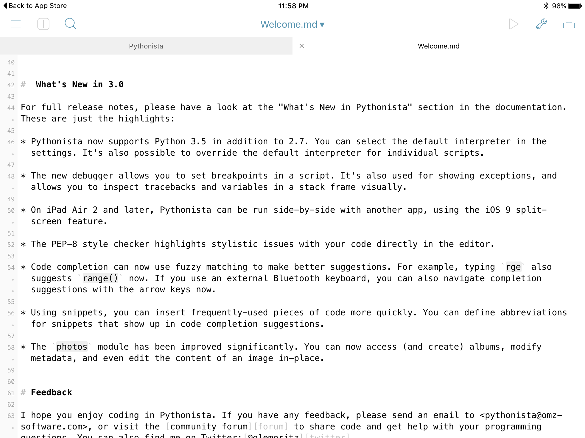

I have mentioned the program Pythonista (available at the iStore) as a great program for doing programming. I have been using the 2.7 version for about 2 years now and I am impressed with its IDE. The new version runs both python 3.5 (yes... 3.5) and python 2.7. It contains many, many modules by default, including numpy and MatPlotLib to name just a few. You can ship your cool scripts off to github, OneDrive, all those cloud places. You can even produce pdfs amongst other things. A downside... some bizarre Apple policy (no clue what it means) makes it just a tad hard to load a script directly... (but we all know how to copy and paste content don't we, or consult a 12 year old).

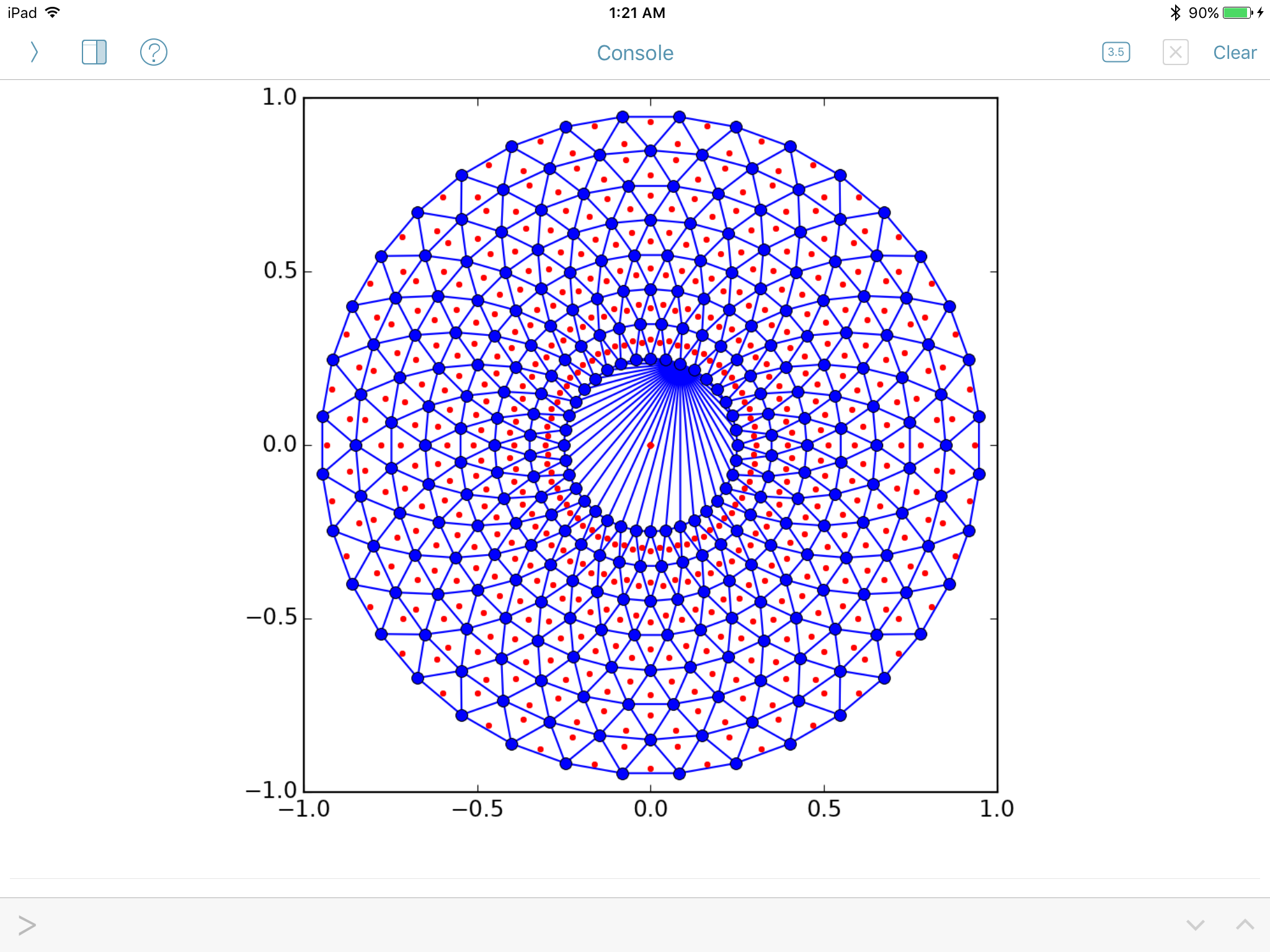

So, have a gander at your site-packages folder in your python distribution and just add more. Do you like line numbering? code completion? indent/dedent? cool IDE themes (like the Dark Theme) and whole load of other stuff, then you might be interested. SciPy and Pandas isn't included yet, so you will have to do your Voronoi Diagrams and Delauney Triangulations the old fashioned way through pure python and/or numpy or MatPlotlib. Ooops, I forgot, most of you don't have it since you aren't using ArcGIS Pro yet, so you won't miss it (you will have to install Pro to get python 3.4.x and the SciPy stack with other goodies).
But how cool... standing at the bus stop... whip out the iPad and run a quick triangulation in Matplotlib... how to impress potential employers who might be watching.

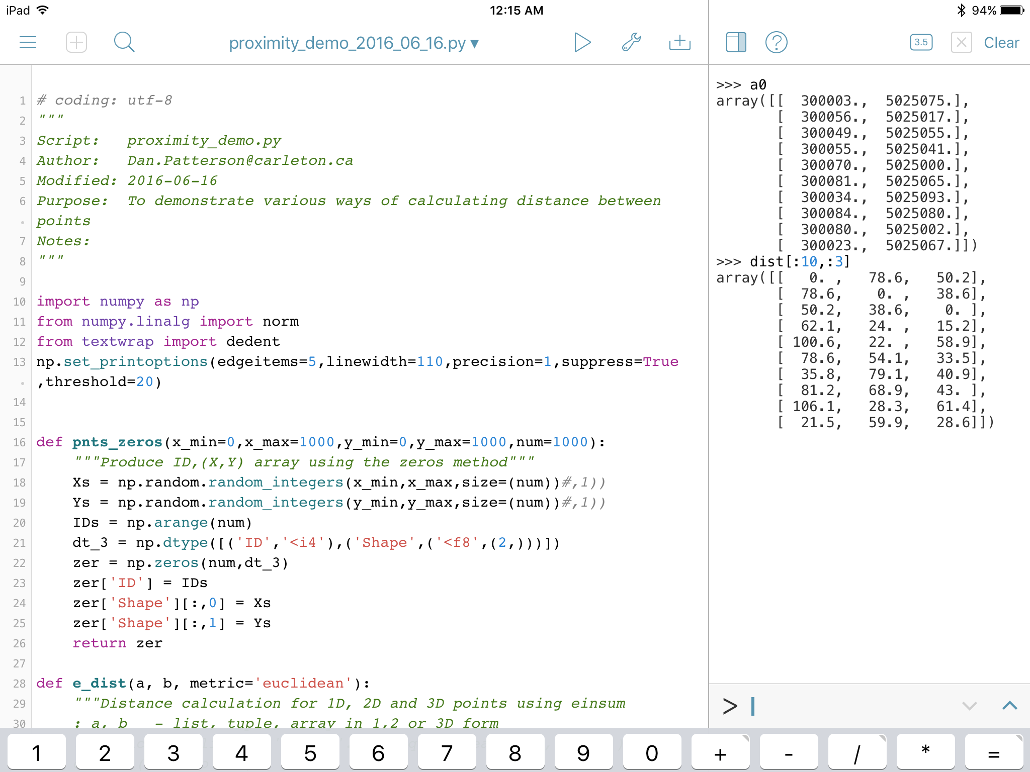

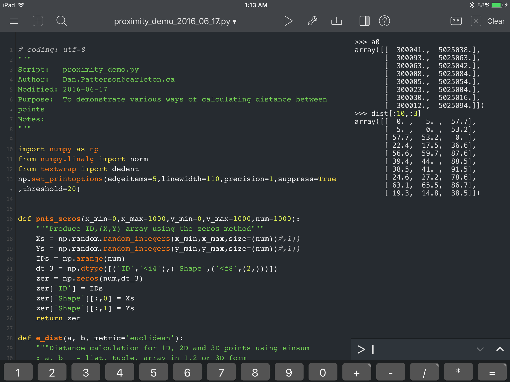

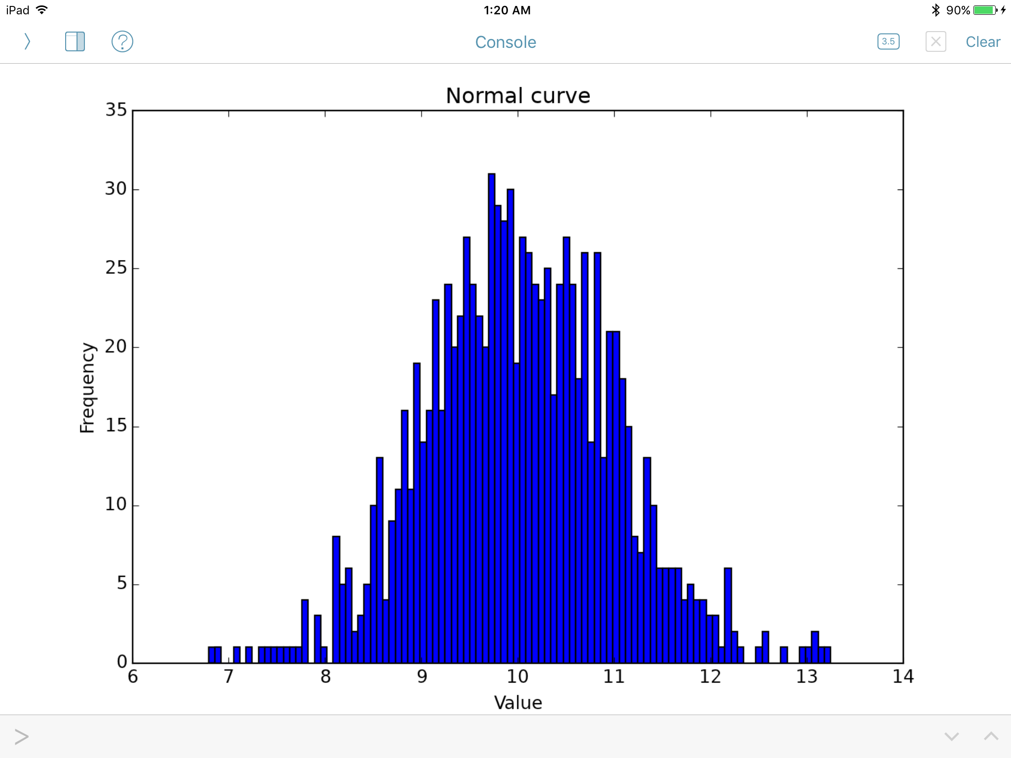

Two screen grabs just to give you a quick view of other stuff. I will update when I play with the new version more.
Sample script, using a partial split screen for output on an iPad. Imagine how cool this would look on your iPhone
Alternate theme, for the moody programmer...

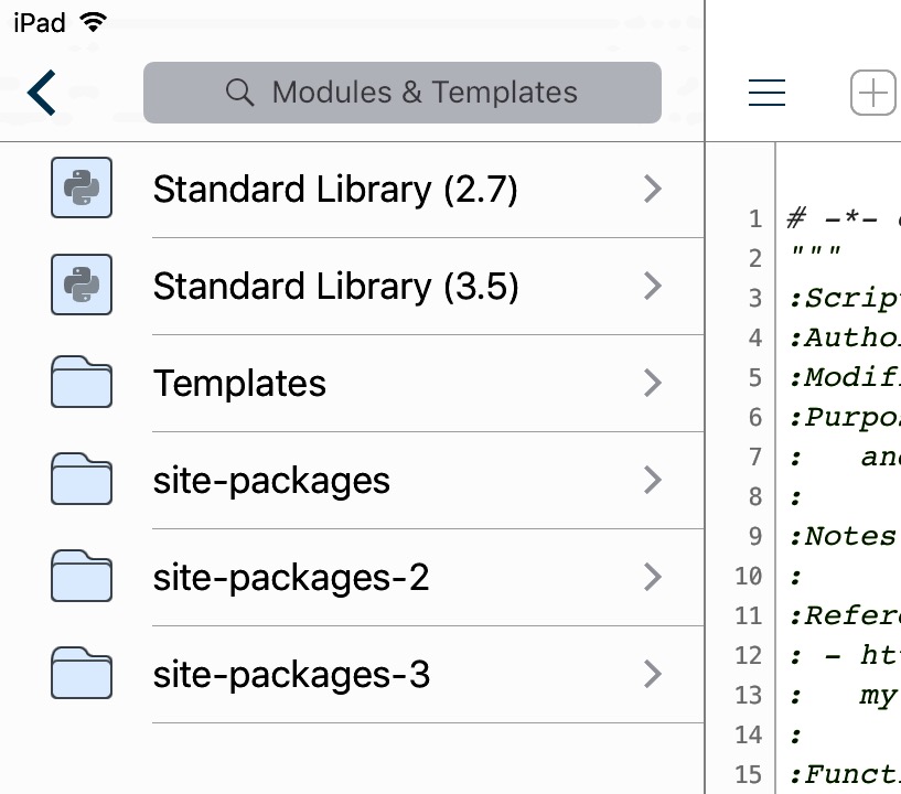

The python 2.7 and 3.5 distributions have their own access points with their own site_packages folder and even a shared one. Kind of like a version of condas... maybe iCondas...
