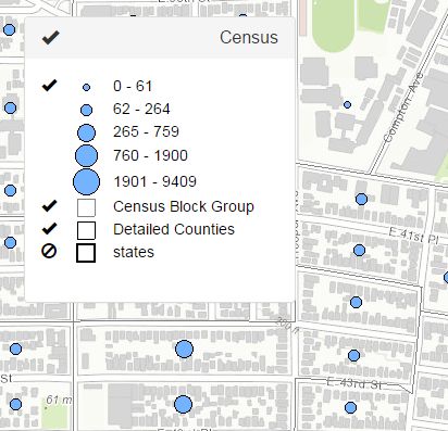

});Woah, that's a lot of code. Hey you wanted to learn about a ToC widget, that's going to take a bit of code. I added some comments in there to help you out. You might be able to break out some of the functionality into smaller modules, but I'll leave that up to you.
I'm using the put-selector in this sample to create DOM elements (it's included in the ArcGIS JS API) just because I've found it makes more sense for me when composing DOM creation. I'm also using Bootstrap to make it look nice, which is where some of the css class names are defined.
When it's all said and done, this sample will look something like this.
Pretty snazzy
What this does is turns off individual services and the individual layers in the visibleLayers. This sample is only set up for an ArcGISDynamicMapServiceLayer, but you could tweak it for FeatureLayers and if you're bold add support for custom renderers. I try to avoid this when I can as I always seem to muck something up, but it can be done. Good luck. I remember this being a lot harder a long time ago when I did this in Flex, as I don't think the REST API had a Legend endpoint back then, so this is actually easier than it would have been.
