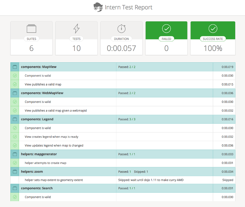

Combine live-reload with Grunt and a few plugins and every time I make a change to my app, my app reloads in the browser and my test page also reloads so I can instantly see if I broke something.
Green is a beautiful color.

});All that noise basically boils down to this.
'View publishes a valid map given a webmapid': function() {
mapView = new View({
webmapid: config.webmap.webmapid
expect(mapView.webmapid).to.equal(config.webmap.webmapid);
}I'm basically saying that when I create this component, I expect it to have a webmap with the webmapid I gave the constructor. That's it. The implementation is left up to me, but the test is only concerned about the end result.
