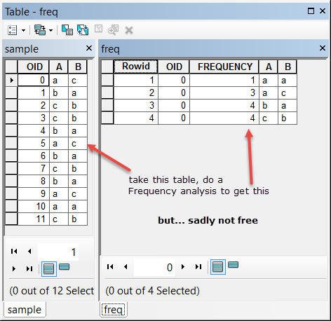

I have ...
columns containing class information with
- the same - different data types
and I want to combine them to produce a unique classification scheme and
- count the number in each class
- calculate some statistical value,
- graph it.
Get the picture? Sound familiar?
I will show the results of doing this type of analysis and provide an attachment for you to do it.
In ArcGIS, the Frequency tool produces these results
Now these results look similar...in fact identical, but created without using the frequency tool... but using tools provided within ArcMap itself.
| Input array | Sorted array | Summary |
A B 'a', 'c' 'b', 'a' 'c', 'b' 'c', 'b' 'b', 'a' 'a', 'c' 'b', 'a' 'c', 'b' 'b', 'a' 'a', 'c' 'a', 'a' 'c', 'b' | A B class row 'a', 'a' 0 0 'a', 'c' 1 1 'a', 'c' 1 'a', 'c' 1 'b', 'a' 2 4 'b', 'a' 2 'b', 'a' 2 'b', 'a' 2 'c', 'b' 3 8 'c', 'b' 3 'c', 'b' 3 'c', 'b' 3 | combinations class ( 'a', 'a' ) 0 ( 'a', 'c' ) 1 ( 'b', 'a' ) 2 ( 'c', 'b' ) 3 first occurence 0, 1, 4, 8 reclassed list 0 1 1 1 2 2 2 2 3 3 3 3 class 0 1 2 3 4 count 1 3 4 4 - |
