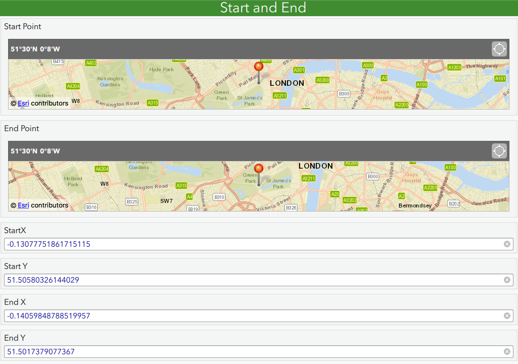

Multiple Geopoints
Another popular request the null value solves is the ability to capture multiple locations in a form; one location can be stored as the geometry of the feature with the other points being stored in x & y fields. Note that as the survey submission needs to have a geometry, you must have 1 geopoint question not set to null.
An example where multiple geopoints are useful is when collecting the location of a culvert or other relatively straight linear asset.
To store the point information, get started by creating 3 (or more) questions for each point after the first:
- The geopoint question to record the value
- Two decimal (or calculate/hidden) questions to store the points x and y values (add additional fields for z and accuracy, if desired)
Set the field type to null for the geopoint and use the pulldatageopoint’) function to extract the value after the point is set. Here's a basic sample with a start and end point.
