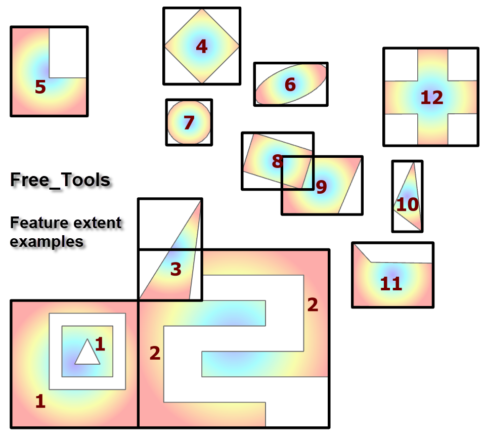

Spatial containers can be used as substitutes for the original spatial pattern. These would include ...
- the shape itself,
- convex hull,
- concave hull
- minimum area bounding (or perimeter)
- extent poly* features
The last of these are axis-aligned shapes bounded by the coordinates of the minimum of the lower left corner to upper right corner, not of the existing coordinates, but by the L(eft), B(ottom), R(ight) and T(op)⦠LBRT.
Normally containers only make sense if you are using projected coordinates or can perform geodesic densification.

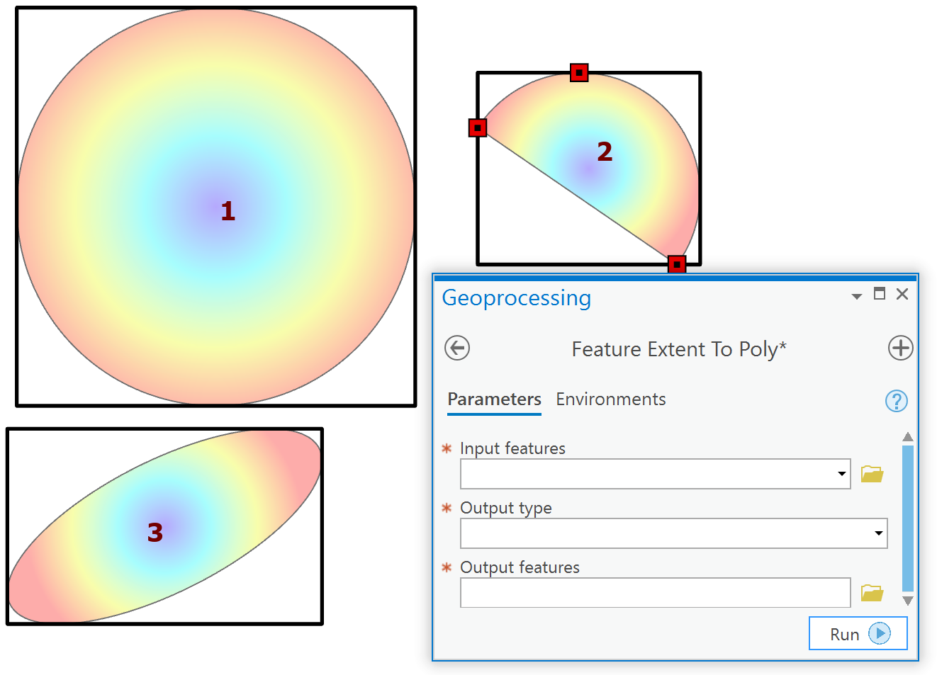

Output example
Pretty well sums it up.
- Specify the input featureclass (polygon, polyline or multipoint),
- the output type (polygon or polyline) and
- the output featureclass.
The conversion uses the numpy based Geo class that I describe in the 8 part series on geometry.
The conversion also handles shapes that contain curves, for simple geometry. To do this, you will find that circles and ellipses or sliced sphericals contain 2 points... the identical start and end and no other points. At least in a file geodatabase. The quick solution is to densify the arc based on the ANGLE option in arcpy.densify. I choose between 1, 2 or 5 degree densification depending on how fine I want the resultant n-gon to reflect the original curve.
