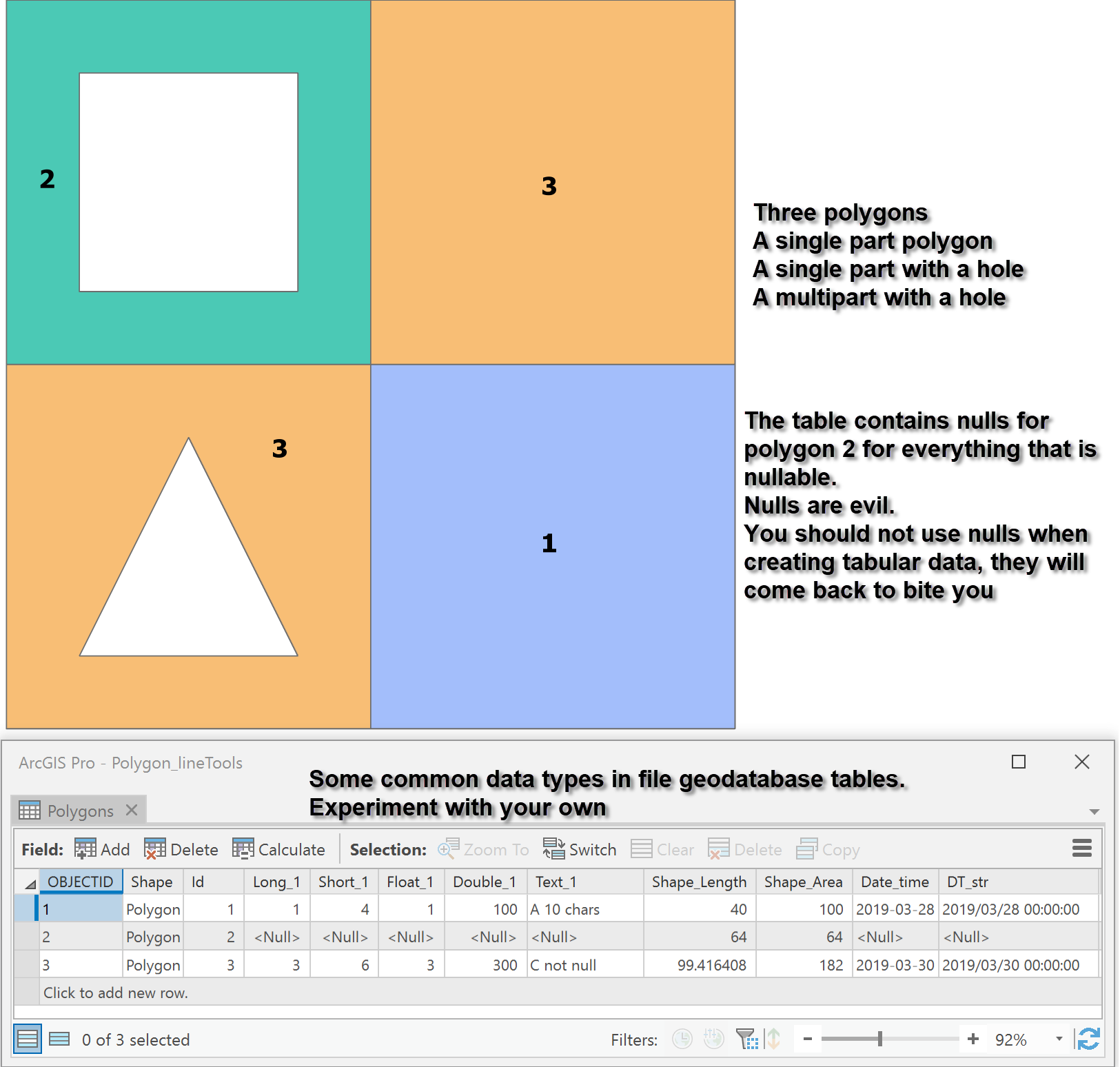

| The scenario... |
Some data. Simple, but a combination of singlepart, multipart a couple of holes and tabular data with nulls.
Time for the SearchCursor Easy couple of steps, when you know what you want. We will just blow up the polygons to points and get all the attributes in the table. in_fc <SPAN class="operator token">=</SPAN> r<SPAN class="string token">"C:\My_spaceless_path_to_my\file_geodatabase.gdb\Polygons"</SPAN>

Well that didn't go well! Translation? looks like an attempt was made to convert some bit of data to an integer and it couldn't be because of those pesky <nulls> ...aka... None in the table!
Yes those things that you have to exclude from calculations, you have to query for, you have to remember it isn't good to see if something is equal to None but whether something IS None.
Hence, Nulls are evil. They are a lazy way out of not recording a value in a table that represents the fact that you have no observation for that field.
You have to get rid of nulls, so if you are too lazy to do it at the beginning during data preparation and Q/A work, then there is a way out. So if you ignore the verbosity in the code below, there are a few tips.

Notice the integer columns have nulls in them as do the other columns. Columns should have one data type. We get too complacent because of spreadsheets.

Lesson... don't use <null>, define a true null value that represents what is meant by it. There can be more than one type of value to represent conditions like, no data collected, versus no data available, versus no observation possible... don't lump them into one category at the beginning. You can aggregate AFTER data collection, you shouldn't do it before
