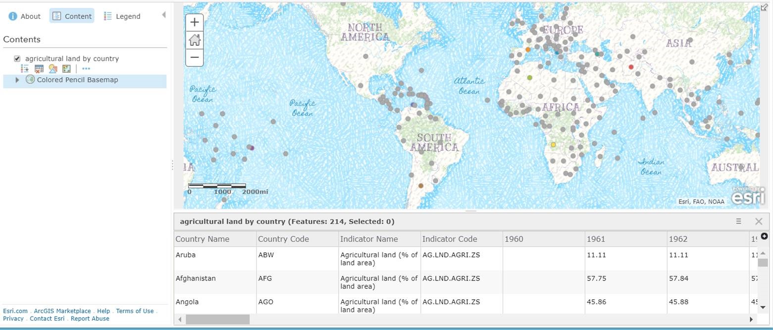

How can you do this? You can do this via the Join Tables tool and by accessing the Living Atlas of the World. First, log into your account in ArcGIS . Then > Map > Modify Map > Add Data. Add your spreadsheet. Need a spreadsheet? The World Bank has a wide variety of data sets by country in tabular form. Indicate the field (such as country code) for your place-based table, and the result will be a set of points, similar to that below (shown on the colored pencil base map, which I love):

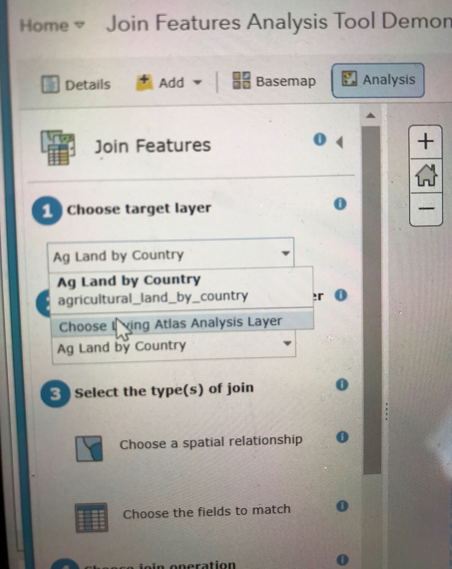

That is all good, but now for the really exciting part: To make a choropleth map by country of this same data: Perform Analysis > Join Features, on step 1, select Choose Living Atlas Analysis Layer, and for step 2, choose your table, which now resides in ArcGIS as a layer, and join on a common field. In this example, I had no common field, so I first had to add a field in Excel for the 2 digit ISO country code and populate that field with the code. Why? Because the ISO 2 digit code did not exist in the World Bank table. This is a good example of knowing your data and what you need to sometimes do to enable joins to take place.

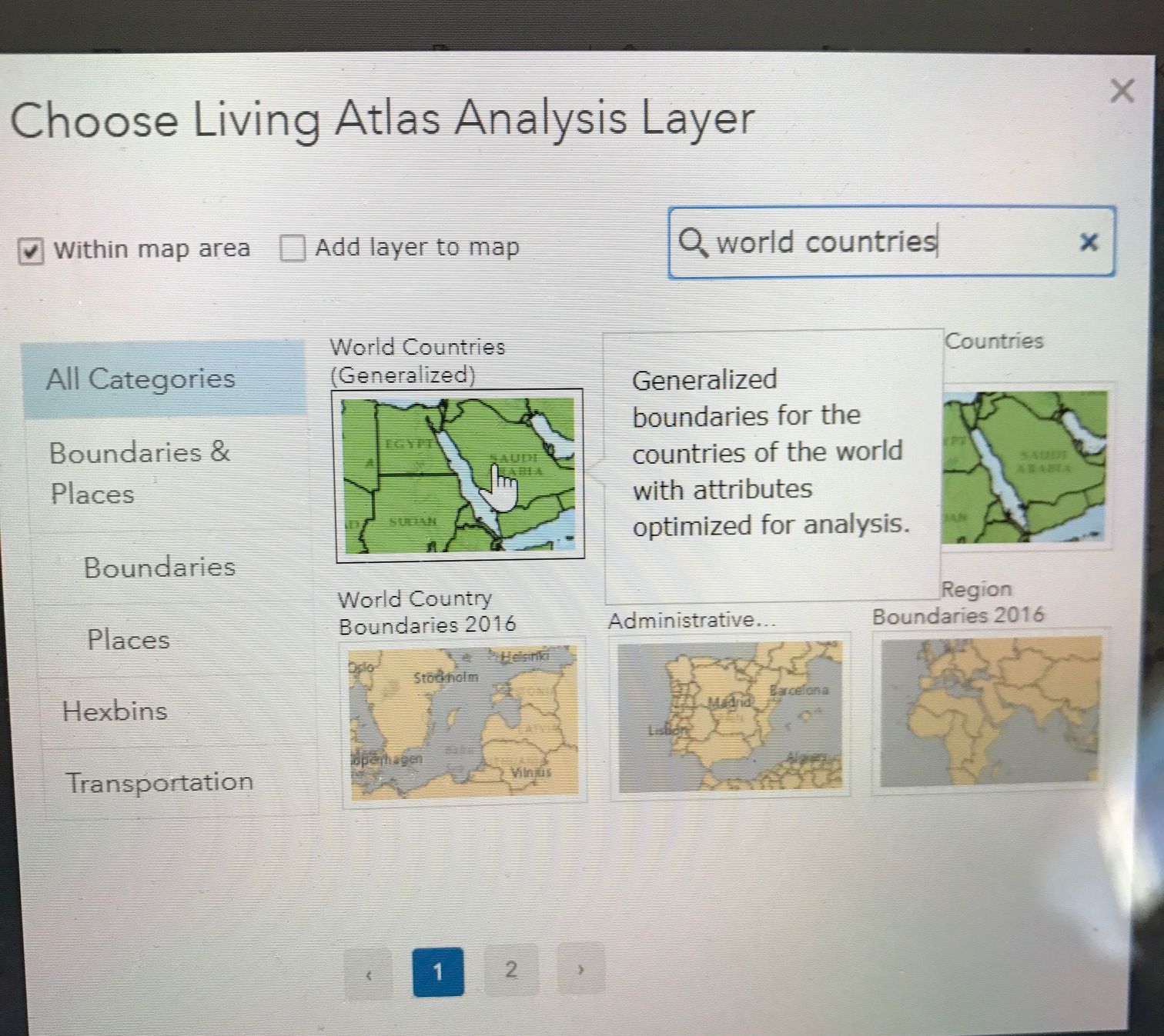

While running the Join Features tool, select the Living Atlas, search for World Countries, and choose World Countries, as shown below:

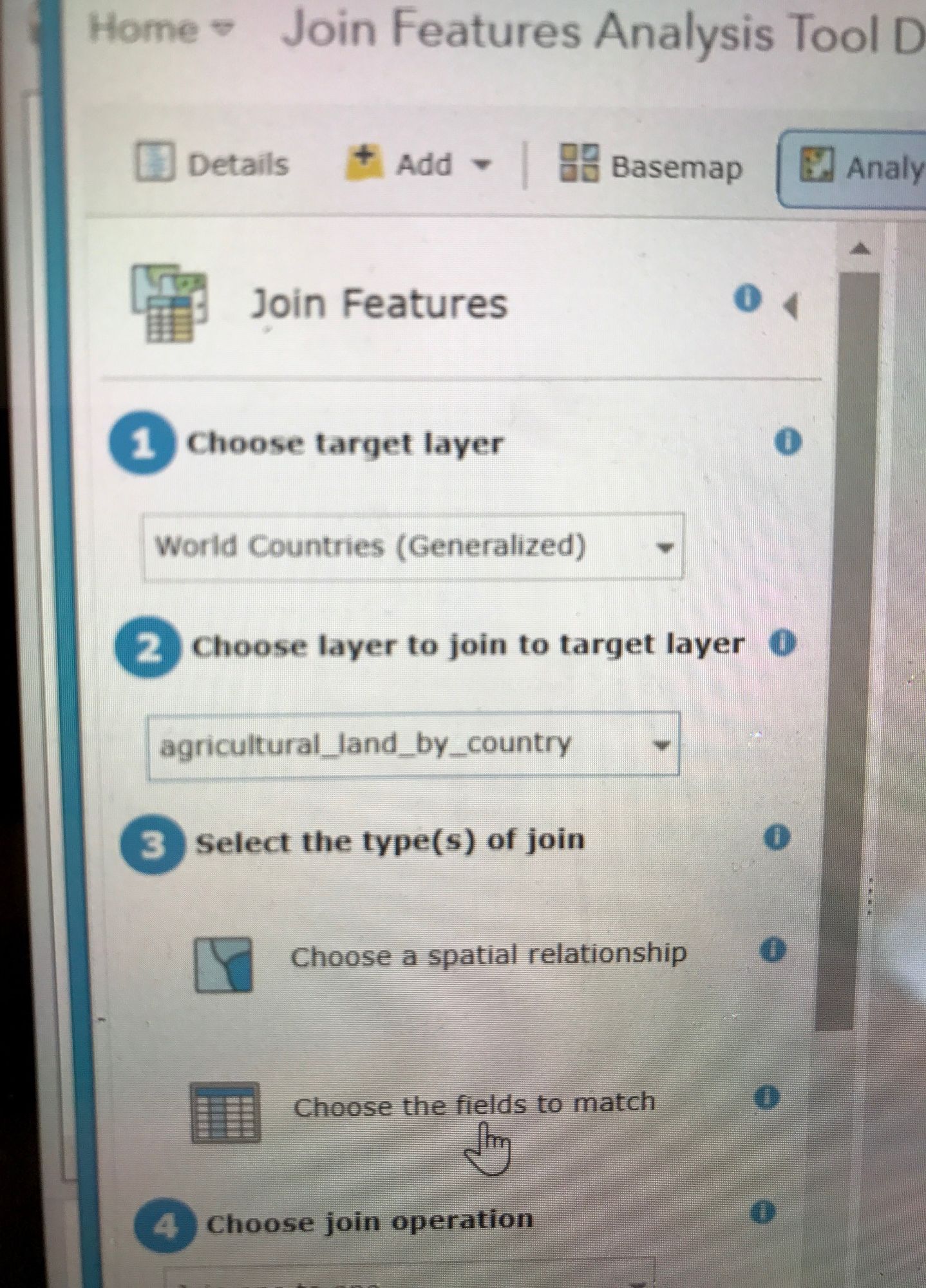

Therefore, you are joining your agricultural land table (#2) to the World Countries (Generalized) from the Living Atlas, as shown below:

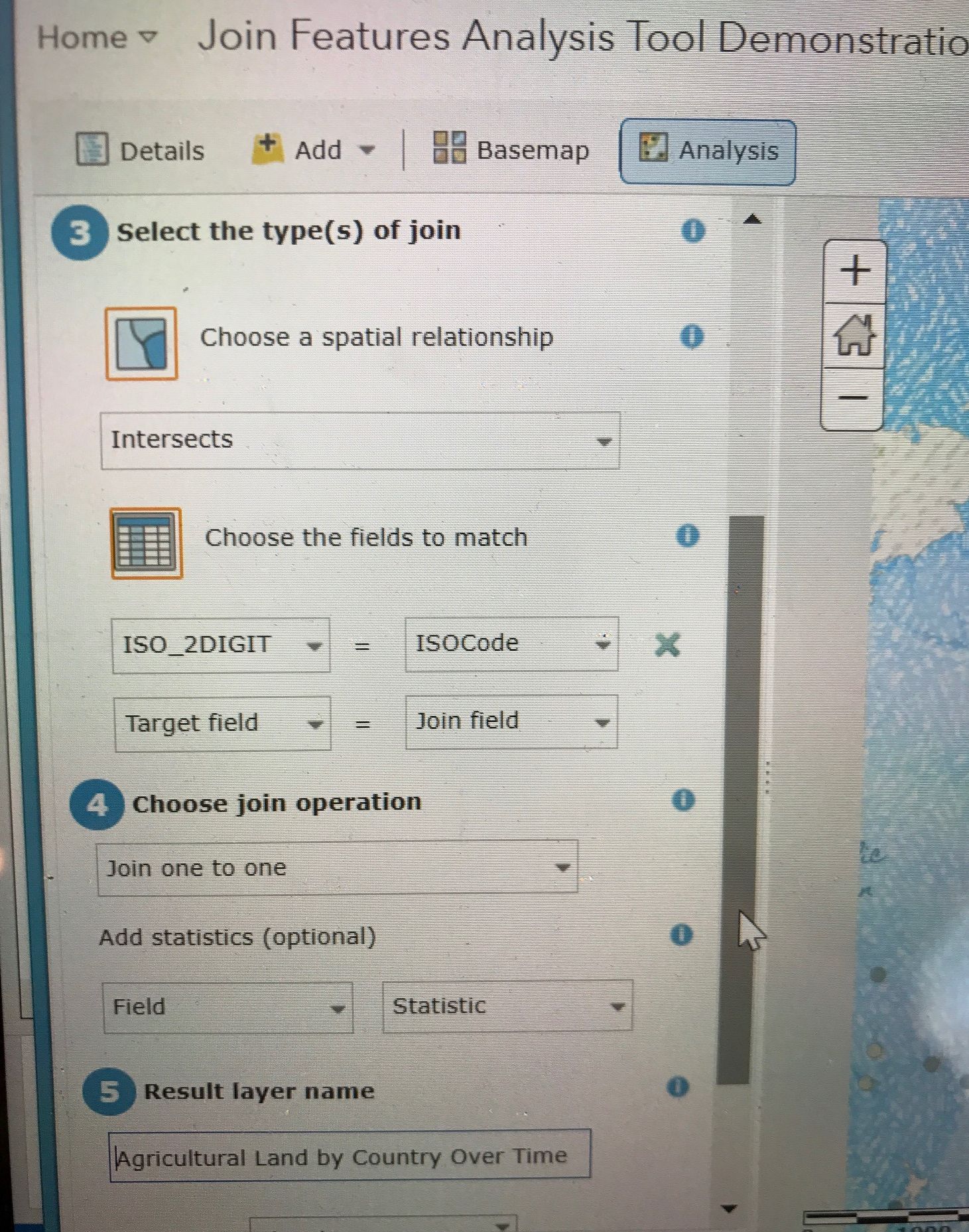

Indicate the fields that will serve as your join fields, as I have done below. I will be joining on the 2 digit ISO code. When possible, join on a code rather than names (of cities, countries, and so on) due to spelling differences, which will adversely affect your match rate.

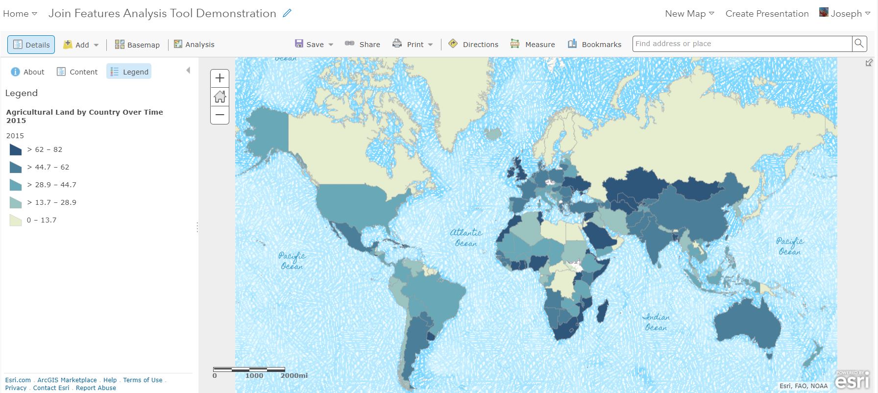

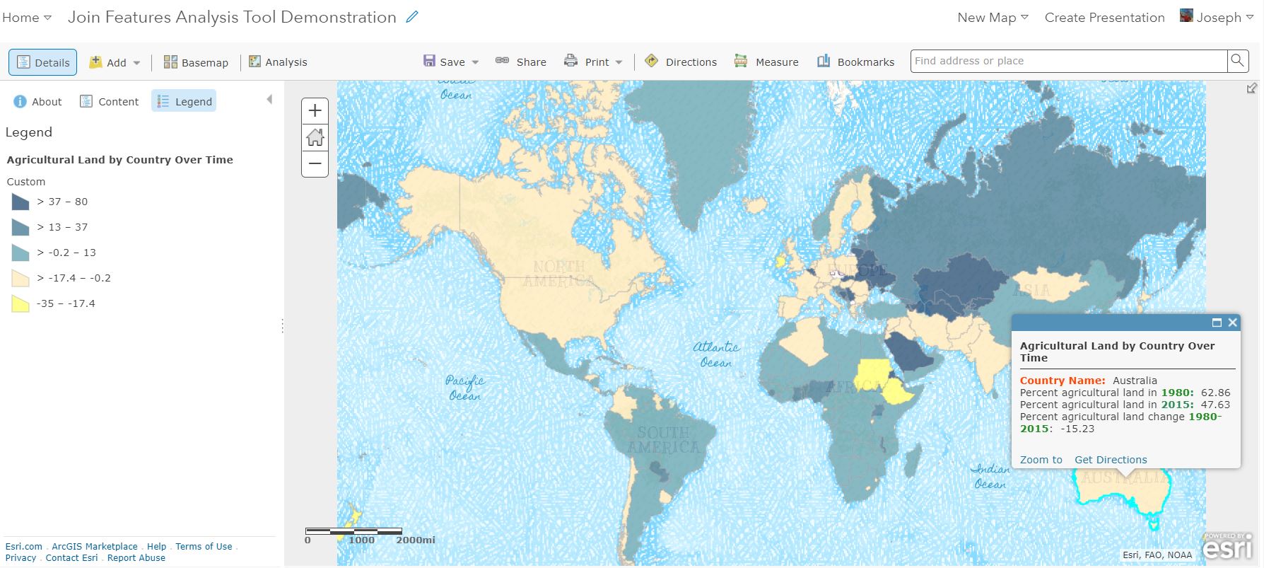

The result is a map joined to your original table! Now, with the map at your fingertips, you can map any of your table attributes, such as agricultural land by country for 2015, as I have done below.

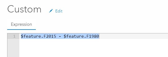

Now let's dig a little deeper. Since we are working with agricultural land over time, we can create a custom Arcade expression that will allow us to visualize changes around the world. I created a custom expression below, subtracting the 1980 percent agricultural land by country by the percent in 2015, as shown below. Since the data are already in percent, there was no need to multiple by 100 (again, knowing your data is key!):

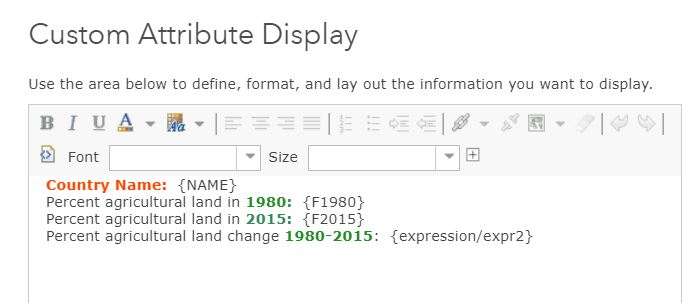

I also want the popup to display the change over time, and so I will add the same expression shown above to the popup custom attribute display, as shown below:
The resulting map and popup are shown here. What patterns do you notice? Why the big increase in Saudi Arabia, for example? You could zoom in, change the basemap to imagery, and investigate the new center pivot irrigated fields in the middle of that country. You could pan over to Brazil and examine fields reclaimed from wetlands and rainforest. You could examine urban spawl in the USA and elsewhere as part of your investigation into why agricultural land has declined in many areas of the world. Because I believe a data set like this is valuable to teach many core themes in environmental science, economics, and physical and cultural geography, I have shared the table here.
