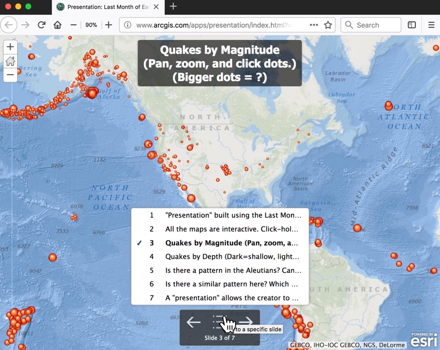

See this simple 2D presentation about earthquakes (from Row 5 of the ArcGIS Online Skillbuilder). Note the navigation tools, top left and bottom center: pan/zoom or choose your slide, and that's it ("identify feature" works too). Header text doubles as slide name. The creator gets to emphasize his/her info, sequencing the exposed and highlighted content, and the viewer gets to follow or explore but only as the creator permits.

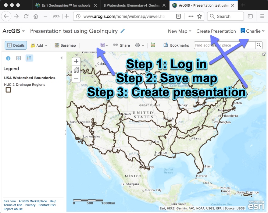

- Notice that you cannot create a presentation until you own the map. Sign in, and then immediately choose to save the map in your contents.
- Once signed in and with map saved, "Create Presentation" appears next to your login. Click it.

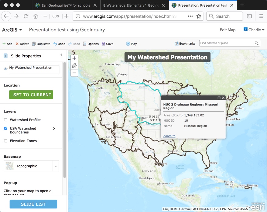

- Click the green "+" button to begin creating a slide. From here on, it just takes deciding what you want to show, in what sequence.
- In the title box near the top, type some text, such as "My Watershed Presentation;" it shows atop the map.
- Pan & zoom to adjust the map extent as desired, then click the green "SET TO CURRENT" button to lock in the current map extent as the starting point for this slide.
- Turn layers on/off, and/or change the basemap as desired.
- Open a popup, and click the checkbox if you want it to open with the slide.
- You've completed a slide! Now just repeat steps 6-10 as desired. You can shuffle the slide sequence, and edit existing slides. Remember to SAVE your presentation, and hit the PLAY button to test it.
