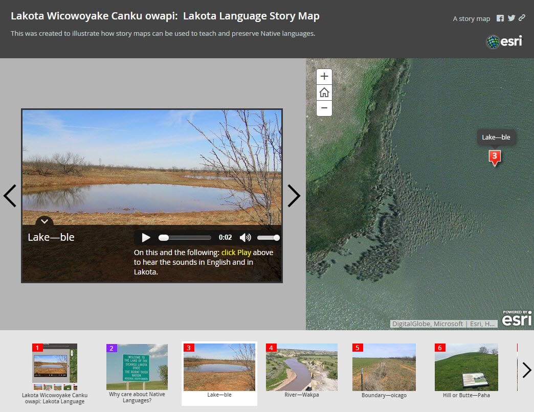

Then, edit the captions section for each of your stops on your map tour. These stops can be photographs or videos. Note that my "lake" stop is a video and the rest of the stops are photographs. The HTML code that I used for one of my captions was as follows:
<audio controls="">
<source type="audio/mpeg" src="
http://josephkerski.com/storymaps/lakota-sound/lake.mp3"type="audio/mpeg"></source>does not support?</audio>On this and the following: <font color="#FFFF00">click Play </font>above to hear the sounds in English and in Lakota.
That's it! The beauty of HTML 5 is that my code above helps the browser know that an audio file will be played, and the browser knows how to configure an audio player without any extra coding on my part.
