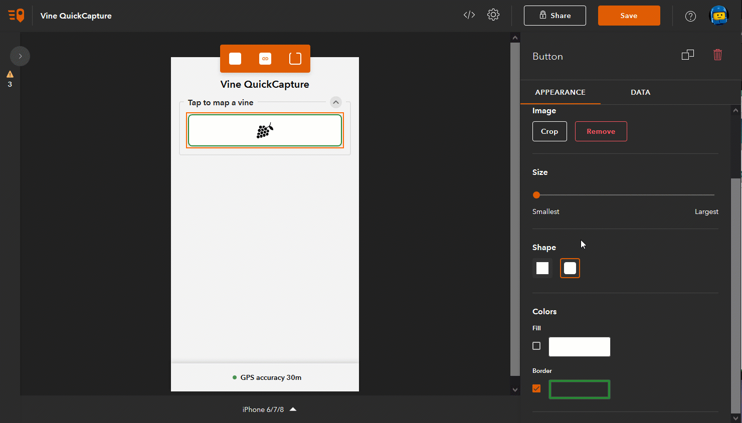

Bigger buttons, of course.
With this update, you can configure your QuickCapture apps with bigger buttons. This is useful when authoring projects for large tablets, with very few or even a single button. Larger buttons help you take full advantage of the available screen real estate on the device, facilitating data capture.

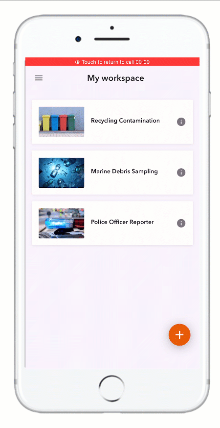

Enhanced Project User Inputs (Remember previous entries)
To facilitate quick data entry from end users, the QuickCapture mobile app now remembers previous Project User Input entries. In the animation on the side, for example, the Police Officer Reporter app presents a dialog for end users to enter the ID of the person that will collect data. Note that the dialog presents two options in a list right below the text input control. The end user can either enter a new ID, or tap on any of the previously entered IDs.
The QuickCapture mobile app will list the three last entries. The idea listing previous entries is to accelerate data capture and reduce errors when entering this information.

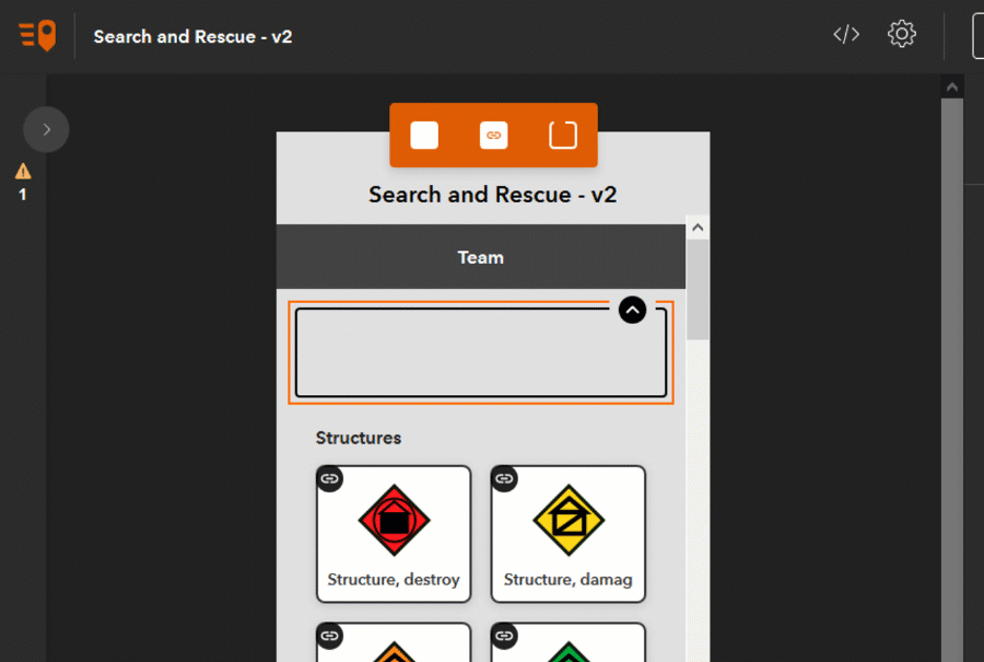

Locked Groups
QuickCapture buttons can be logically organized in groups. Groups help end users navigate across QuickCapture apps that include many buttons.
By default, groups can be collapsed and expanded by end users.With this update, the QuickCapture app author can decide to hide the handle to collapse and expand a group. This is useful when you want to make sure a set of buttons will always be visible to users. You can control the group properties from QuickCapture designer.

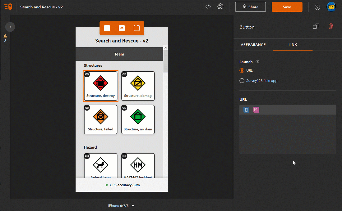

Link buttons (launching any URL)
Link buttons allow you to open other mobile or web apps right from within ArcGIS QuickCapture. For example, you may want to configure a button to open a live dashboard in a web browser, a PDF file or launch a Survey123 smart form. With link buttons you can convert your QuickCapture project into a launchpad for other applications.
The animation below shows how you can add a new link button into a QuickCapture app, to launch a website.

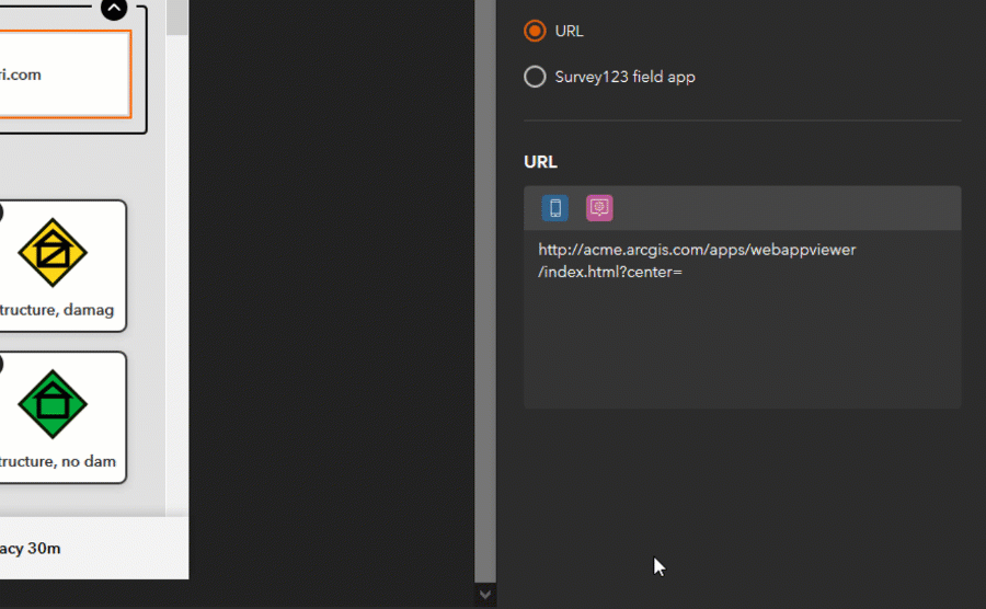

You can include dynamic content in your target URL. For example, you may want to add custom URL parameters to center a Web AppBuilder application at the user's location, or pass a filter into an ArcGIS Dashboard. For more information about URL parameters in ArcGIS Dashboards and Web AppBuilder, check the following links:
In the animation below, we are passing the current latitude and longitude of the user when the link button is pushed. Note that dynamic content in the URL can be populated from device variables as well as from the Project User Input.
