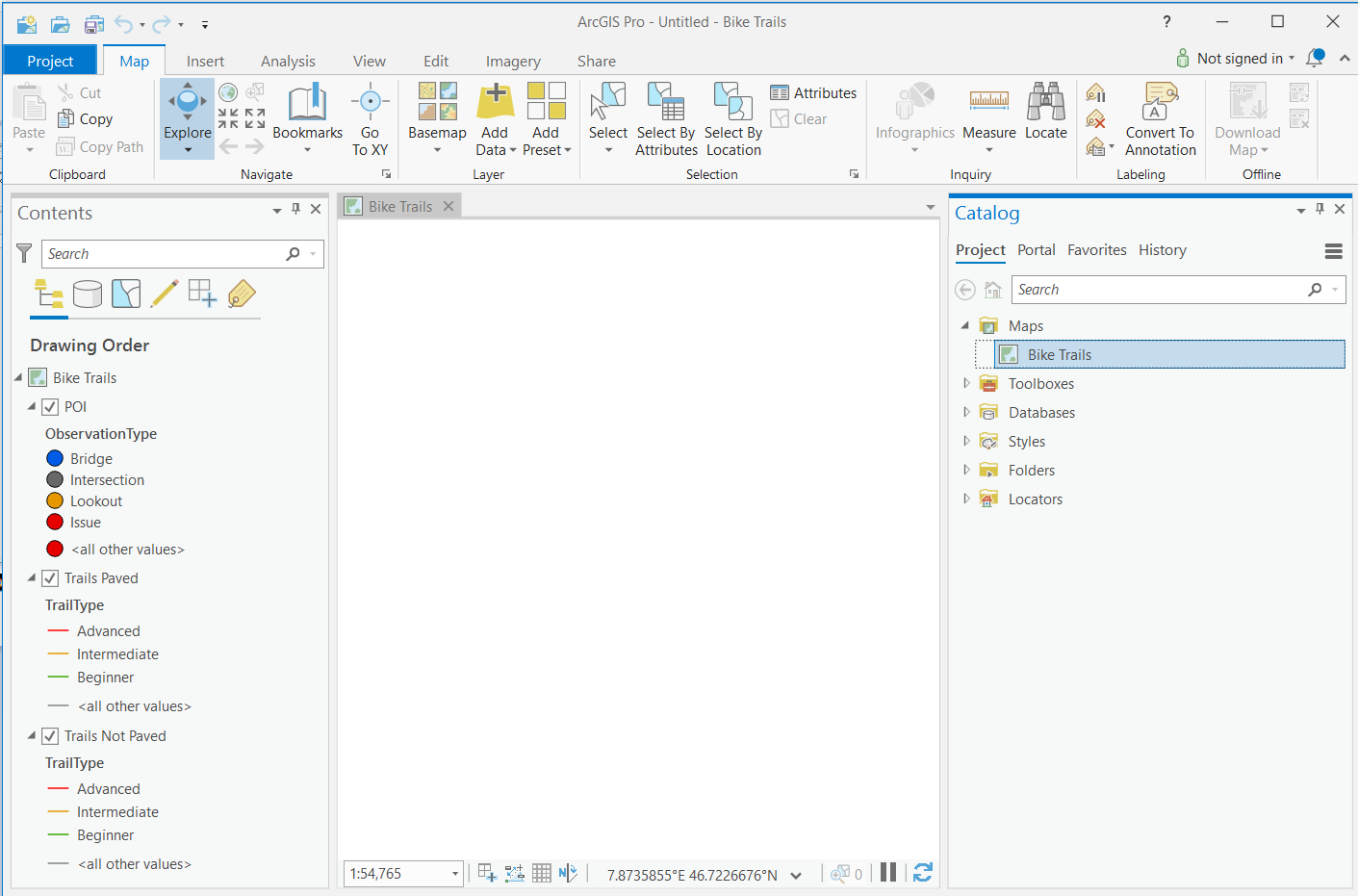

In this first step, we will use an ArcGIS Pro map to define the features we want to capture from ArcGIS QuickCapture. Showing how you can create a map, its layers and attributes in ArcGIS Pro is outside the scope of this tutorial, so we have made available a sample Bike Trails ArcGIS Pro project for you.

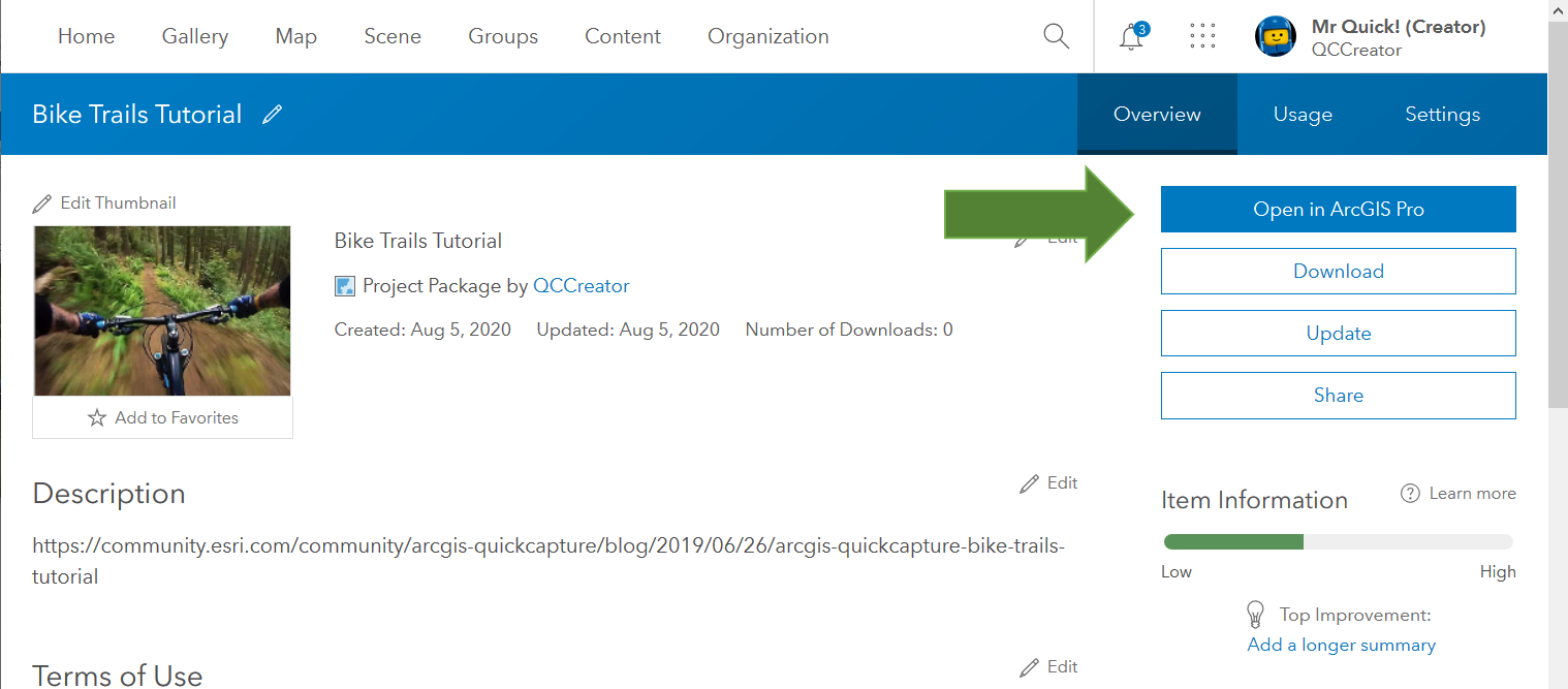

Open the Bike Trails Tutorial ArcGIS Pro project file from ArcGIS Online
https://www.arcgis.com/home/item.html?id=79b84a40f23340e186e2fd10c551e917
Once open, you can save the map as a new ArcGIS Pro project (aprx) into your own computer.
Note that this map has three layers:
- The POI layer is used to define Points of Interest. We categorized Points of Interest using the ObservationType field into Bridge, Intersection, Lookout and Issue, and applied symbology using unique value renderer.
- The Trails Paved and Trails Not Paves layers also applies a unique value renderer to classify the trails by the TrailType attribute: Advanced, Intermediate and Beginner.
When creating your own ArcGIS Pro map documents for use in ArcGIS QuickCapture, you will want to set the symbology of your layers with either unique values or simple symbol renderers. The categories set through your symbology will later be used to create corresponding buttons in the ArcGIS QuickCapture project.

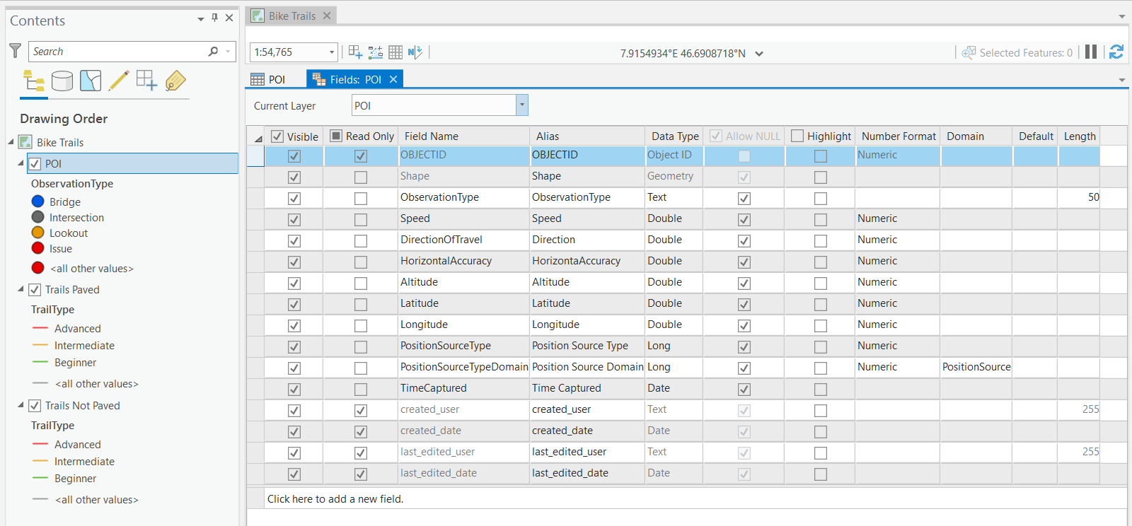

If you open the tables for each of these layers, you will also note that we added a bunch of extra fields to capture attributes such as speed, direction of travel, time captured and other things. These fields are optional but were added on purpose so these attributes can be populated by the ArcGIS QuickCapture mobile app.
You will be more familiar with the types of attributes ArcGIS QuickCapture can populate for you. At this point, I simply wanted to point out that adding these fields into your schema is important at this stage, so you can take advantage of them later.

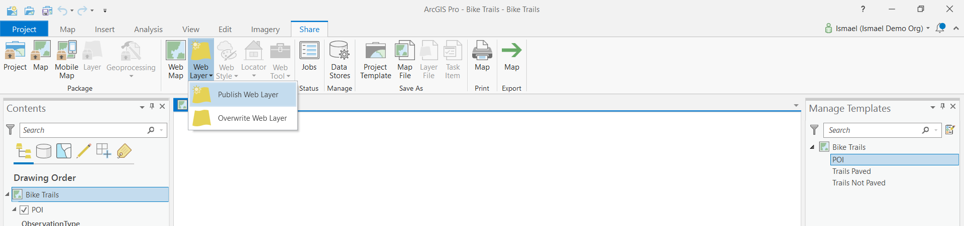

While your map tab is selected, open the Share ribbon and select Publish Web Layer option.
Within the Share as Web Layer geoprocessing tool, set the name, summary and tags in the General tab.
In the Configuration tab, check the Enable editing and allow editors to: Add, update and delete features. Check also the Sync operation.
Next, publish your feature service.

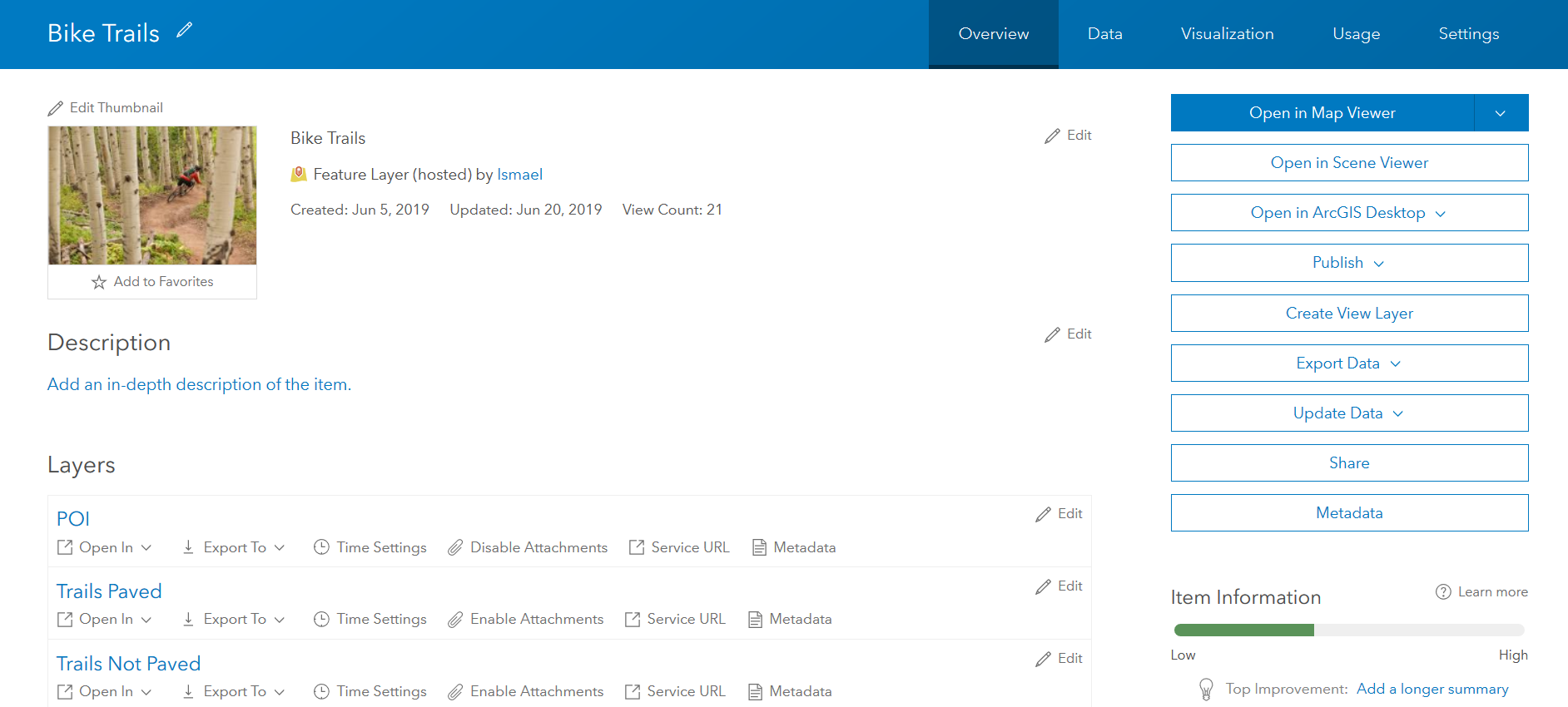

Using a web browser, login into your ArcGIS portal and open the item details page of your newly published feature service.

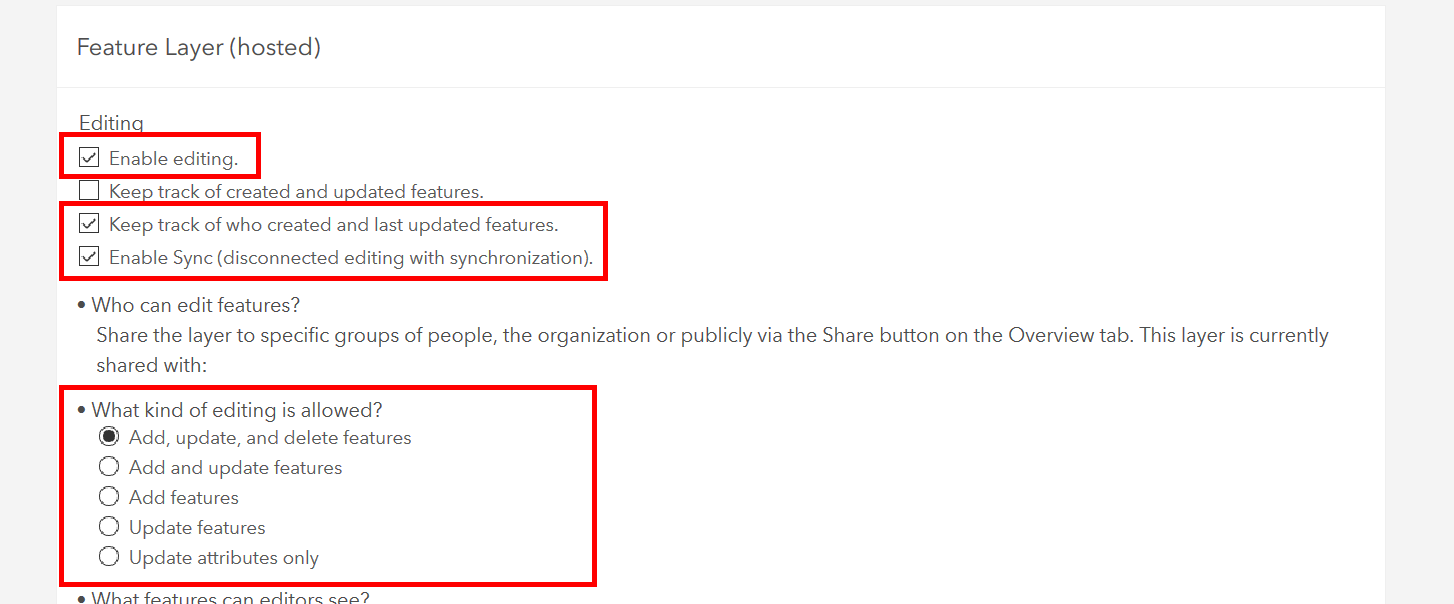

This will be the feature service where ArcGIS QuickCapture will store all data. Right from the item details page of your feature service, you can control some very important characteristics:
- Attachments: Make sure that the POI layer has attachments enabled, or otherwise you will not be able to capture photos when you capture Points of Interest from ArcGIS QuickCapture.
- Editing: If you switch to the Settings tab, you will be able to enable critical editing properties. Specifically:
- Enable editing: You must enable editing, or otherwise nobody (other than you) will be able to capture data on this layer.
- Keep track of who created and last updated features: This option enables Editor Tracking. This is optional, but very handy.
- Enable Sync: Also optional. ArcGIS QuickCapture does not use the Sync capabilities of a feature service at all, but enabling Sync will help making transactions from the mobile app more robust.
- What kind of editing is allowed: ArcGIS QuickCapture can only add new features to your feature service, so you do not need to enable update and delete operations. At the very least, you need to enable Add features.

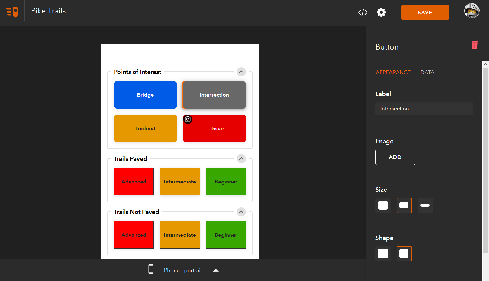

While feature services define the most fundamental aspects of QuickCapture projects, you can use QuickCapture designer to further configure and fine-tune your ArcGIS QuickCapture projects.
You can visually change properties of your project. For example:
- Change the color, size, shape and other display properties of buttons and groups.
- Reorder buttons within and across groups.
Note that at the bottom of the screen you can change the preview mode across different smartphone and tablet form factors.
Once you are happy with these changes, click on Save to persist your edits to the project.

We next are going to change the Data properties of buttons to better control what data is captured when you push a button.
Go back to ArcGIS QuickCapture designer in your web browser.

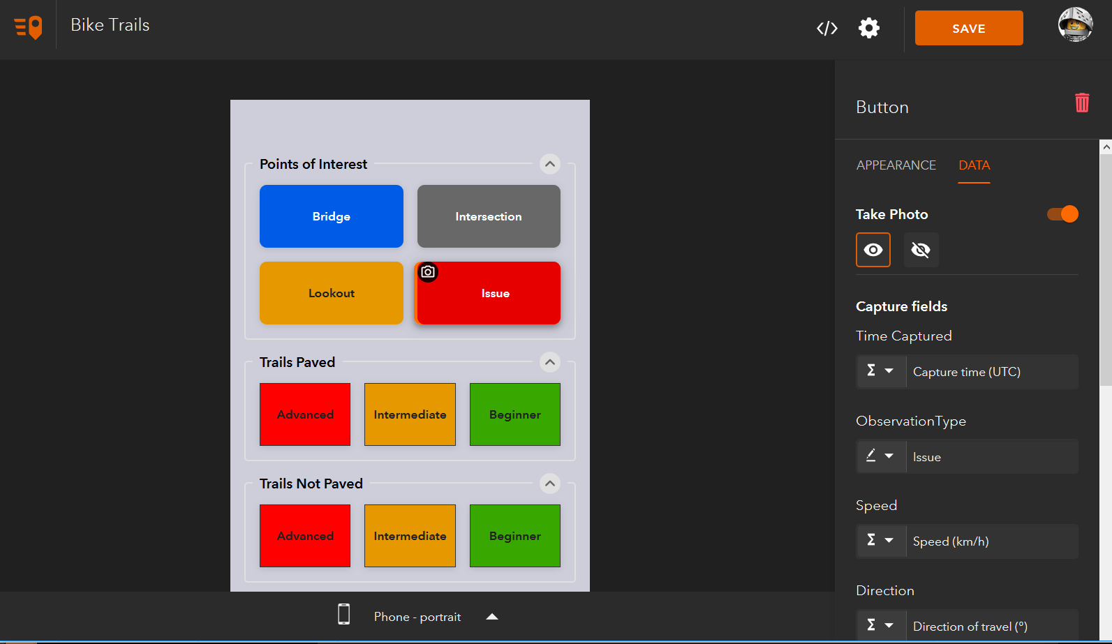

Click on the Issue button
Select the Data tab on the right panel
You will now be presented with the list of fields in the Points of Interest Layer.
You can set what value you want to store when the button is pushed. You can choose to add a fixed (constant) value, or pick a variable. For example, if you are interested in known when exactly a particular button was pushed, use the Capture time variable in the Time Captured field. You can also capture the speed, direction of travel and many other things.
Set the appropriate variables for the different fields shown for the Issue button.
Note that the Observation Type field has been automatically populated, because this field was set in ArcGIS Pro when defining the symbology of the layer. You will not want to change this value!
Once you have set variables to your fields. Click on Save to persist the changes.

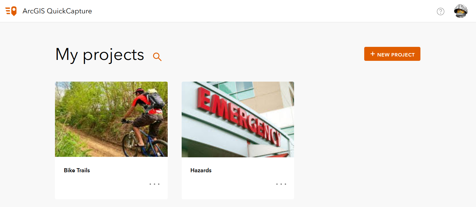

In your web browser, click on the QuickCapture icon in the top-left corner of QuickCapture designer to go back to the project gallery.
Hover your mouse over your Bike Trails project and click on View Results. This will add your project data into a web map for visualization.

Tip: If you want to define device variables for multiple buttons at once, use the SHIFT key in your keyboard to select multiple buttons at once, and then apply your variables to the whole selection.
Through the Data tab you can also enable photos. If you do not see the option, you need to go back to the feature service item details page in your portal and enable attachments on the POI layer. Then you will need to reload QuickCapture designer. Photos on polyline buttons are not supported.

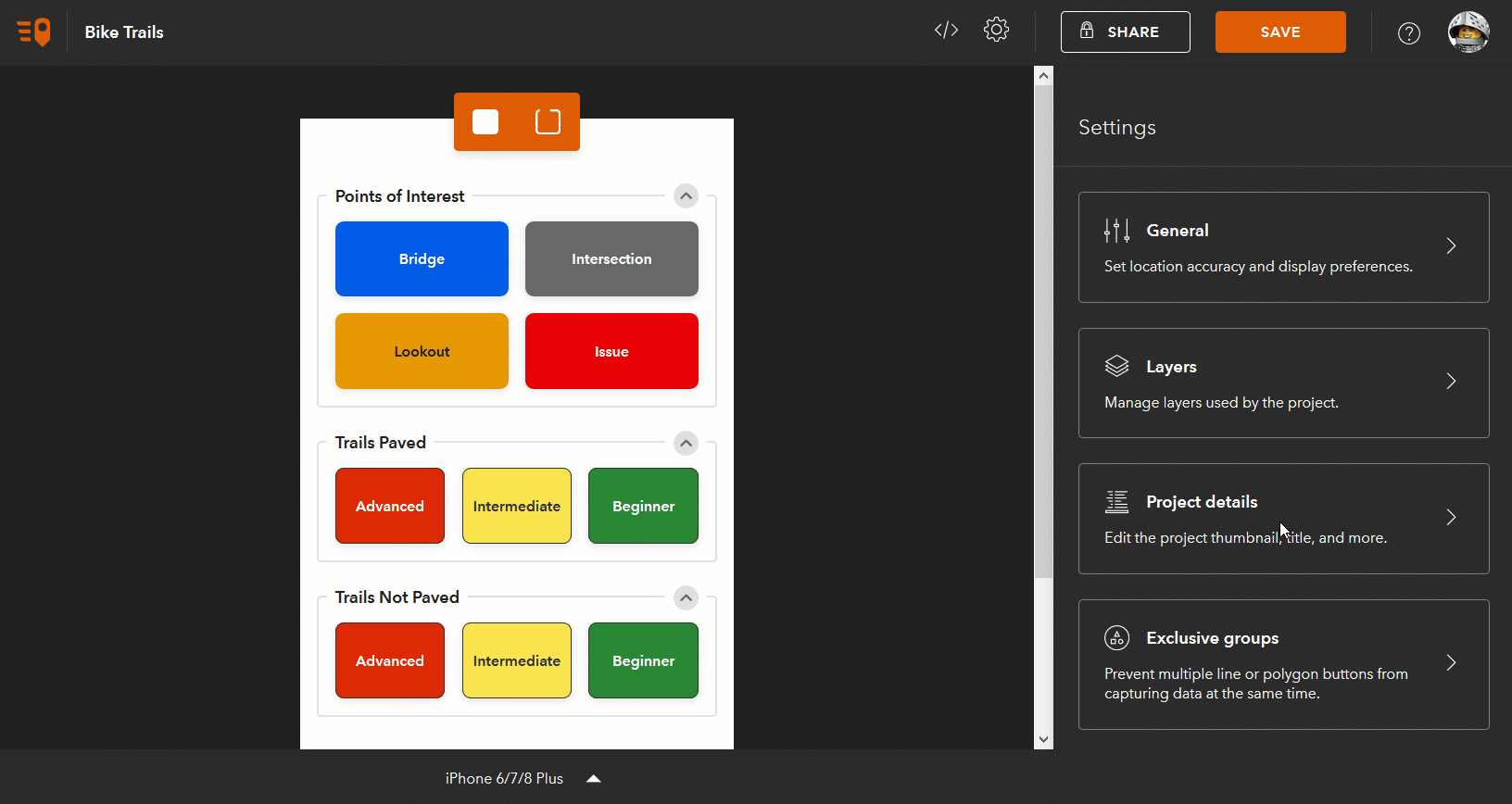

Creating exclusivity groups
A bike trail can either be paved, or non-paved, but not both. Similarly, the trail can be cataloged as for beginners or for advanced cyclists, but not both. We will define an exclusivity group to make sure that only one of these 6 buttons can be active at any time.
Click on the Settings gear in the top panel
Select the Exclusivity Group section and add the 6 trail buttons to a new exclusivity group
If you now test you changes in the mobile app, you will notice that only one button within your exclusivity group will be active at any time. For details on exclusivity groups check the https://community.esri.com/community/arcgis-quickcapture/blog/2019/10/01/understanding-exclusivity-groups-in-arcgis-quickcapture blog post.
