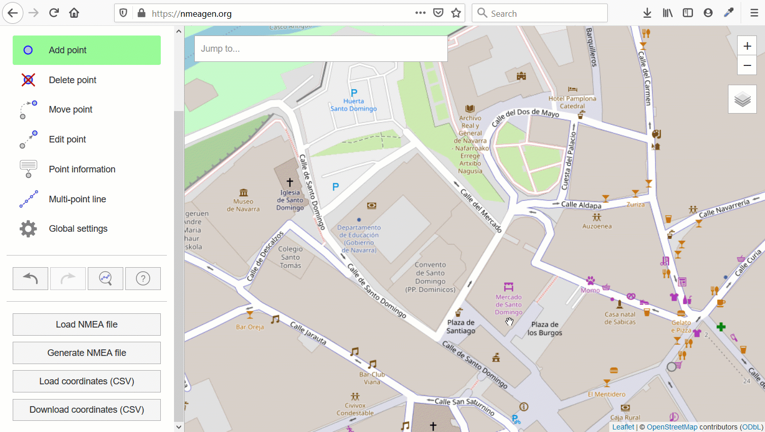

How to create a custom NMEA file using nmeagen.org
One particular tool I like to use to create NMEA files is https://nmeagen.org/. Here is a video showing how easy it is:
If you have a shapefile with a line representing a path, you can use the Feature Vertices To Points—Data Management toolbox | Documentation tool in ArcGIS Pro to create a point layer, then run the Add Geometry Attributes—Data Management toolbox | Documentation tool and export the coordinates to a CSV file. The CSV file can then be transformed into a NMEA file using nmeagen.org.

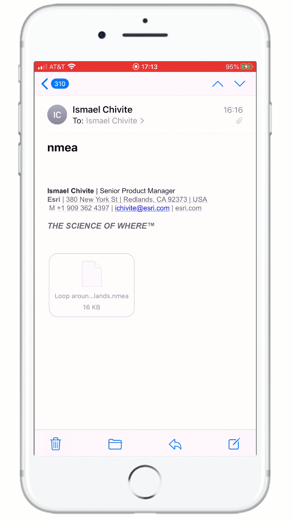

In iOS, the easiest way to transfer the NMEA file is via e-mail, as an attachment:
- Add your NMEA file to an email as an attachment and send it to yourself.
- In your email client, select the attachment file and swipe up
- Select Save to Files and move the file to the QuickCapture directory.
The animation on the right side shows the steps. You simply need to use the operating system 'Save to Files' option and select as the destination the QuickCapture folder in your device.

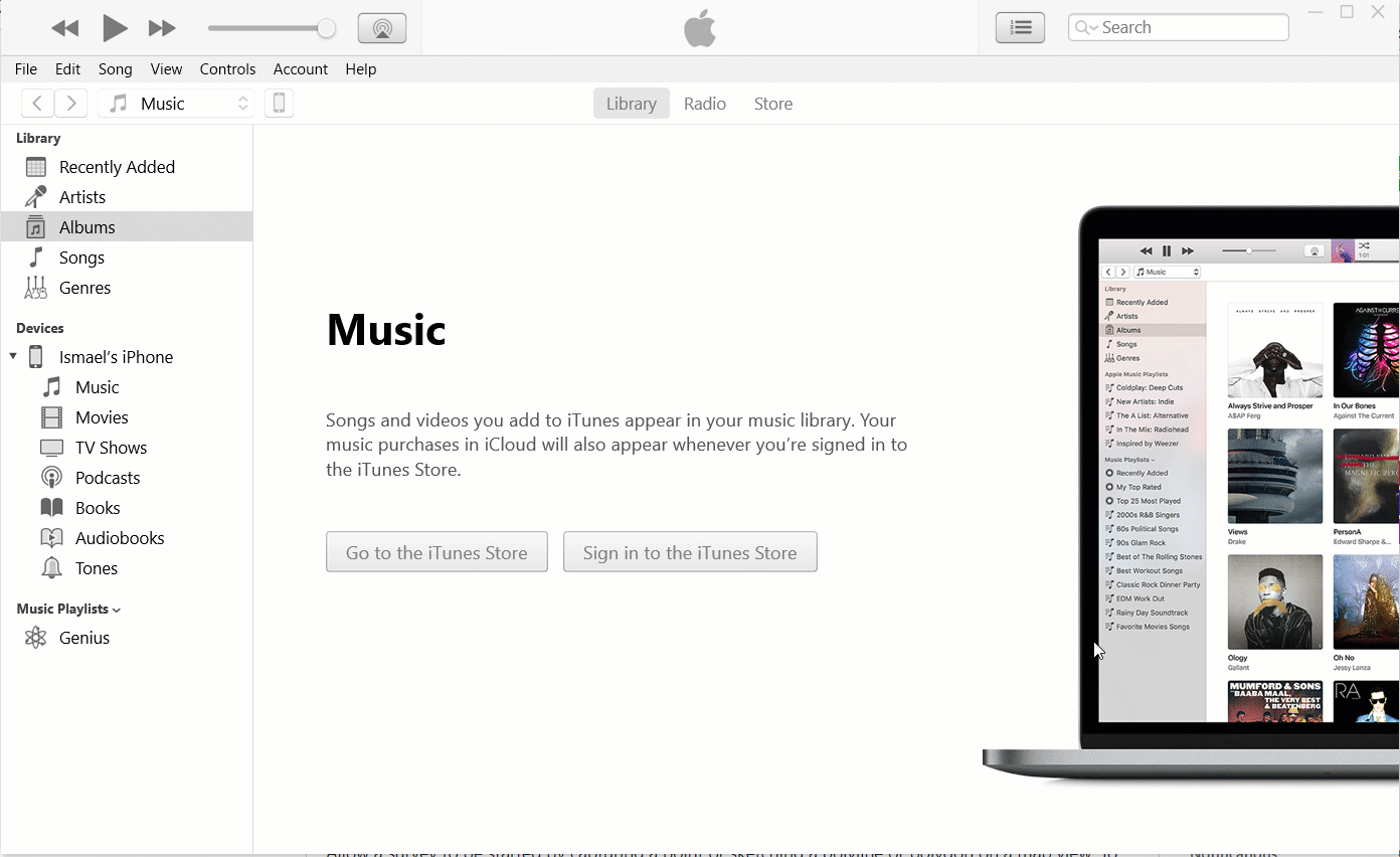

Alternatively, you can also connect your iOS device to your laptop and use iTunes as shown in the animation below:

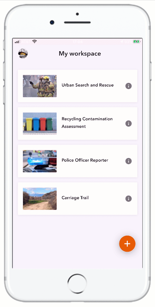

- While in the project gallery, tap on your profile icon.
- Go to Settings
- Open the Location Provider section
- Tap on Via File
- Browse for your NMEA log file
- Tap on Add (IMPORTANT!)
- Return to the project gallery and open your project
