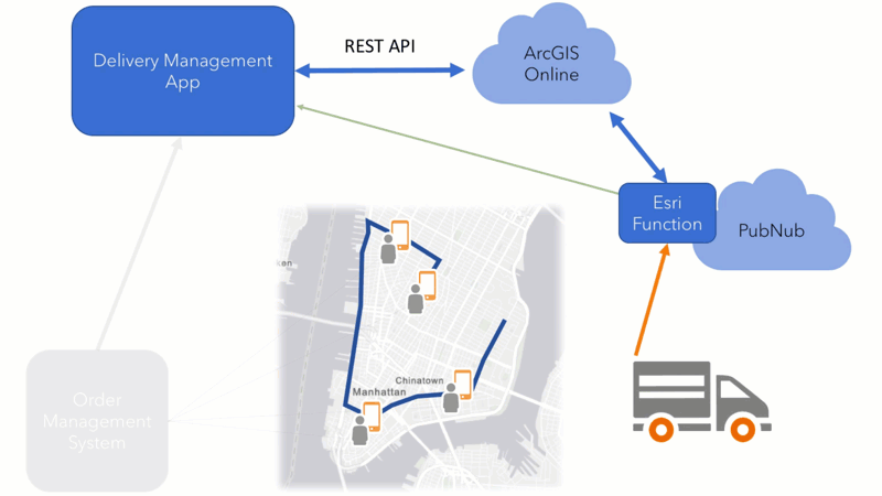

The demo consists of a Delivery Management App for monitoring delivery routes and a PubNub Function for handling realtime updates. This app is built using the ArcGIS API for JavaScript and makes use of Calcite Maps. Skip to about 18:35 in the video to see the demo in action.
The app assigns a set of deliveries to a driver and the optimized order is calculated using ArcGIS Online's RouteTask. For each delivery, a geofence is calculated using the ServiceAreaTask. These are used to alert a customer when the driver is five minutes away with their delivery. The route geometry and geofences are stored in ArcGIS Online Feature Services, and the driver is dispatched.
As the driver progresses, their updated location is posted to the PubNub Function. PubNub uses the geofences stored in ArcGIS Online to determine when the driver enters the geofence for the next delivery (e.g., is five minutes away), and the customer is notified that their delivery is about to arrive.
