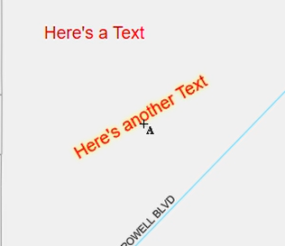

Now I don't know about you, but I find the OverlayItemsControl to be a great way to add interactive text to a map. You can have it respond to a mouse-over:

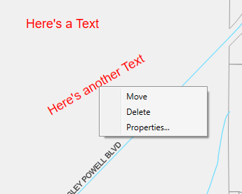

Bring up a context menu:

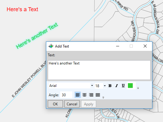

Modify properties:
