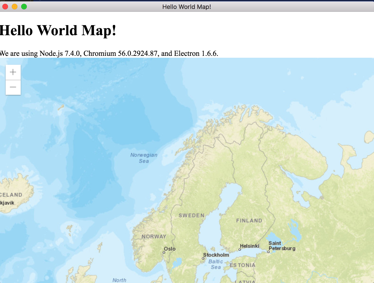

Ever wondered about using your HTML, CSS and JavaScript skills to build a desktop mapping app? Electron gives you the power to do just that. The really sweet part is that Electron, similar to hybrid web applications such Cordova, gives you access to the underlying operating system in ways that pure web apps can't.
Below I've provided a fun, 5 minute lab that shows you one way to build a bare-bones prototype. I've taken the simplest approach I could think of and used plain-old vanilla JavaScript without any framework. At the end of the post there are a few links to several other approaches that you should also check out. You can definitely use the modern JavaScript framework of your choice once you get going such as Angular, Vue.js, etc.
Pre-reqs - I'm assuming you already have git and node.js installed.
Step 1 - Run the following commands in console, Once you run all the commands the electron-quick-start app should launch and you should have a Hello World app, booyah! If it does launch then control-c in the console to exit the app.

Step 2 - Overwrite the index.html file by using this code instead. This is were we start bolting in the ArcGIS API for JavaScript mapping bits.

A few other examples using the ArcGIS API for JavaScript:
Angular CLI example - GitHub - TheKeithStewart/ng-cli-electron-esri
Drop Shapefiles into Electron Map - Electron with ArcGIS API for JavaScript - odoenet
