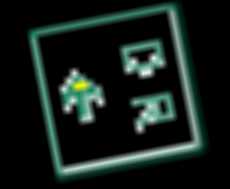

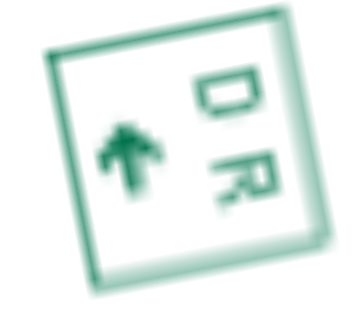

Yikes! This problem was identified at 100.1 and fixed in 100.2, but at 100.5 once more it rears its ugly head. One workaround is to set ArcGISFeatureTable.UseAdvancedSymbology to false. This causes marker symbols to be rendered as picture markers. That's fine until you run into two limitations. The first is when you set a reference scale and zoom in:
But even more challenging, what if you want to change symbol colors on the fly? In theory, you can do that with a bitmap, but it's beyond my skill to deal with the dithering:

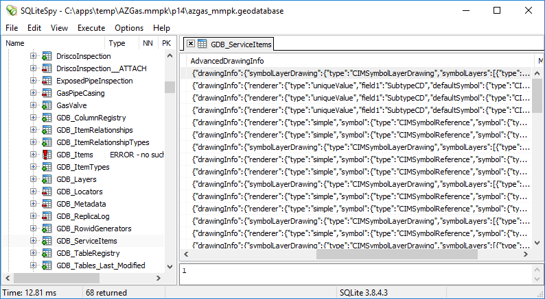

There's another approach, but until Esri implements more fine-grained class properties and methods, manipulating symbols involves a lot of JSON hacking. Before I go any further, let's crack open a mobile map package and see where drawing information is stored. If you examine the mobile geodatabase using a tool such as SQLiteSpy, you will see a table called GDB_ServiceItems:
That's the raw JSON for the data retrieved by ArcGISFeatureTable.LayerInfo.DrawingInfo. Fortunately, there's no need to hack into the table, because you can get the renderer for a feature layer, retrieve the symbol(s), and convert them to JSON. Then you make whatever edits you want, and create a new symbol.
