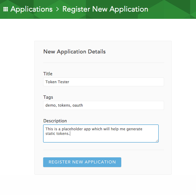

Just login to http://developers.arcgis.com using your Organizational credentials (or free developer account) and click on the 'Applications' icon in the top righthand corner.
If you've already created arcgis.com items for your applications, they'll appear. If you haven't, creating a new registered placeholder app takes less than a minute.

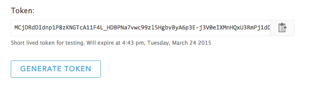

Afterward, not only can you retrieve a 'ClientId' and 'ClientSecret' for authenticating on behalf of your end users to consume services that burn credits in the app you're yet to write, but there's also a static token with an incredibly handy copy to clipboard link which can be used temporarily for testing while you're still figuring out exactly what you'd like to do.
Create your own, add it to a request like this, and paste into the browser to see how easy it is to start routing
http://route.arcgis.com/arcgis/rest/services/World/Route/NAServer/Route_World/solve?token=<paste-yours-here>&stops=-122.4079,37.78356;-122.404,37.782&f=pjson
