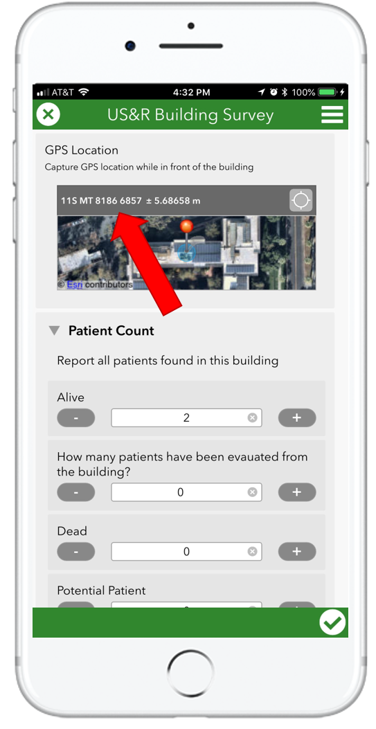

Geopoint questions in your form will always display the coordinates of the selected location as well as a map in preview mode.
In the survey shown on the side, for example, the current location of the device is shown in USNG notation, along with the estimated horizontal accuracy.
The coordinate format to be shown in the map preview is configurable by the author of the survey as follows:

Being able to quickly read a geopoint location in USNG or MGRS coordinates from the map preview in your survey can be very useful. For example, a Search and Rescue team that needs to communicate its own location or the location of an event over the radio can read the coordinates directly from the map preview.

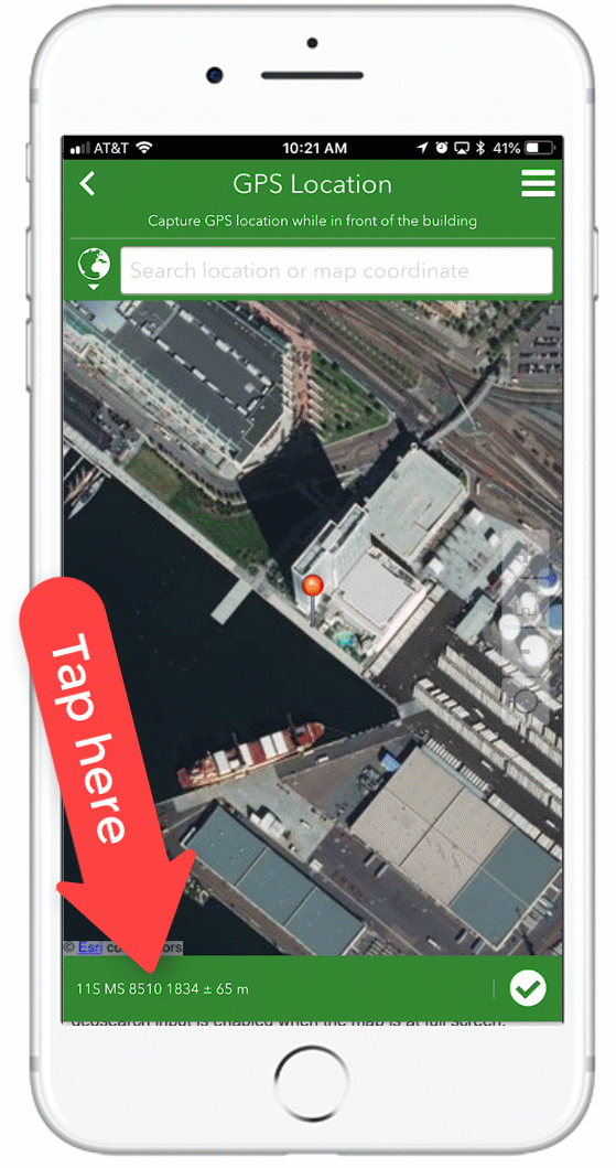

The map preview as described above is intended to give the field user quick access to visualize a selected location and its coordinates. By tapping on the map preview, Survey123 will bring the map into full screen, or detailed mode, and switch into interactive mode.
When the Survey123 map is expanded to full screen, the map coordinate display is at the bottom. Note that the coordinates change as the map is panned around. For example, you can use the geosearch to find an address and immediately get the MGRS coordinates. Or you can refresh your location using the device's GPS and get the coordinates again.
If you would like to copy the coordinate readout into your clipboard, you can tap the bottom panel and that will switch the geosearch control at the top to map coordinate entry. Note again that in this mode, as you pan the map the coordinates will change dynamically in the geosearch control, from which you can easily copy them into your clipboard.
