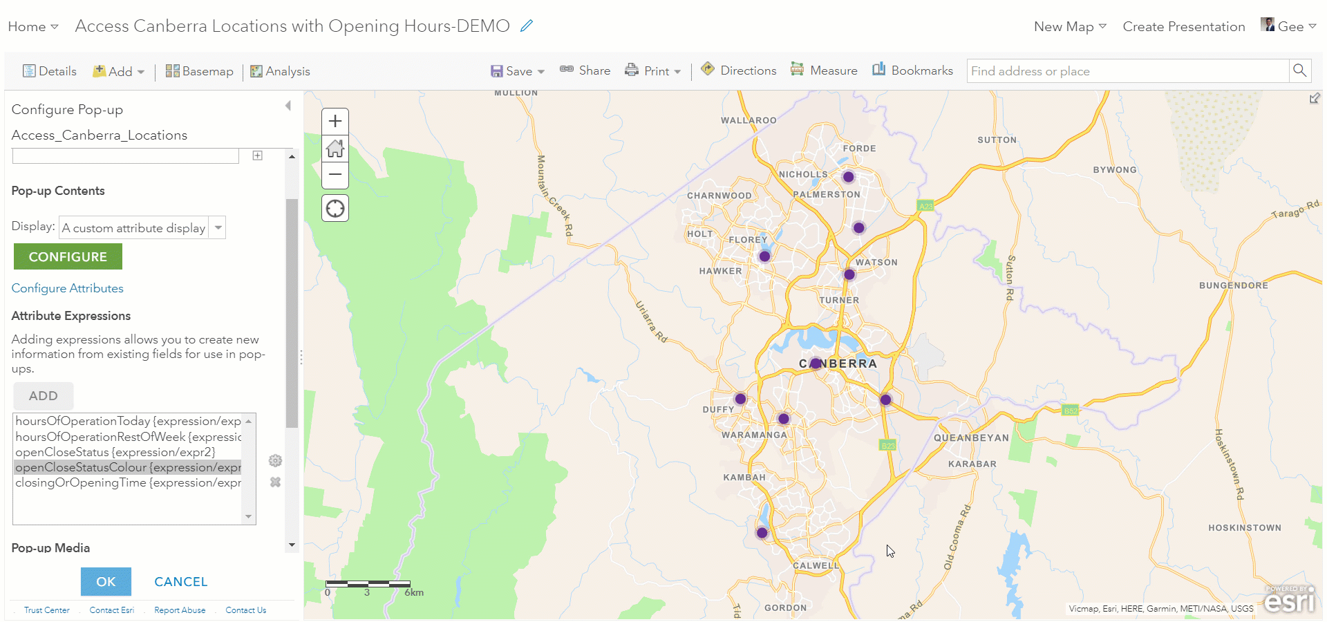

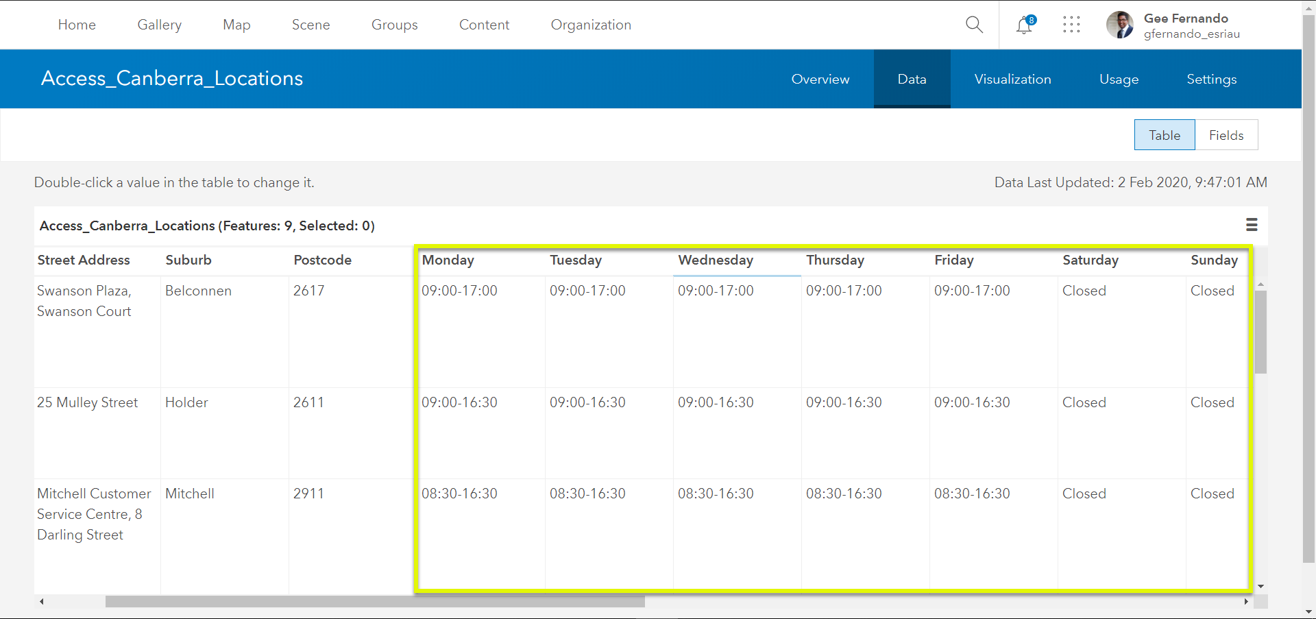

First, find or create a data-set with opening hours (preferably for all days of the week). For this example I’ll be using Access Canberra locations (sourced from - dataACT). Please ensure opening hours are saved as numbers or text field types.
Build expressions
Within the pop-up configuration window - build the following expressions or feel free to follow along with this web map.

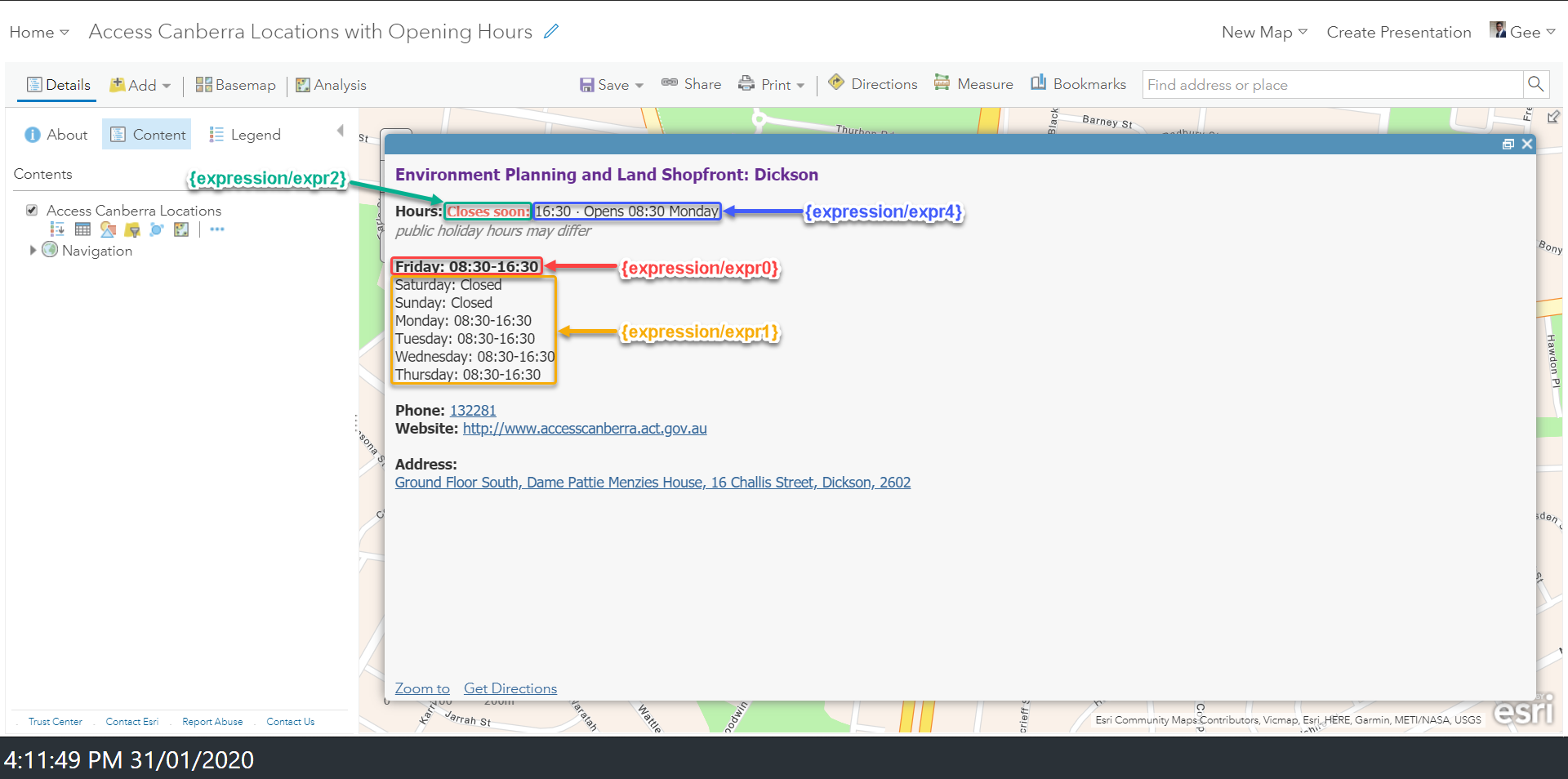

hoursOfOperationToday {expression/expr0}
This expression will return the current weekday alongside its opening hours.
For example:
Thursday: 08:30-16:30
<SPAN class="keyword token">var</SPAN> weekDays <SPAN class="operator token">=</SPAN> <SPAN class="punctuation token">[</SPAN><SPAN class="string token">'Sunday'</SPAN><SPAN class="punctuation token">,</SPAN><SPAN class="string token">'Monday'</SPAN><SPAN class="punctuation token">,</SPAN><SPAN class="string token">'Tuesday'</SPAN><SPAN class="punctuation token">,</SPAN><SPAN class="string token">'Wednesday'</SPAN><SPAN class="punctuation token">,</SPAN><SPAN class="string token">'Thursday'</SPAN><SPAN class="punctuation token">,</SPAN><SPAN class="string token">'Friday'</SPAN><SPAN class="punctuation token">,</SPAN><SPAN class="string token">'Saturday'</SPAN><SPAN class="punctuation token">]</SPAN>
<SPAN class="comment token">//Returns the current weekday. Values range from 0-6 where sunday is 0 and saturday is 6</SPAN>
<SPAN class="keyword token">var</SPAN> currentWeekDay <SPAN class="operator token">=</SPAN> <SPAN class="token function">Weekday</SPAN><SPAN class="punctuation token">(</SPAN><SPAN class="token function">Now</SPAN><SPAN class="punctuation token">(</SPAN><SPAN class="punctuation token">)</SPAN><SPAN class="punctuation token">)</SPAN>
<SPAN class="comment token">//Return weekday followed by opening hours</SPAN>
<SPAN class="keyword token">var</SPAN> hoursOfOperationToday <SPAN class="operator token">=</SPAN> weekDays<SPAN class="punctuation token">[</SPAN>currentWeekDay<SPAN class="punctuation token">]</SPAN> <SPAN class="operator token">+</SPAN> <SPAN class="string token">": "</SPAN> <SPAN class="operator token">+</SPAN> $feature<SPAN class="punctuation token">[</SPAN>weekDays<SPAN class="punctuation token">[</SPAN>currentWeekDay<SPAN class="punctuation token">]</SPAN><SPAN class="punctuation token">]</SPAN>
<SPAN class="keyword token">return</SPAN> hoursOfOperationToday<SPAN class="line-numbers-rows"><SPAN></SPAN><SPAN></SPAN><SPAN></SPAN><SPAN></SPAN><SPAN></SPAN><SPAN></SPAN><SPAN></SPAN><SPAN></SPAN><SPAN></SPAN></SPAN>
hoursOfOperationRestOfWeek {expression/expr1}
This expression will return the remaining weekdays alongside their opening hours.
For example:
Friday: 08:30-16:30
Saturday: Closed
Sunday: Closed
Monday: 08:30-16:30
Tuesday: 08:30-16:30
Wednesday: 08:30-16:30
<SPAN class="keyword token">var</SPAN> weekDays <SPAN class="operator token">=</SPAN> <SPAN class="punctuation token">[</SPAN><SPAN class="string token">'Sunday'</SPAN><SPAN class="punctuation token">,</SPAN><SPAN class="string token">'Monday'</SPAN><SPAN class="punctuation token">,</SPAN><SPAN class="string token">'Tuesday'</SPAN><SPAN class="punctuation token">,</SPAN><SPAN class="string token">'Wednesday'</SPAN><SPAN class="punctuation token">,</SPAN><SPAN class="string token">'Thursday'</SPAN><SPAN class="punctuation token">,</SPAN><SPAN class="string token">'Friday'</SPAN><SPAN class="punctuation token">,</SPAN><SPAN class="string token">'Saturday'</SPAN><SPAN class="punctuation token">,</SPAN><SPAN class="string token">'Sunday'</SPAN><SPAN class="punctuation token">,</SPAN><SPAN class="string token">'Monday'</SPAN><SPAN class="punctuation token">,</SPAN><SPAN class="string token">'Tuesday'</SPAN><SPAN class="punctuation token">,</SPAN><SPAN class="string token">'Wednesday'</SPAN><SPAN class="punctuation token">,</SPAN><SPAN class="string token">'Thursday'</SPAN><SPAN class="punctuation token">,</SPAN><SPAN class="string token">'Friday'</SPAN><SPAN class="punctuation token">]</SPAN><SPAN class="punctuation token">;</SPAN>
<SPAN class="keyword token">var</SPAN> hoursOfOperationRestOfWeek <SPAN class="operator token">=</SPAN> <SPAN class="string token">""</SPAN>
<SPAN class="comment token">//Iterate over the weekdays and opening hours for the remaning 6 days of the week</SPAN>
<SPAN class="keyword token">for</SPAN><SPAN class="punctuation token">(</SPAN><SPAN class="keyword token">var</SPAN> i <SPAN class="operator token">=</SPAN> currentWeekDay <SPAN class="operator token">+</SPAN> <SPAN class="number token">1</SPAN><SPAN class="punctuation token">;</SPAN> i <SPAN class="operator token"><</SPAN> currentWeekDay <SPAN class="operator token">+</SPAN> <SPAN class="number token">7</SPAN><SPAN class="punctuation token">;</SPAN> i<SPAN class="operator token">++</SPAN><SPAN class="punctuation token">)</SPAN><SPAN class="punctuation token">{</SPAN>
hoursOfOperationRestOfWeek <SPAN class="operator token">+</SPAN><SPAN class="operator token">=</SPAN> weekDays<SPAN class="punctuation token">[</SPAN>i<SPAN class="punctuation token">]</SPAN> <SPAN class="operator token">+</SPAN> <SPAN class="string token">": "</SPAN> <SPAN class="operator token">+</SPAN> $feature<SPAN class="punctuation token">[</SPAN>weekDays<SPAN class="punctuation token">[</SPAN>i<SPAN class="punctuation token">]</SPAN><SPAN class="punctuation token">]</SPAN> <SPAN class="operator token">+</SPAN> TextFormatting<SPAN class="punctuation token">.</SPAN>NewLine
<SPAN class="punctuation token">}</SPAN>
<SPAN class="keyword token">return</SPAN> hoursOfOperationRestOfWeek<SPAN class="line-numbers-rows"><SPAN></SPAN><SPAN></SPAN><SPAN></SPAN><SPAN></SPAN><SPAN></SPAN><SPAN></SPAN><SPAN></SPAN><SPAN></SPAN><SPAN></SPAN><SPAN></SPAN><SPAN></SPAN><SPAN></SPAN><SPAN></SPAN></SPAN>openCloseStatus {expression/expr2}

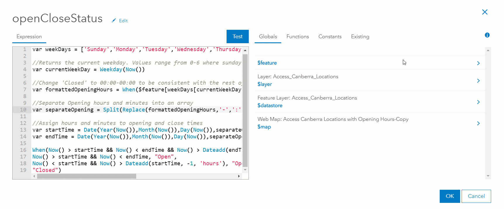

This expression will return whether the shopfront is Open, Closed, Opens soon or Closing soon based on opening hours and the time displayed on users' device
<SPAN class="comment token">//Change 'Closed' to 00:00-00:00 to be consistent with the rest of opening hours information</SPAN>
<SPAN class="keyword token">var</SPAN> formattedOpeningHours <SPAN class="operator token">=</SPAN> <SPAN class="token function">When</SPAN><SPAN class="punctuation token">(</SPAN>$feature<SPAN class="punctuation token">[</SPAN>weekDays<SPAN class="punctuation token">[</SPAN>currentWeekDay<SPAN class="punctuation token">]</SPAN><SPAN class="punctuation token">]</SPAN> <SPAN class="operator token">==</SPAN> <SPAN class="string token">"Closed"</SPAN><SPAN class="punctuation token">,</SPAN> <SPAN class="string token">"00:00-00:00"</SPAN><SPAN class="punctuation token">,</SPAN> $feature<SPAN class="punctuation token">[</SPAN>weekDays<SPAN class="punctuation token">[</SPAN>currentWeekDay<SPAN class="punctuation token">]</SPAN><SPAN class="punctuation token">]</SPAN><SPAN class="punctuation token">)</SPAN>
<SPAN class="comment token">//Separate Opening hours and minutes into an array</SPAN>
<SPAN class="keyword token">var</SPAN> separateOpening <SPAN class="operator token">=</SPAN> <SPAN class="token function">Split</SPAN><SPAN class="punctuation token">(</SPAN><SPAN class="token function">Replace</SPAN><SPAN class="punctuation token">(</SPAN>formattedOpeningHours<SPAN class="punctuation token">,</SPAN><SPAN class="string token">'-'</SPAN><SPAN class="punctuation token">,</SPAN><SPAN class="string token">':'</SPAN><SPAN class="punctuation token">)</SPAN><SPAN class="punctuation token">,</SPAN><SPAN class="string token">':'</SPAN><SPAN class="punctuation token">)</SPAN>
<SPAN class="comment token">//Assign hours and minutes to opening and close times</SPAN>
<SPAN class="keyword token">var</SPAN> startTime <SPAN class="operator token">=</SPAN> <SPAN class="token function">Date</SPAN><SPAN class="punctuation token">(</SPAN><SPAN class="token function">Year</SPAN><SPAN class="punctuation token">(</SPAN><SPAN class="token function">Now</SPAN><SPAN class="punctuation token">(</SPAN><SPAN class="punctuation token">)</SPAN><SPAN class="punctuation token">)</SPAN><SPAN class="punctuation token">,</SPAN><SPAN class="token function">Month</SPAN><SPAN class="punctuation token">(</SPAN><SPAN class="token function">Now</SPAN><SPAN class="punctuation token">(</SPAN><SPAN class="punctuation token">)</SPAN><SPAN class="punctuation token">)</SPAN><SPAN class="punctuation token">,</SPAN><SPAN class="token function">Day</SPAN><SPAN class="punctuation token">(</SPAN><SPAN class="token function">Now</SPAN><SPAN class="punctuation token">(</SPAN><SPAN class="punctuation token">)</SPAN><SPAN class="punctuation token">)</SPAN><SPAN class="punctuation token">,</SPAN>separateOpening<SPAN class="punctuation token">[</SPAN><SPAN class="number token">0</SPAN><SPAN class="punctuation token">]</SPAN><SPAN class="punctuation token">,</SPAN>separateOpening<SPAN class="punctuation token">[</SPAN><SPAN class="number token">1</SPAN><SPAN class="punctuation token">]</SPAN><SPAN class="punctuation token">)</SPAN>
<SPAN class="keyword token">var</SPAN> endTime <SPAN class="operator token">=</SPAN> <SPAN class="token function">Date</SPAN><SPAN class="punctuation token">(</SPAN><SPAN class="token function">Year</SPAN><SPAN class="punctuation token">(</SPAN><SPAN class="token function">Now</SPAN><SPAN class="punctuation token">(</SPAN><SPAN class="punctuation token">)</SPAN><SPAN class="punctuation token">)</SPAN><SPAN class="punctuation token">,</SPAN><SPAN class="token function">Month</SPAN><SPAN class="punctuation token">(</SPAN><SPAN class="token function">Now</SPAN><SPAN class="punctuation token">(</SPAN><SPAN class="punctuation token">)</SPAN><SPAN class="punctuation token">)</SPAN><SPAN class="punctuation token">,</SPAN><SPAN class="token function">Day</SPAN><SPAN class="punctuation token">(</SPAN><SPAN class="token function">Now</SPAN><SPAN class="punctuation token">(</SPAN><SPAN class="punctuation token">)</SPAN><SPAN class="punctuation token">)</SPAN><SPAN class="punctuation token">,</SPAN>separateOpening<SPAN class="punctuation token">[</SPAN><SPAN class="number token">2</SPAN><SPAN class="punctuation token">]</SPAN><SPAN class="punctuation token">,</SPAN>separateOpening<SPAN class="punctuation token">[</SPAN><SPAN class="number token">3</SPAN><SPAN class="punctuation token">]</SPAN><SPAN class="punctuation token">)</SPAN>
<SPAN class="token function">When</SPAN><SPAN class="punctuation token">(</SPAN><SPAN class="token function">Now</SPAN><SPAN class="punctuation token">(</SPAN><SPAN class="punctuation token">)</SPAN> <SPAN class="operator token">></SPAN> startTime <SPAN class="operator token">&&</SPAN> <SPAN class="token function">Now</SPAN><SPAN class="punctuation token">(</SPAN><SPAN class="punctuation token">)</SPAN> <SPAN class="operator token"><</SPAN> endTime <SPAN class="operator token">&&</SPAN> <SPAN class="token function">Now</SPAN><SPAN class="punctuation token">(</SPAN><SPAN class="punctuation token">)</SPAN> <SPAN class="operator token">></SPAN> <SPAN class="token function">Dateadd</SPAN><SPAN class="punctuation token">(</SPAN>endTime<SPAN class="punctuation token">,</SPAN> <SPAN class="operator token">-</SPAN><SPAN class="number token">1</SPAN><SPAN class="punctuation token">,</SPAN> <SPAN class="string token">'hours'</SPAN><SPAN class="punctuation token">)</SPAN><SPAN class="punctuation token">,</SPAN> <SPAN class="string token">"Closes soon:"</SPAN><SPAN class="punctuation token">,</SPAN>
<SPAN class="token function">Now</SPAN><SPAN class="punctuation token">(</SPAN><SPAN class="punctuation token">)</SPAN> <SPAN class="operator token">></SPAN> startTime <SPAN class="operator token">&&</SPAN> <SPAN class="token function">Now</SPAN><SPAN class="punctuation token">(</SPAN><SPAN class="punctuation token">)</SPAN> <SPAN class="operator token"><</SPAN> endTime<SPAN class="punctuation token">,</SPAN> <SPAN class="string token">"Open"</SPAN><SPAN class="punctuation token">,</SPAN>
<SPAN class="token function">Now</SPAN><SPAN class="punctuation token">(</SPAN><SPAN class="punctuation token">)</SPAN> <SPAN class="operator token"><</SPAN> startTime <SPAN class="operator token">&&</SPAN> <SPAN class="token function">Now</SPAN><SPAN class="punctuation token">(</SPAN><SPAN class="punctuation token">)</SPAN> <SPAN class="operator token">></SPAN> <SPAN class="token function">Dateadd</SPAN><SPAN class="punctuation token">(</SPAN>startTime<SPAN class="punctuation token">,</SPAN> <SPAN class="operator token">-</SPAN><SPAN class="number token">1</SPAN><SPAN class="punctuation token">,</SPAN> <SPAN class="string token">'hours'</SPAN><SPAN class="punctuation token">)</SPAN><SPAN class="punctuation token">,</SPAN> <SPAN class="string token">"Opens soon"</SPAN><SPAN class="punctuation token">,</SPAN>
<SPAN class="string token">"Closed"</SPAN><SPAN class="punctuation token">)</SPAN><SPAN class="line-numbers-rows"><SPAN></SPAN><SPAN></SPAN><SPAN></SPAN><SPAN></SPAN><SPAN></SPAN><SPAN></SPAN><SPAN></SPAN><SPAN></SPAN><SPAN></SPAN><SPAN></SPAN><SPAN></SPAN><SPAN></SPAN><SPAN></SPAN><SPAN></SPAN><SPAN></SPAN><SPAN></SPAN><SPAN></SPAN><SPAN></SPAN><SPAN></SPAN></SPAN>

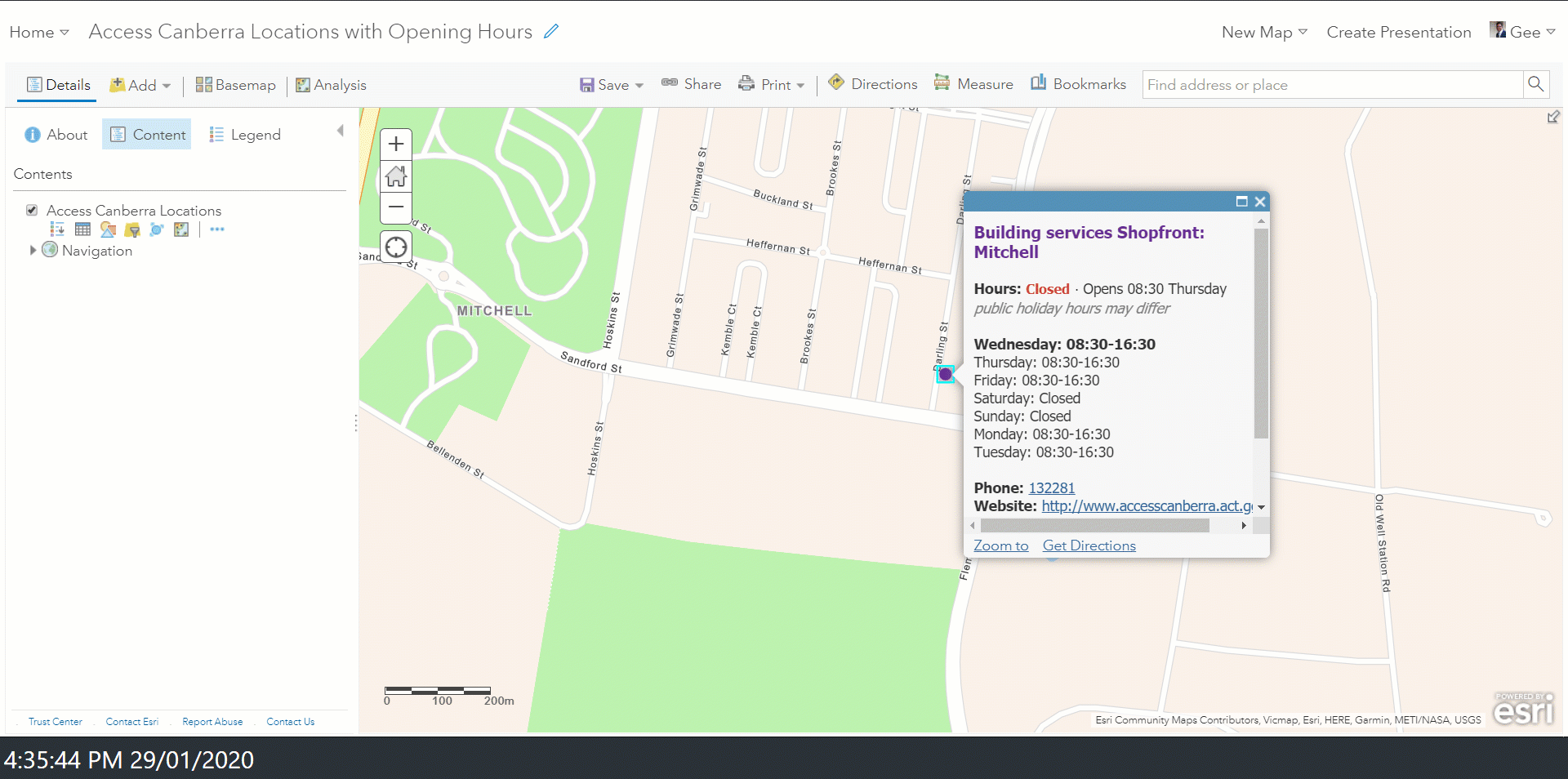

openCloseStatusColour {expression/expr3}
If you'd like to re-iterate the openCloseStatus values with added colour - rewrite and replace previous expression's return values with hexadecimal colour values.
For example:
#239B56 ⋅ Open
#CB4335 ⋅ Closed
#2ECC71 ⋅ Opens soon
#EC7063 ⋅ Closing soon

closingOrOpeningTime {expression/expr4}
This expression can look a little daunting at first, but like any other piece of code - go through one line at a time and use your own test environment to test and experiment
It will return the:
- closing time, if the Access Canberra shop front is Open or Closes soon.
- opening time for the current day, if it Opens soon, or Closed (before hours).
- and next opening day and time, if it's Closed (after hours), Closes soon or Closed for the whole day.
