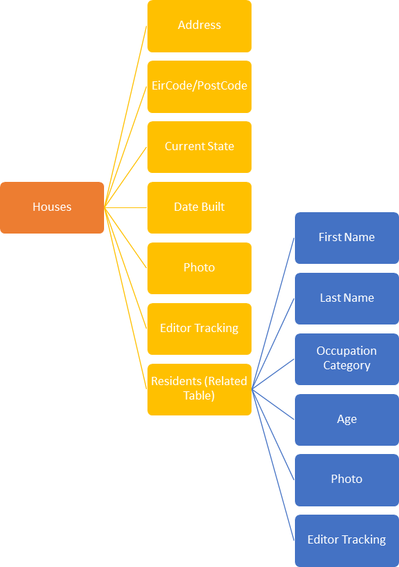

The answer is in its name! Related data is data that has an association or relationship with another piece of data. I think the easiest way to explain related data is with a real case example:
Lets say you were collecting housing data in a particular area. You want to collect data about the house itself, for example its address, type, condition, date built, etc. You also want to collect data about the residents in each house. For each resident, you want to collect their name, date of birth, occupation, etc. Some houses will obviously have multiple residents. If you were to store all this data in the one table, you would have to have an infinite list of fields for the residents (resident one name, resident one date of birth, resident one occupation, resident two name, resident two date of birth, resident two occupation, etc.). This is obviously inefficient and impractical. In order to deal with this, you setup two separate tables, one for houses, and one for residents. You setup a unique identifier for each row in the houses table, and then for each resident we store a reference to this meaning that you can look at house, and then check what houses are related based on this value. In database lingo, this structure has a 'cardinality' of one to many, whereby the house has an association or relationship with multiple residents. an illustration of this can be found below:
There are two other main types of relationships; one to one and many to many. A one to one relationship refers to cases whereby one record is associated with another record. For example a husband may be associated with his wife. A many to many relationship refers to cases whereby many records are associated with many other records. Students and subjects is the typical example that is used. A student may study multiple subjects at school, while a subject may be studied by multiple students.
Finally relationships can also be nested. You may want to store related data about related data! For example, you may want to gather information about the cars that residents own. In that case, your data would contain information about Houses which may contain many Residents who may own many Cars. You can find out more about Relationships and ArcGIS here.
