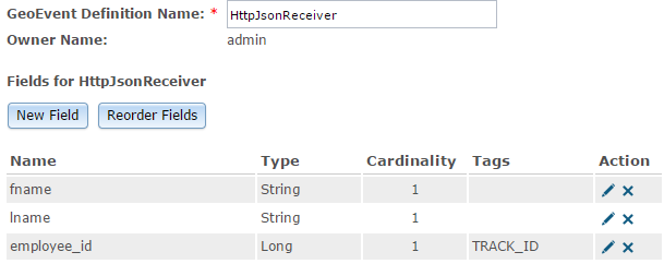

- Create the following GeoEvent Definition

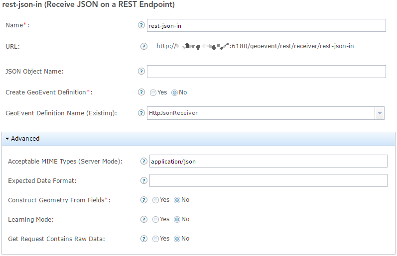

- Configure the following GeoEvent Server input connector
Note the new 10.5 parameter: Get Request Contains Raw Data
Review the help tip provided for this parameter. If the inbound connector is running in SERVER mode and receives an HTTP/GET request, if the request content body is empty and the request URL includes query parameters, the default (‘No’) will consider each name/value pair as a separate attribute value in an event record. If the default is changed to ‘Yes’ you will be expected to specify the one query parameter which will be considered the event’s raw data.

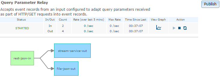

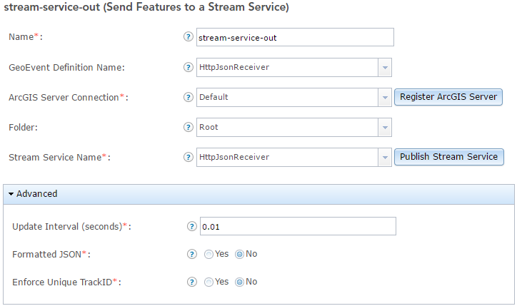

- Configure a GeoEvent Server output connector and publish a GeoEvent Service
You can use any outbound connector which supports JSON event record displays. Recommended output connectors are ‘Send Features to a Stream Service’ or ‘Write to a JSON File’.

You should observe the event count of your ‘Receive JSON on a REST Endpoint’ input increment as HTTP/GET requests are made on your input’s REST endpoint

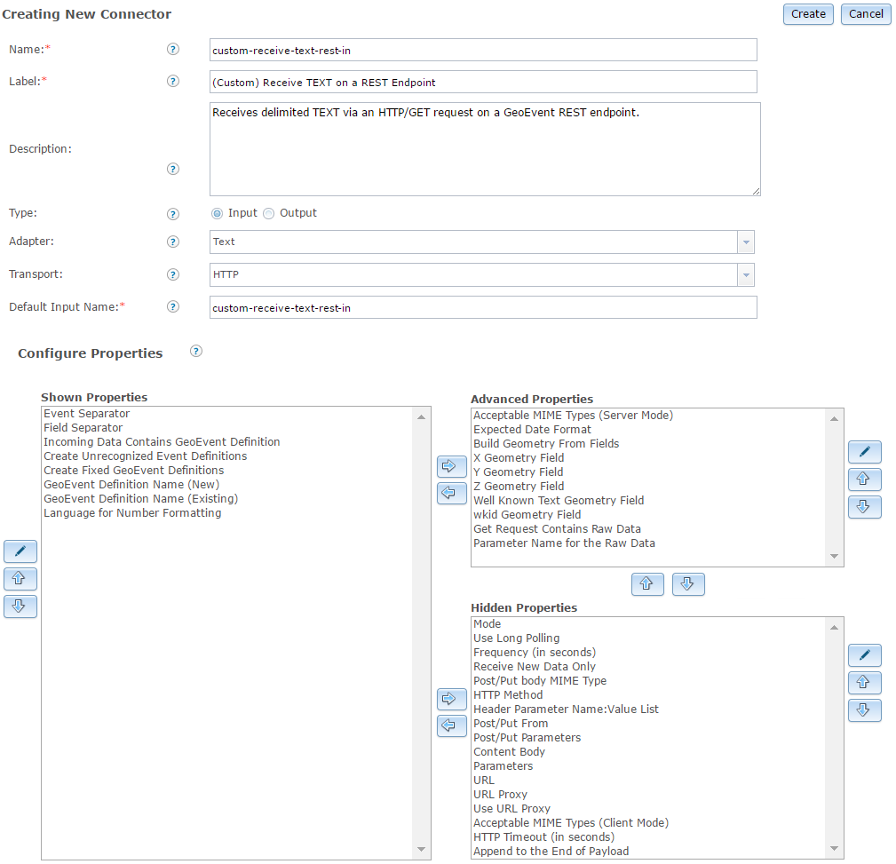

GeoEvent Server does not include a “Receive TEXT on a REST Endpoint” inbound connector out-of-the-box, so you will need to configure one for this exercise.
- Configure the following GeoEvent Server input connector.
Browse to Site > GeoEvent > Connectors and select to create a new inbound connector. Default values for the "Shown", "Advanced", and "Hidden" properties are included beneath the illustration.

- Save your newly configured custom inbound connector.

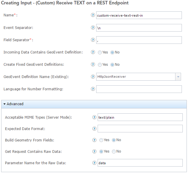

- Navigate to Services > Inputs and select to create a new (Custom) Receive TEXT on a REST Endpoint input.
Configure the input as illustrated below. Use the GeoEvent Definition you created for the last exercise.

- Send the following HTTP/GET request to your input connector’s endpoint (note the endpoint's name has changed):
http://yourServer.yourDomain:6180/geoevent/rest/receiver/custom-receive-text-rest-in?data=Robert,Lawrenson,123
You should observe the event count of your ‘(Custom) Receive TEXT on a REST Endpoint’ input increment as HTTP/GET requests are made on your input’s REST endpoint.
