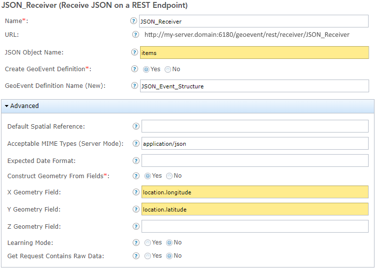

Re-configuring the data ingest
When I first mentioned configuring a Receive JSON on a REST Endpoint input to allow the illustrated block of JSON to be ingested into GeoEvent Server for processing, I indicated that the JSON Object Name property should be left unspecified. This was done to support a discussion of the data's structure.
If the illustrated JSON data were representative of data you wanted to ingest, you should specify an explicit value for the JSON Object Name parameter when configuring the GeoEvent Server input. In this case, you would specify "items" as the root node of the data structure.
Specifying "items" as the JSON Object Name tells the input to handle the data as an array of values and to ingest each item from the array as its own event record. If you make this change to our input, and delete the GeoEvent Definition it created the last time the JSON data was received, you will get a slightly different GeoEvent Definition generated as illustrated below:
.png)
The first thing you should notice, when the illustrated block of JSON data is sent to the input, is the input's event count increments by three -- indicating that three event records were received by GeoEvent Server. Looking at the new GeoEvent Definition, notice there is no attribute named "items" -- the elements in the array have been split out so that the event records could be ingested separately. Also notice the cardinality of each of the event record attributes is now One. There are no lists or arrays of multiple elements in the structure specified by this GeoEvent Definition. The "location" is still a Group which is fine; each event record should have (one) location and the coordinate values can legitimately be organized as children within a sub-structure.
The updates to the structure specified in the GeoEvent Definition change how the coordinate values are accessed. Now that the event records have been separated, you can access each record's attributes without specifying one of several element indices to select an element from a list.
You should now be ready to re-configure the input to construct a geometry as well as make some minor updates to the data types of each attribute in the GeoEvent Definition in order to handle "id" as a Long and "calibrated" as a Date. You also need to add a new field of type Geometry to the GeoEvent Definition to hold the geometry being constructed.
.png)
