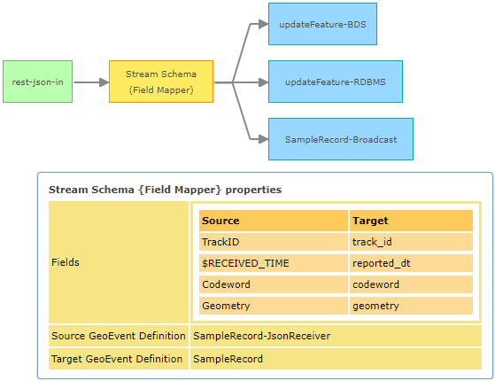

Following the best practice recommendation, a Field Mapper Processor should be used to explicitly map an event record structure and ensure that event records routed to a GeoEvent Server output match the schema expected by the service. The GeoEvent Service illustrated below can be used to successfully store feature records in my GIS Server's managed geodatabase. The same feature records can be stored in my ArcGIS Enterprise's spatiotemporal big data store with copies of the feature records broadcast by a stream service:

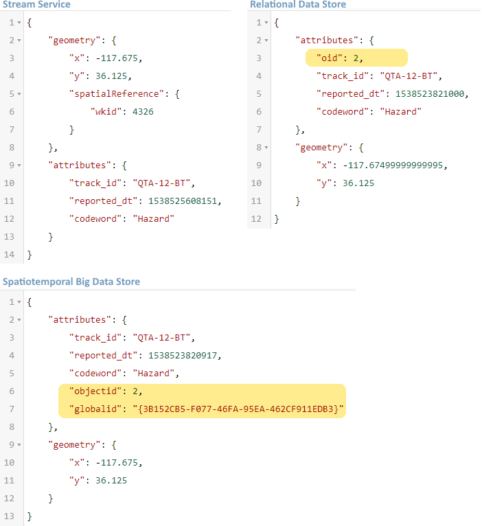

But if you compare the feature records broadcast by the stream service with feature records queried from the different feature services and data stores you should notice some subtle differences. The schema of the various feature records is not the same:
You might notice that the stream service's geometry is "complete". It has both the coordinate values for the point geometry and the geometry's spatial reference, but this is not what I want to highlight. The feature services also have the spatial reference, they just record it as part of the overall service's metadata rather than including the spatial reference as part of each feature record.
What I want to highlight are the attribute values in the relational data store's feature record and spatiotemporal big data store's feature record which are not in the stream service's feature record. These additional identifier values are created and maintained by the geodatabase and you cannot use GeoEvent Server to update them.

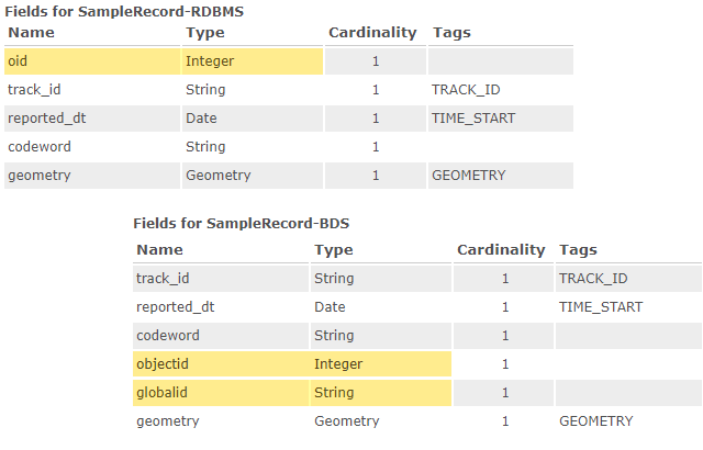

Recall that the SampleRecord GeoEvent Definition illustrated at the top of this article was successfully used to add and update feature records in the different data stores. If new GeoEvent Definitions were imported from each feature service, however, the imported event definitions would reflect the actual schema of their respective feature classes:
Since the highlighted attribute fields are created and maintained by the geodatabase and cannot be updated, the best practice recommendation is to delete them from the imported GeoEvent Definitions. Even if event records you ingest for processing happen to have string values you think appropriate to use as a globalid for a spatiotemporal feature record, altering the database's assigned identifier would be very bad.
But if I delete the fields from the imported GeoEvent Definitions ...
Exactly. The simplest way to convey the best practice recommendation to import a GeoEvent Definition from a feature service is to say that this ensures event records mapped to the imported event definition will exactly match the structure expected by the feature service. In service-oriented architecture (SOA) terminology this is "honoring the service's contract."
Maybe you did not know that the identifier fields could be safely deleted from the imported GeoEvent Definition, and so chose to keep them, but leave them unmapped when configuring your final Field Mapper Processor. The processor will assign null values to any unmapped attribute fields, and the feature service knows to ignore attempts to update the values that are created and maintained by the geodatabase, so there is really no harm in retaining the unneeded fields. But unless you want a Field Mapper Processor to place a null value in an attribute field, it is best not to leave attribute fields unmapped.
