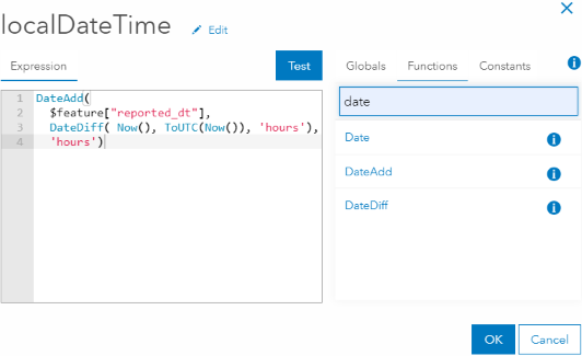

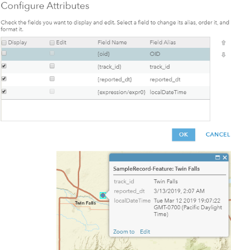

But there is a better way to handle this problem. Testing the latest public release (10.6.1) of the Enterprise portal web map and ArcGIS Online web map I found that pop-ups can be configured with custom expressions which dynamically calculate new values from existing feature record attributes. These new values can then be selected as the attributes to show in a web map's pop-up rather than the "raw" values from the feature service.
Below are the basic steps necessary to accomplish this:
- In your web map, from the Content tab, expand the feature layer's context menu and click Configure Pop-up.
- On the lower portion of the Configure Pop-up panel, beneath Attribute Expressions, click Add.
- Search the available functions for date functions and build an expression like the one illustrated below.
Assign the new custom attribute a descriptive name (e.g. localDateTime) and save the attribute calculation. You should now be able to select the dynamic attribute to display along with any other "raw" attributes from the feature layer.
