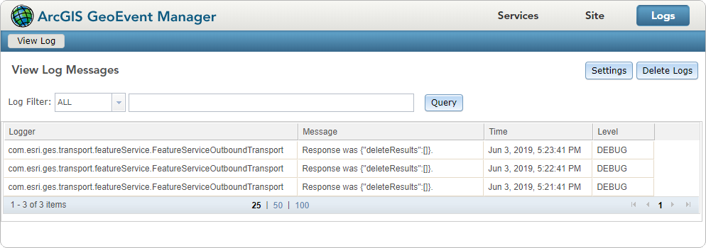

What is the outbound feature transport telling us?
The illustration above does not give us much information. It confirms that an Add a Feature output is periodically, once a minute, making requests on a feature service to delete old feature records and that, for the three intervals shown, no feature records were deleted (the JSON array in the response from the feature service is empty).
If one or more existing feature records had satisfied criteria included in the delete features request, then the logged messages would contain feature record identifiers to confirm which feature records had been deleted. Hypothetically, looking at the raw logged messages in the karaf.log file, we would expect to see a message similar to the following:
2019-06-03T16:42:41,474 | DEBUG | OutboundFeatureServiceCleanerThread-[Default][/][SampleRecord][0][FeatureServer] | FeatureServiceOutboundTransport | 91 - com.esri. ges.framework.transport.featureservice-transport - 10.7.0 | Response was {"deleteResults":[{"objectid":3, ... "success":true},{ "objectid":4, ... "success": true}]}. |
The outbound feature transport is only confirming what has been deleted, not criteria used to determine what should be deleted. The information we need, hopefully, is being logged by a different component logger.
