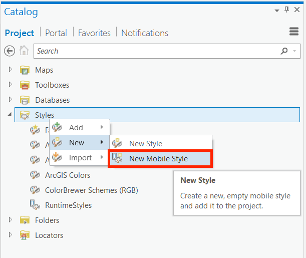

Step 1: Create a Mobile Style File in Pro
- Open Pro and create a new Project
- Open your Catalog Window and find the "Styles" section
- Right click Styles and select New > New Mobile Style.
- Give a name and location to create the style file.
- More details on the specs and limitations of a Mobile Style file can be found here.

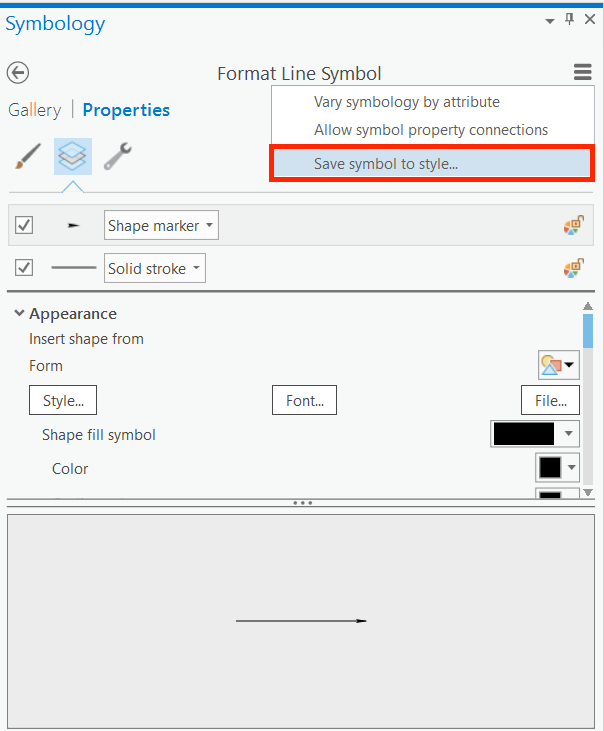

Step 2: Create and save a custom symbol into the Style File
- Insert a new map and add some vector data to your map
- Select the layer in the Contents pane, right click, and select Symbology
- This will open the Symbology pane and display the current symbol for the layer. You can modify this by changing color, size, and adding additional symbol layers. This allows you to make a completely customized symbol. Modify the symbol to your liking, and press Apply to see the symbol applied to the map.
- Once you have the desired output, click the "hamburger" icon in the top right of the Symbology pane and select Save Symbol to Style.
- Fill in the Name and Category and optionally give it a Key. This key will be used for fetching the Symbol in Runtime. (You could also query for all symbols and sort through the results programmatically, but retaining and fetching from a Key is the most straight forward way to get started)
- From the Style dropdown, select your newly created Style file.
- Click OK, and your symbol is now saved to your Style file and is ready for use in ArcGIS Runtime.
- More details about the process of creating symbol styles can be found here.

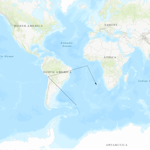

Step 3: Consume in Runtime
m_simpleRenderer <SPAN class="operator token">=</SPAN> <SPAN class="keyword token">new</SPAN> <SPAN class="token function">SimpleRenderer</SPAN><SPAN class="punctuation token">(</SPAN><SPAN class="keyword token">this</SPAN><SPAN class="punctuation token">)</SPAN><SPAN class="punctuation token">;</SPAN>
m_graphicsOverlay<SPAN class="operator token">-</SPAN><SPAN class="operator token">></SPAN><SPAN class="token function">setRenderer</SPAN><SPAN class="punctuation token">(</SPAN>m_simpleRenderer<SPAN class="punctuation token">)</SPAN><SPAN class="punctuation token">;</SPAN><SPAN class="line-numbers-rows"><SPAN></SPAN><SPAN></SPAN></SPAN>
- Create a SymbolStyle object by passing in the path to the constructor
m_symbolStyle <SPAN class="operator token">=</SPAN> <SPAN class="keyword token">new</SPAN> <SPAN class="token function">SymbolStyle</SPAN><SPAN class="punctuation token">(</SPAN><SPAN class="string token">"/Users/<username>/Desktop/RuntimeStyles.stylx"</SPAN><SPAN class="punctuation token">,</SPAN> <SPAN class="keyword token">this</SPAN><SPAN class="punctuation token">)</SPAN><SPAN class="punctuation token">;</SPAN><SPAN class="line-numbers-rows"><SPAN></SPAN></SPAN>
- Connect to the SymbolStyle::fetchSignalCompleted signal. This will emit when a symbol has been asynchronously fetched from the Style. A Symbol object is passed through as a parameter, and this symbol object can then be used to set the symbol used by the SimpleRenderer
<SPAN class="token function">connect</SPAN><SPAN class="punctuation token">(</SPAN>m_symbolStyle<SPAN class="punctuation token">,</SPAN> <SPAN class="operator token">&</SPAN>SymbolStyle<SPAN class="operator token">::</SPAN>fetchSymbolCompleted<SPAN class="punctuation token">,</SPAN> <SPAN class="keyword token">this</SPAN><SPAN class="punctuation token">,</SPAN> <SPAN class="punctuation token">[</SPAN><SPAN class="keyword token">this</SPAN><SPAN class="punctuation token">]</SPAN><SPAN class="punctuation token">(</SPAN>QUuid<SPAN class="punctuation token">,</SPAN> Symbol<SPAN class="operator token">*</SPAN> symbol<SPAN class="punctuation token">)</SPAN>
<SPAN class="punctuation token">{</SPAN>
m_simpleRenderer<SPAN class="operator token">-</SPAN><SPAN class="operator token">></SPAN><SPAN class="token function">setSymbol</SPAN><SPAN class="punctuation token">(</SPAN>symbol<SPAN class="punctuation token">)</SPAN><SPAN class="punctuation token">;</SPAN>
<SPAN class="punctuation token">}</SPAN><SPAN class="punctuation token">)</SPAN><SPAN class="punctuation token">;</SPAN><SPAN class="line-numbers-rows"><SPAN></SPAN><SPAN></SPAN><SPAN></SPAN><SPAN></SPAN></SPAN>
An example ArcGIS Runtime project can be found here. You will need to update the path to your style file and any keywords that you may be searching for.
