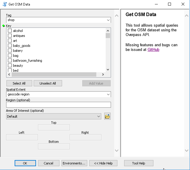

The Inputs of OSMQuery
OSMQuery takes only a simple set of inputs at the moment:
- a tag like "building", "shop" or "amenity"
- a key like "farm", "bakery" or "place_of_worship"
- an area which will be used as a "related" feature
- or a bounding box / spatial extent
The tool uses the name of the region and gets an area ID from the Nominatim Geocoder. This area ID or the bounding box of the spatial extent will be used to create a query for the Overpass API.

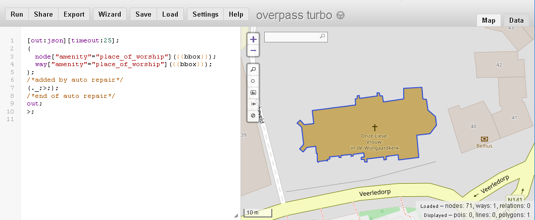

The processing logic is splitted in two parts. First I needed to determine whether points, line and/or polygon feature classes will be needed to store the features. This is a bit tricky as polygons are also "ways" in terms of OpenStreetMap logic. The response of a way not only contains the tags of a way but also the id's of nodes defining the way geometry. A polygon can be created if the first nodeID in the list of nodes is also the last nodeID for the way:
As you can see, the result way has 71 nodes and the response looks like this:

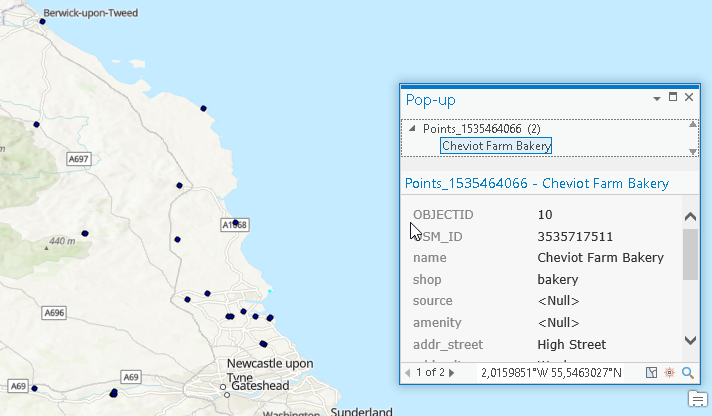

But in the end: There are 33 bakeries in Northumberland, UK according to the OpenStreetMap dataset:

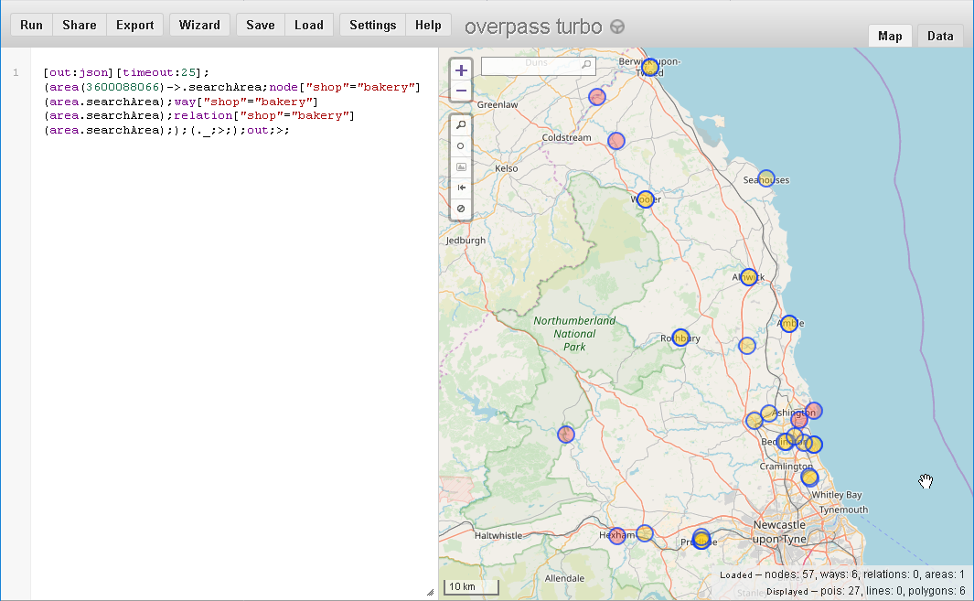

Here is the compared dataset in the Overpass API:
