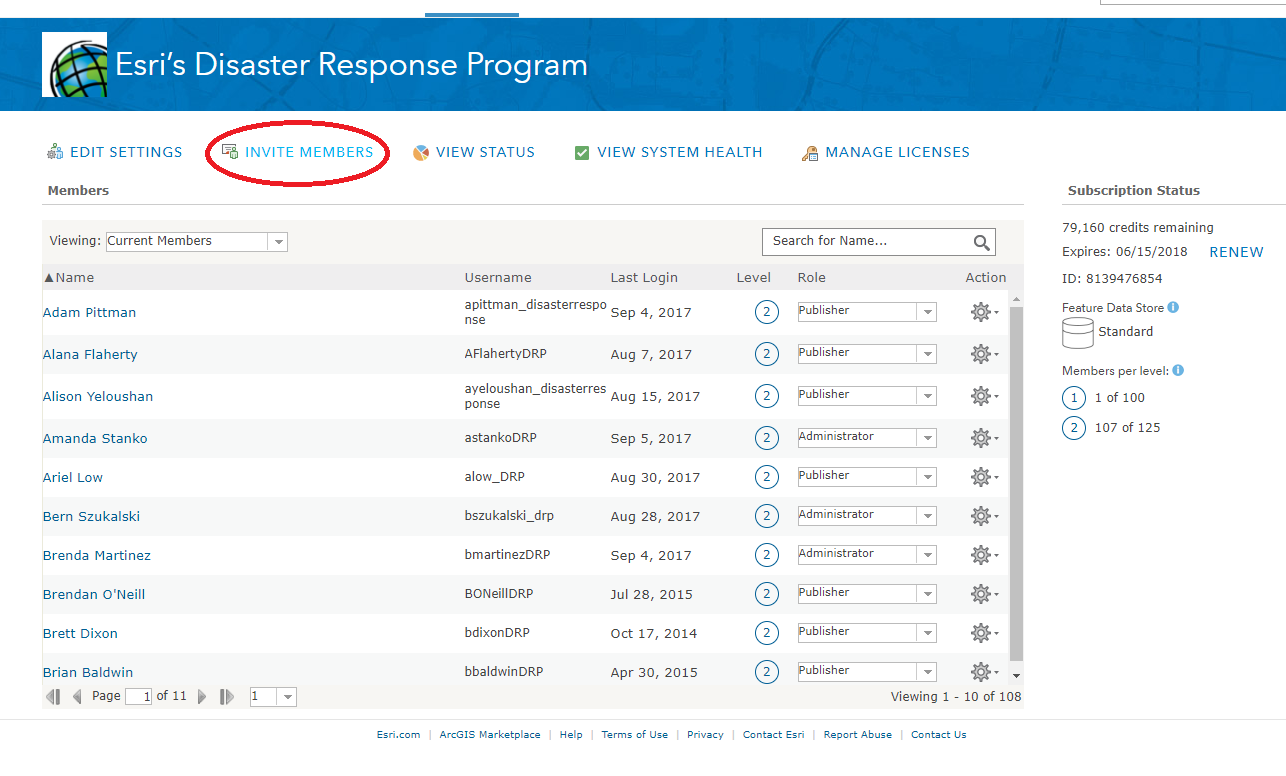

2. Invite Members
With Administrator privileges, the "Organization" tab at the top will give you the dialog to "Invite Members."

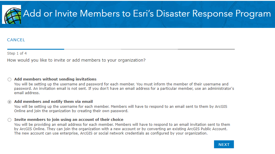

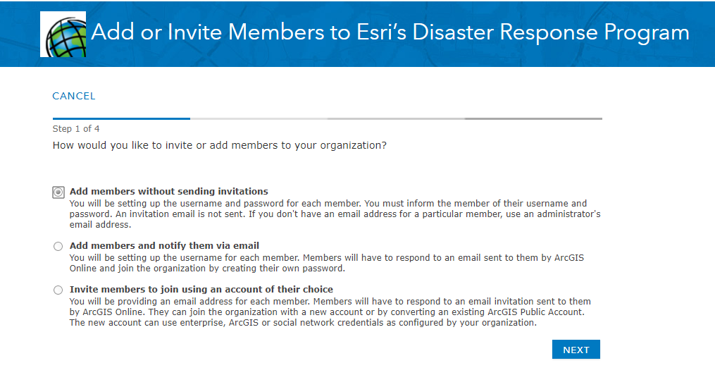

3. Add members without sending invitation
While there are many options for inviting new users, this workflow grants user permissions without sending an email. This saves a few steps for the field users so they won't need to verify and accept their invitation. If you've enabled enterprise logins in your ArcGIS Online/Enterprise Organization, you'll have an additional option in this list.

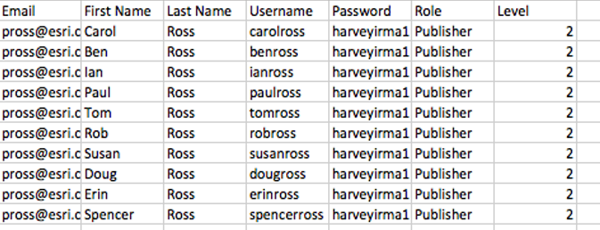

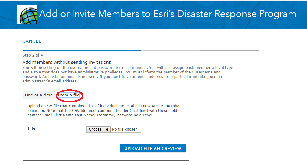

4. Enter Users "One at a time" or "From a File"
A great new capability that saves time for the administrator is to add users in a bulk upload of a CSV file that contain Email, First Name, Last Name, Username, Password, Level and Role. Field Users will be required to reset their Password at first login, so pick something easy to remember and communicate. Your Field Users will need a Level 2 license in order to edit data in the field, and the default role should be set as User. If you have Custom Roles established, ensure that they are Level 2 and have edit privileges enabled.
The CSV will look like this:
The Field User will reset their Password as soon as they log in, so it's best to use simple and easily-communicated Passwords.

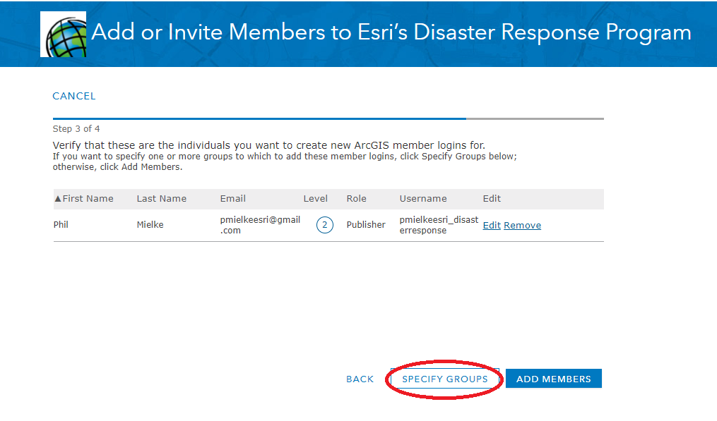

5. Specify Groups and Add Members
Specify groups that contain the web maps and features for field collection to ensure that field users will have web maps to open and begin their work as soon as they can.

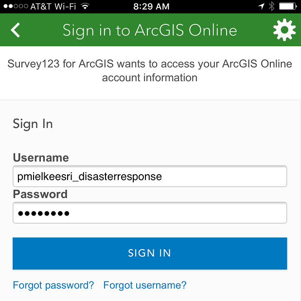

2. Sign in on a Mobile App
Using the username and Password that were given to you by your Administrator, sign in to your mobile application (Survey123, Collector or Explorer) and sign in for the first time.

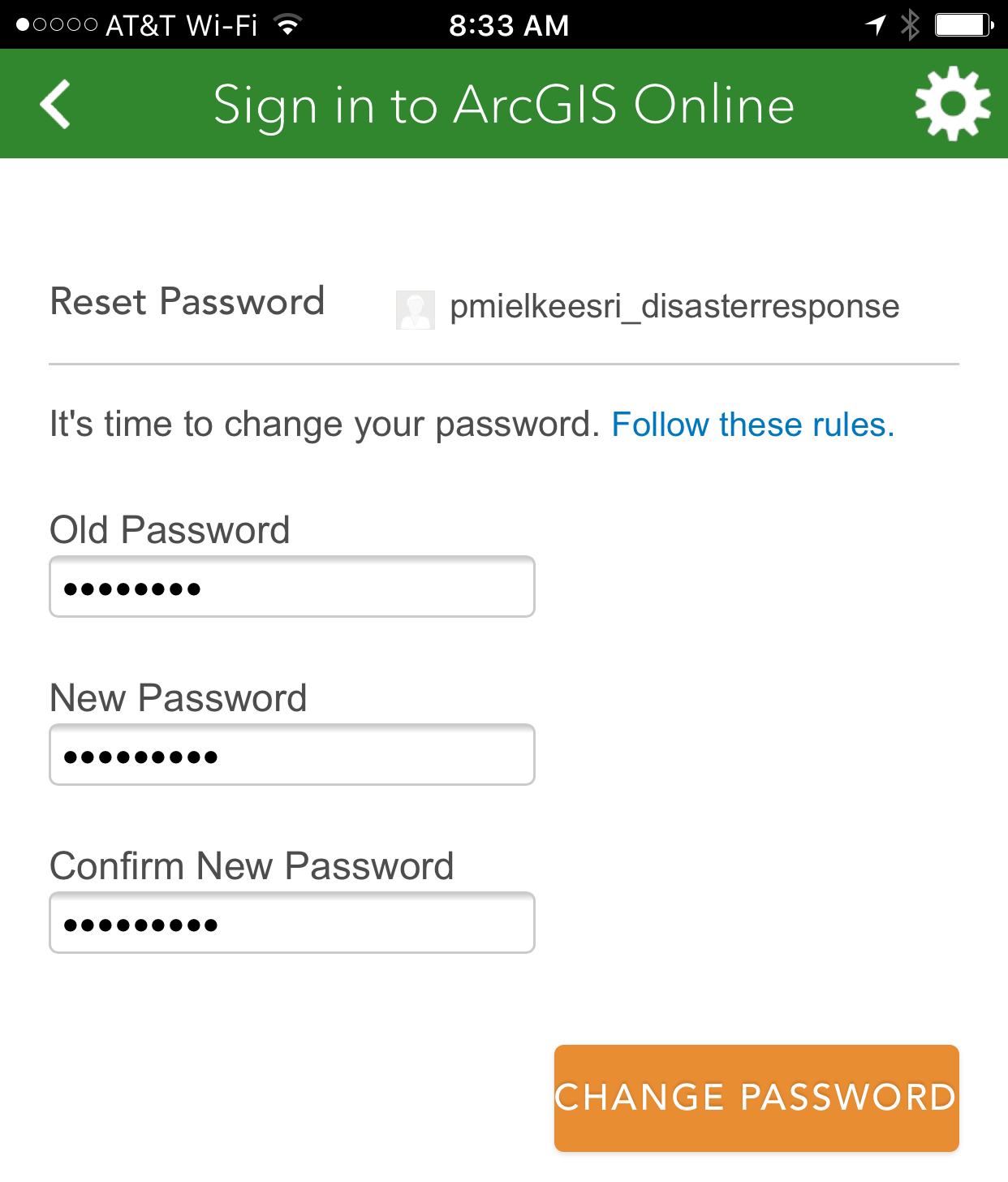

3. Reset your Password
You'll be asked to reset your Password at your first login. Remember this Password, as you would need to contact the Administrator for a Password reset.

2. Invite Members
3. Add members and notify them via email
This workflow grants user permissions and verifies user identity via email. If you've enabled enterprise logins in your ArcGIS Online/Enterprise Organization, you'll have an additional option in this list.
A great new capability that saves time for the administrator is to add users in a bulk upload of a CSV file that contain Email, First Name, Last Name, Username, Level and Role. Field Users will be required to reset their Password at first login, so pick something easy to remember and communicate. Your Field Users will need a Level 2 User or Publisher Role in order to edit data in the field. If you have Custom Roles established, ensure that they are Level 2 and have edit privileges.
The Field User will reset their Password and set security questions as soon as they verify their identity by clicking the link that ArcGIS emails them.

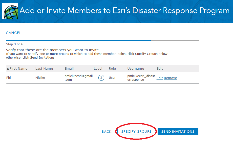

5. Specify Groups and Send Invitation

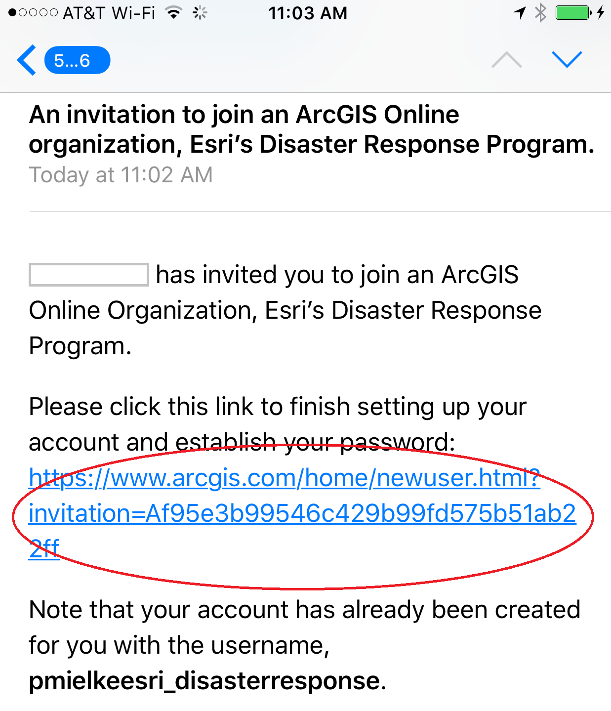

When you click "Send Invitation", the Field Users will be emailed a link that will activate the Username, Request a Password Change and set a Security Question. Field Users will be unable to log in with their mobile devices without completing this step.

2. Click Link emailed to you from "ArcGIS Notifications" (notifications@arcgis.com)

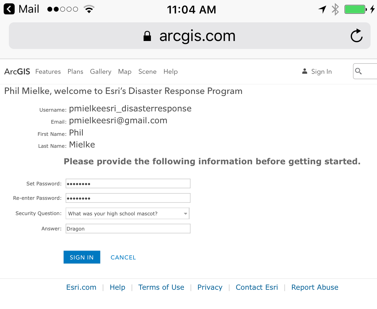

3. Set your Password and Security Question
The link will take you to a browser to enter your Password and set a security question. Enter this information and click 'Sign in'. You'll be directed to your profile information, but you are not required to edit information.
