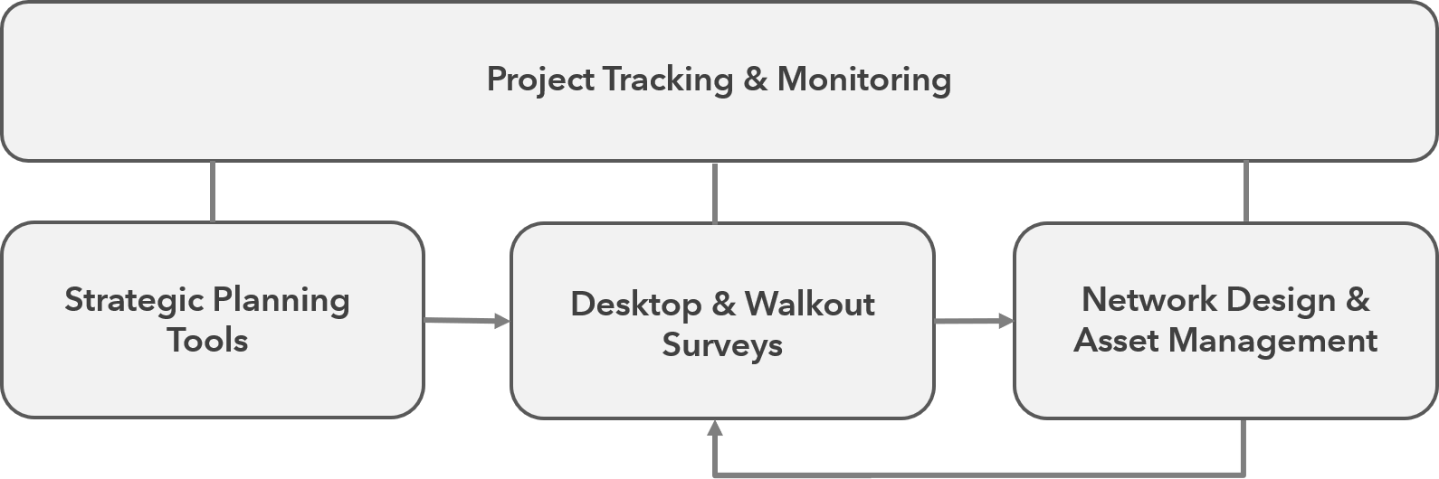

To support 5G and fiber deployments, Esri and its Partner's solutions can be categorized into 4 main business offerings; Strategic Planning Tools, Desktop & Walkout Surveys, Network Design & Asset Management, and Project Tracking & Monitoring.

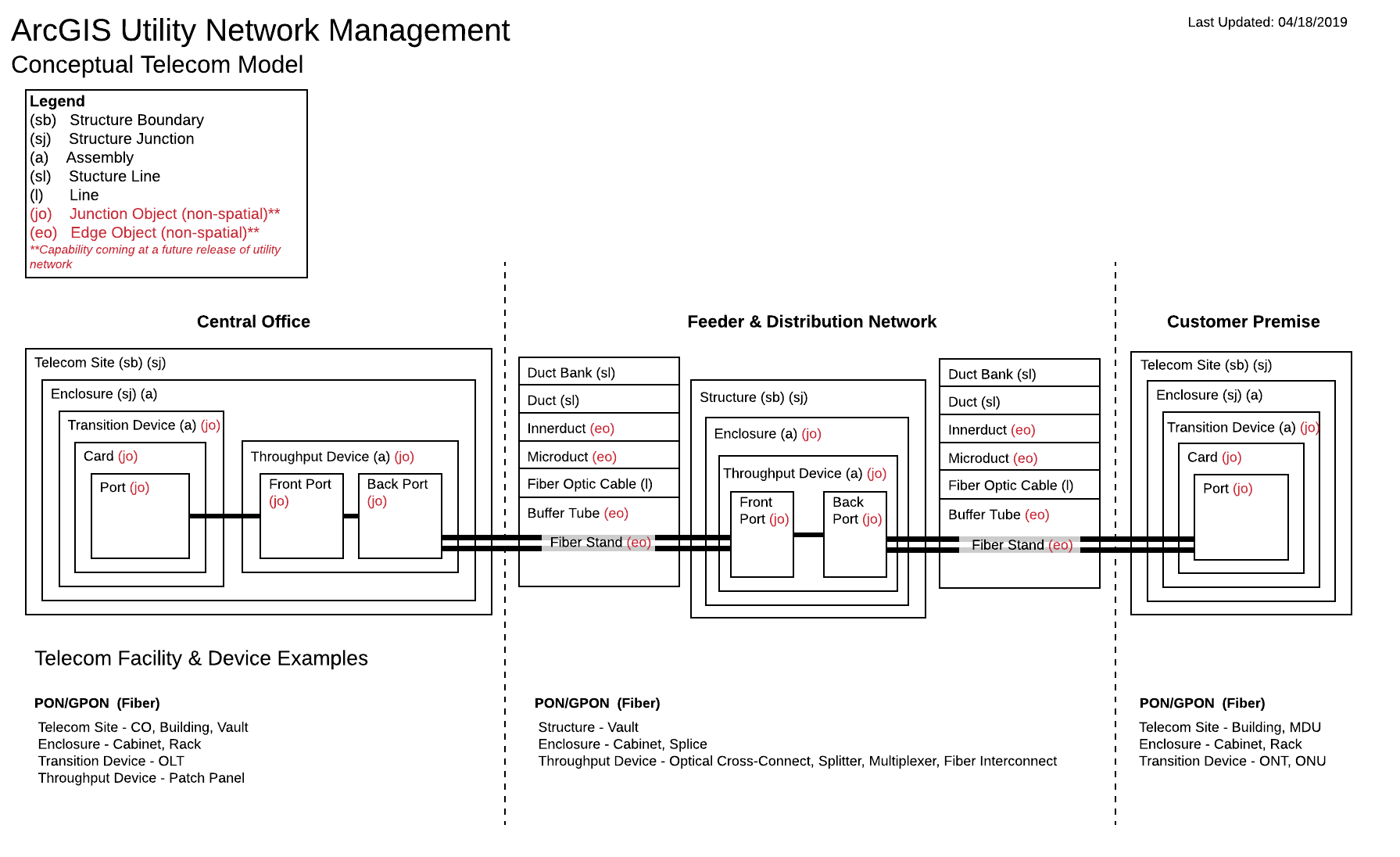

The utility network at the ArcGIS Enterprise 10.7.1 and ArcGIS Pro 2.4 release supports associations, containment, and connectivity of features with a spatial geometry. This means assets with a physical geometry (drawn on the map) can be managed and maintained within the utility network at its current release. At a future release of the utility network, a new set of asset classes called Object Classes (edge & junction) will be introduced into the utility network to support management of non-spatial features. This will allow for associations and connectivity of features maintained in the utility network without requiring a physical geometry (not-drawn on the map). The diagram below shows a high-level conceptual view of the main fiber assets aligned to the utility network tiers and asset classes of the utility network. This includes physical assets that could be managed today (simple network management) by building your own asset package data model on the utility network, and non-spatial assets that could be managed at a later release of the utility network (advanced network management), or managed today through Partner solutions and the older Geometric Network framework.
As you can see in the diagram above, the physical location and attributes for telecom sites, structures, equipment, span, and cables can be managed in the utility network today. This would provide simple network management and allows for containment on these features. To support many of the non-spatial assets in a fiber network, like fiber strand and ports, and to run connectivity traces, the Object Classes (non-spatial tables) will be essential additions to the utility network set of asset classes providing advanced network management.

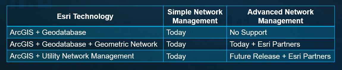

For those looking to leverage ArcGIS for network design & asset management here are the options today and in the future:
For simple network management today, ArcGIS with either a geodatabase, a geodatabase + Geometric Network, or ArcGIS + Utility Network Management extension is required to store asset locations and attribution about those assets. Simple network management will enable a base set of capabilities and workflows for your organization. For advanced network management today, ArcGIS with a geodatabase + Geometric Network is required, and typically an Esri Partner solution built on top. At a future release of the utility network, ArcGIS + Utility Network Management will bring advanced network management capabilities to the table for users and Partners to build solutions around. Also, keep in mind that Esri Partners and the user community are key to extending both simple and advanced network management capabilities offered by ArcGIS in order to build complete network management solutions for your organization.

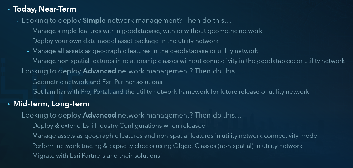

Here is some additional guidance depending on if you are looking to deploy simple or advanced network management:
