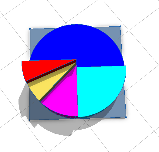

From my half circle project I found out that you could rotate the scope after the half circle split but before the "quarter circle" split to produce any obtuse angle.
halfCircle-->
rotateScope(0,-35,0)
split(x){'.5: quarterCircleA|'.5: quarterCircleB}<SPAN class="line-numbers-rows"><SPAN></SPAN><SPAN></SPAN><SPAN></SPAN></SPAN>
I thought that might be the key to unlocking the next step, an N-Sided Polygon.

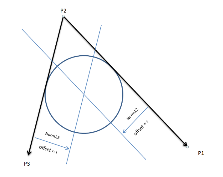

As for dividing up the shape to set up the angle splits, intuitively I know it involves radius offset (shown by image below). And then finding where the circle touches the sides to calculate a angle and applying that back to the angled circle for a cut (including rotation, translation, scope).
Image: Stackoverflow - user "dbc"

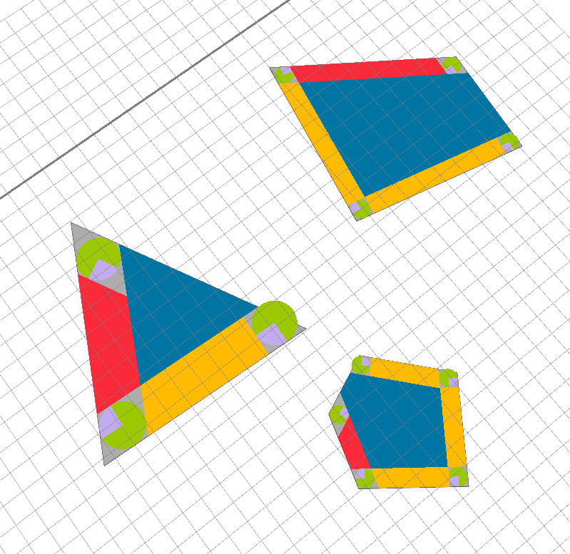

I dove into the CGA recursive coding techniques and finally started to grasp some of the CGA reference. After some trial and error I was able to produce this:
The red is the starting point for the first shape edge offset, which you have to treat differently than the recursive shapes. This is because it will create two corners (the one at "0" starting). The yellow sides are the offsets produced by recursive scope pivots. The grey is the yellow with a radius/remainder split. Green circles are inserted into the resulting shapes. And the light purple is the quarter circle split with no scopeRotation, translation, or rotation applied yet. I need to figure out how to get the angles and parameter them. Notice I didn't include a concave polygon. I think that would require a case/else and maybe a geometryIsConcave test. Also, the final rotation isn't quite working as the final shapes scope goes beyond the original shape. Maybe this could be useful itself - for placing something on the inside space of each corner, like a patch of trees?
